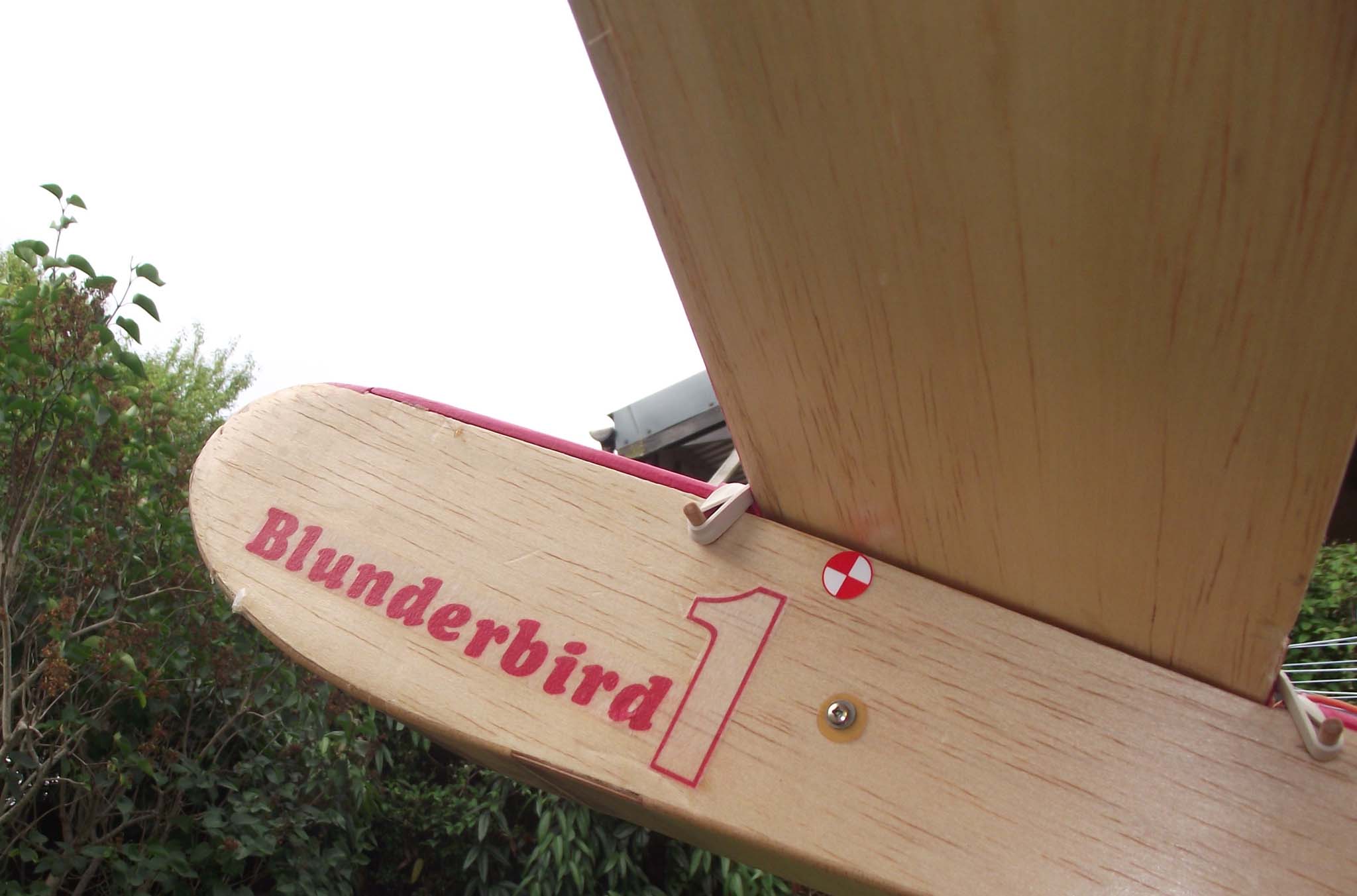

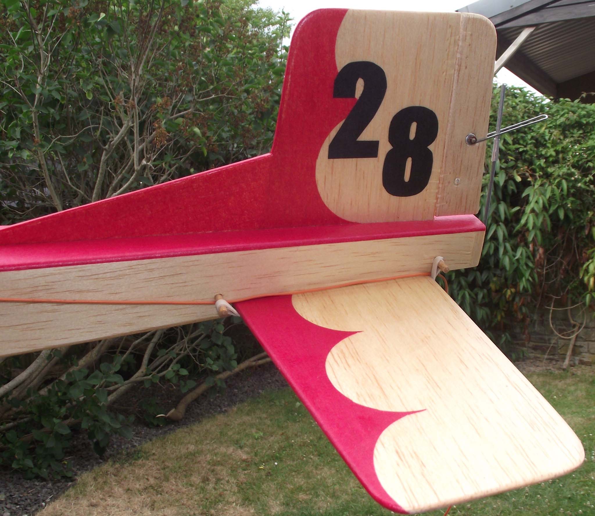

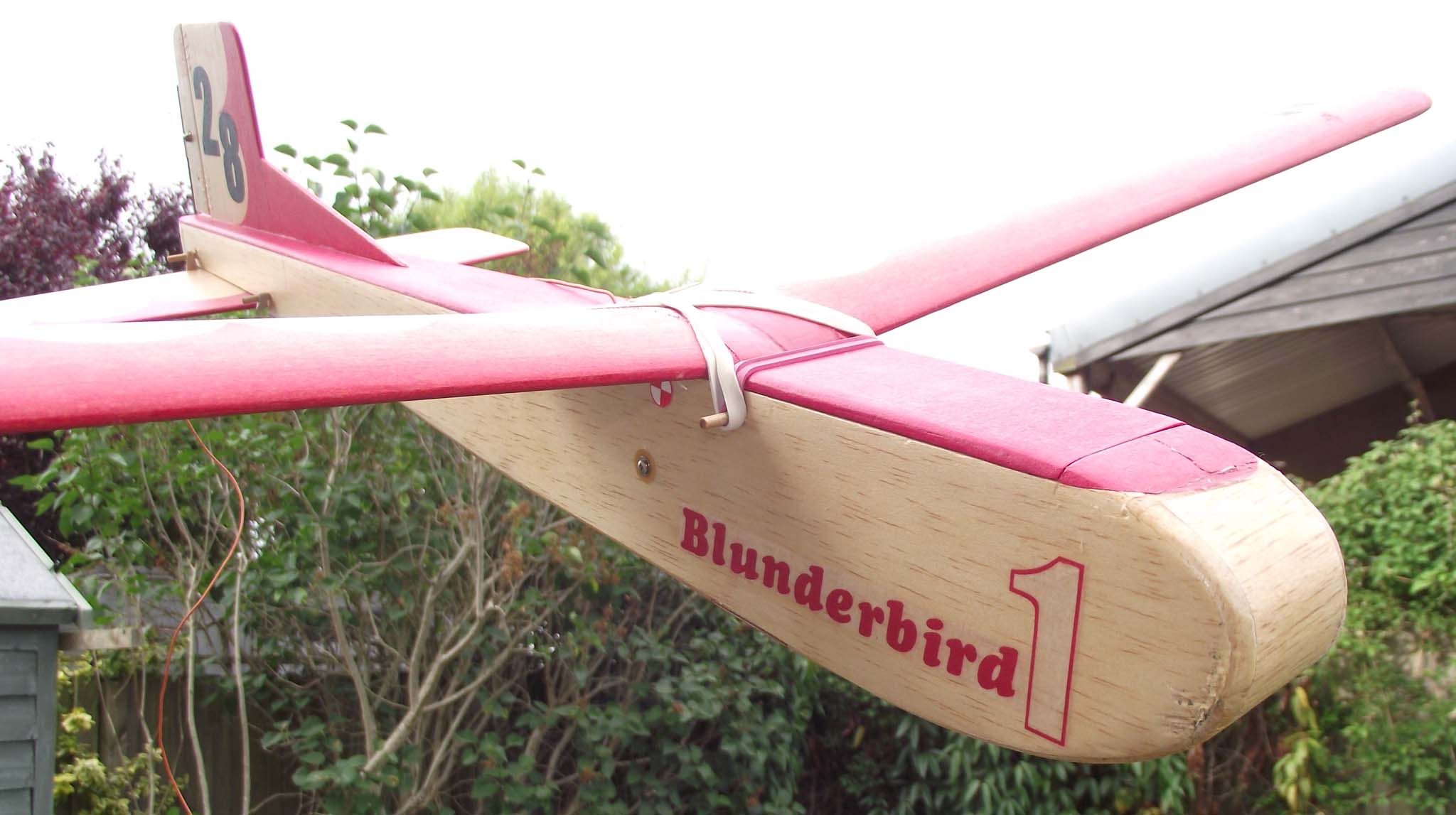

I've done a few jobs on it. One that's not visible is to glue in 1/16" ply doublers and bottom to the inside or the nose area. There were no doublers, so thought it a good idea. So the 35Mhz receiver and 4 AA cell battery pack are up front - I chose the biggest receiver and used AA cells simply for weight to balance the model - just 3 additional two pence coins gave the correct balance.
The other jobs are shown in the pictures:

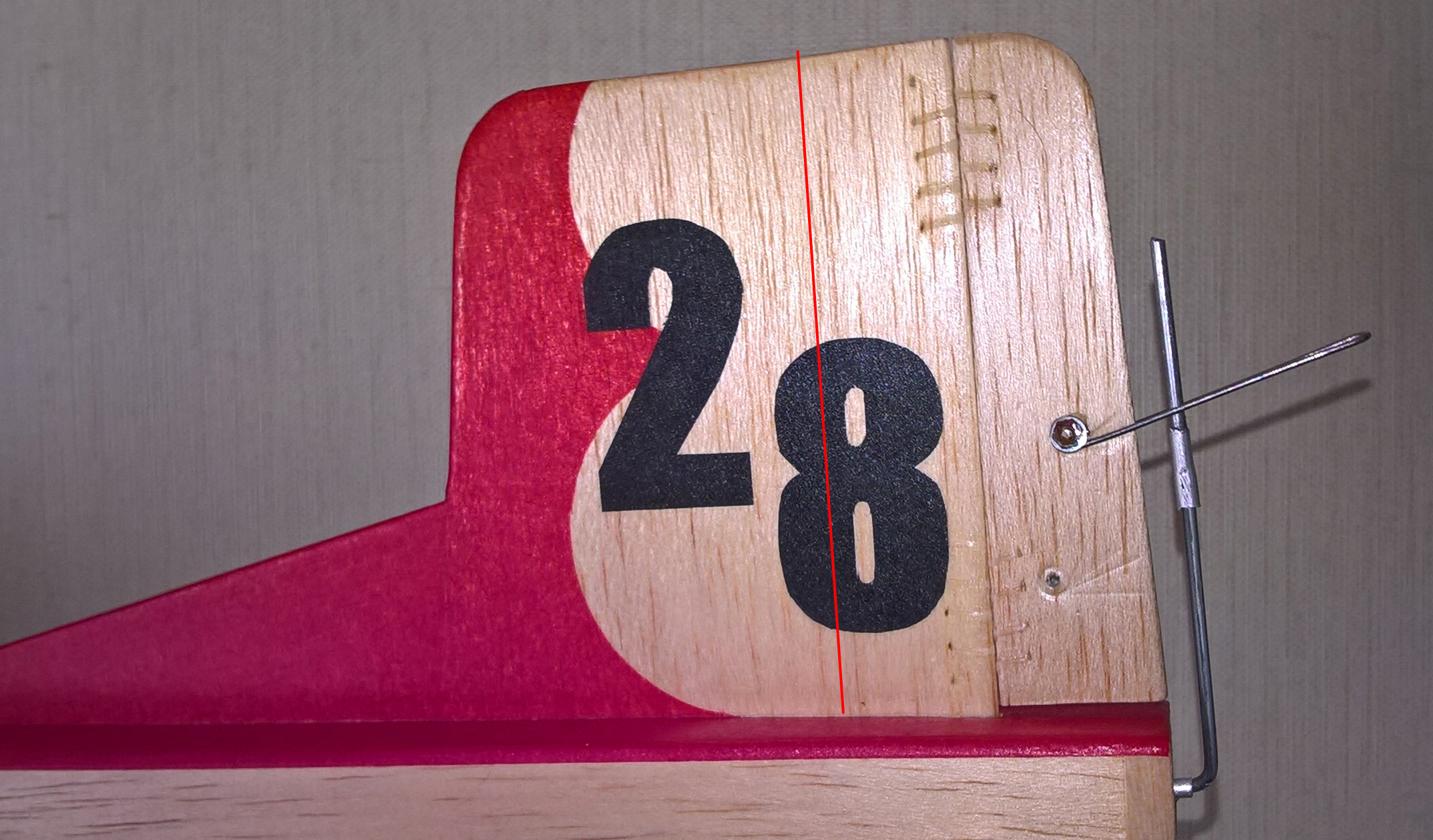

I've PM'd this to Phil but it looks as though it doesn't allow jpg attachments. In the previous post I said I will be enlarging the rudder. The picture below shows a red line where I'm proposing to cut the fin to create the larger rudder - it effectively doubles the rudder size.
Does this look like a good place? Bigger still or not so big?

So I've enlarged the rudder on the Blunderbird - gone half way between what I previously suggested and the original hinge point. Here's a link to a video clip of the rudder movement showing quite a lot of throw. Being a beginner I'm quite happy to receive an opinion. I could reduce using rates or move the wire loop on the rudder back down to the original position. The servo is a little buzzy but works perfectly well.

At least on your video, the torque rod looks in danger of popping out of the yoke when hard over, or do my eyes deceive me?
- Carl
- Posts: 267
- Joined: 16 Feb 2018, 13:26
Re: Blunderbird 1
It is close, but I'm going to move the yoke back down to the original position anyway for the time being whilst gaining experience.pulserudder wrote: ↑14 Jul 2018, 20:42 At least on your video, the torque rod looks in danger of popping out of the yoke when hard over, or do my eyes deceive me?
