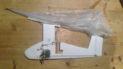

This another one
It's several years old
Great for car / holidays as completely flat
The rx is a FL toys brick - has the advantage that I can use it with the (tiny) FL toys tx or with Radiomaster multimodule - which also allows me to fly as s/c bang bang. Proportional makes very little difference!
Fuz is 2mm depron and shape makes little difference - I have a bigger one where everything is (very) rectangular. That one slightly bigger but with a brushless outrunner
Fuz is so thin that any servo movement bends the fuz as much as moving the rudder...
Brick has 2 x servos but elevator servo unused
Lipo is 1S and most sizes work
Motor is a geared thing from an old Silverlit toy - ESC part of the brick
Rogallos work well as very stable in pitch / throttle to go up and down
Very slow flier
