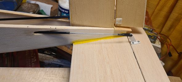

Had issues cutting hingr slots in 3mm balsa for the fin and rudder, ended up laminating to 3.5mm with hing pockets cut into the inner 0.5mm lamination.
With all the hinges fitted and a basic sanded finish on the tail surfaces, they are glued together ready for assemblt to the fuselage.

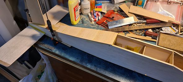

Tail fitted, glued and squared to the fuse, now ready for the servos.
I don't have any inbetween servos, so I have to go with a set of new standards for rudder and elevator, throttle servo will be a good mini.
Pushrods and top clading are in the next post.

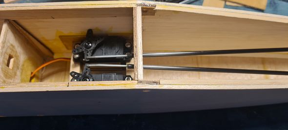

The pushrods could not have come out better, 4mm carbon fibre tube and a couple of Dubro 2/56 rods, Zed bends at the servos and quick links the other ends, and the pushrods are straight, no bends or kinks from the servos to the control horns.
Everything is going together perfectly, and a neat setup too.
The elevator exit is free and none binding at full deflection up and down, I have also wet the balsa around the exit with thin CA to strengthen the edges of the exit hole, and will do the same for the rudder exit too. The rudder hits the elevator at full up, so I will take 3 or 4mm off the bottom rear of the rudder, the rudder is about 4mm lower at the bottom because of an earlier mistake I made, so releaving the bottom of the rudder will bring it back close to the orignal size.
There is almost no play in the drive from the servo arm to the control horn, and what there is you can't see.
The rudder has a little over 45 degrees throw each way, better to much than not enough, end points and expo will adjust to whats needed.

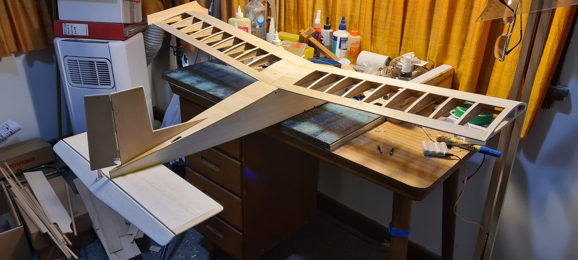

Wings are built, I went with a different construction method than the original plan build, an open frame with just the upper D-box sheeted and ply dihedral braces....
Hollowed out the tips as well.
The Coachman is starting to look like an aeroplane.

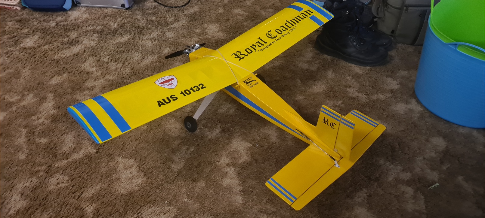

I finally finished the Coachman, one solid colour, yellow and a little blue trim with custom decals
Hope to maiden this Sunday.

Very smart!....... How did you do the lettering on the wing?

PaulJ wrote: 21 Jan 2022, 08:56 Very smart!....... How did you do the lettering on the wing?
Paul,
I created the "Royal Coachman" in Word, found a font I thought would fit the name of the model, then took the file to a company that makes signs for the labeling of commercial vans, trucks and the like, they used a CNC vinyl cutter, told them how big and where you want the component's of the decal to be positioned (the designed by Don section).
The fine ends on the letters can be a little cantankerous, but it took me about 10 minutes to peel the backing off with the help of a #11 blade and 1 minute to apply the sticker. My MAAA/FAI number is made the same and complies with size regs, the club badge is from my club, you get a new batch every year when you pay your fees.
