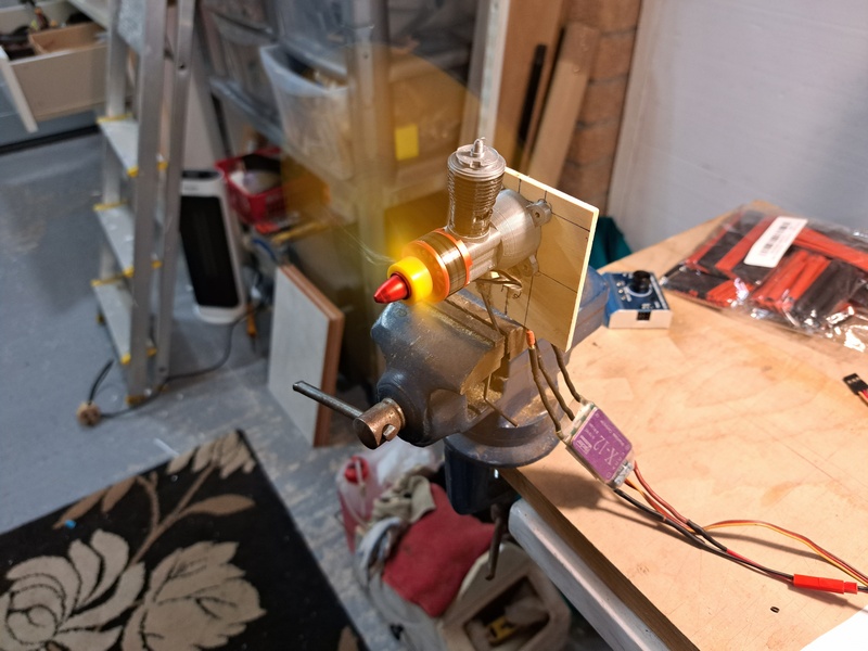

This is the printed Cox Babe Bee on the test bench. It uses an 1806 motor and is fitted with a 7x3 prop and a 2 cell lipo.
I intend to use this setup on the Santa Maria.

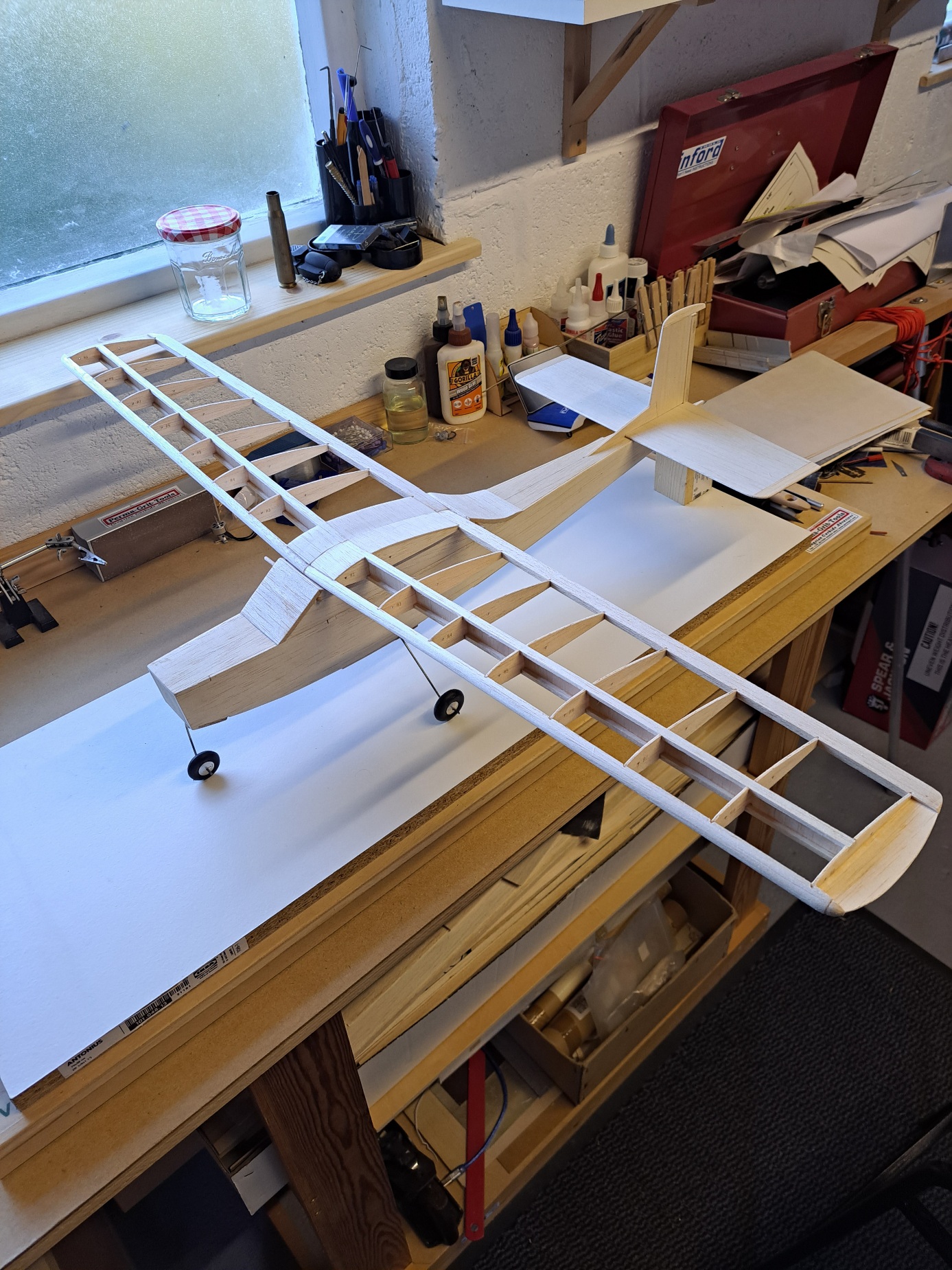

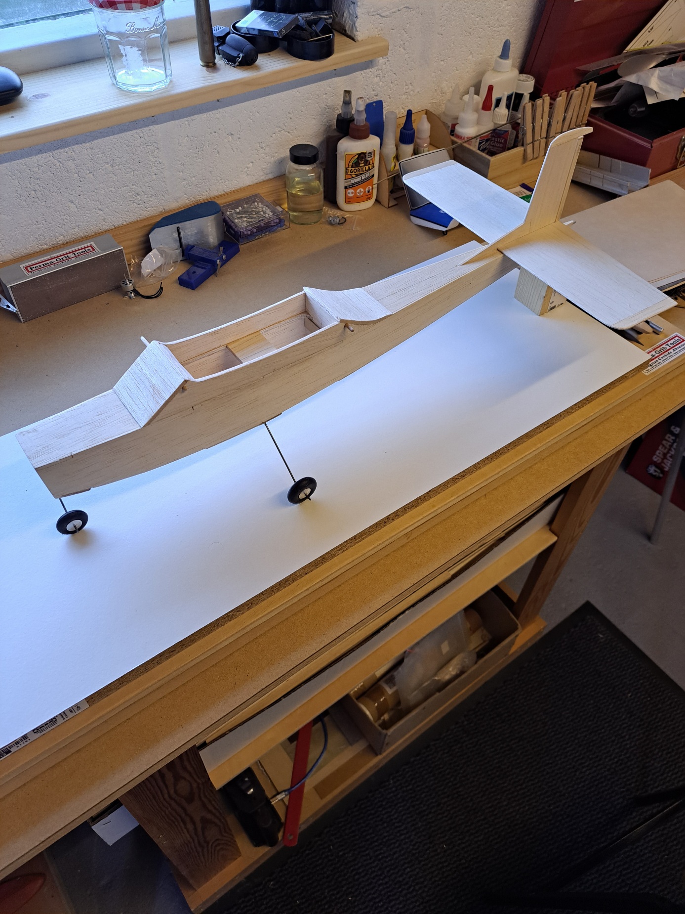

Dick's Dream progress so far. Loosely tacked together for the obligatory '80% done, 80% still to do' photo. Need to contrive a method of fitting the Tobe actuator and finish off sheeting underneath.
Battery bay is underneath the nose. Oops, need to finish the wing tips too..
