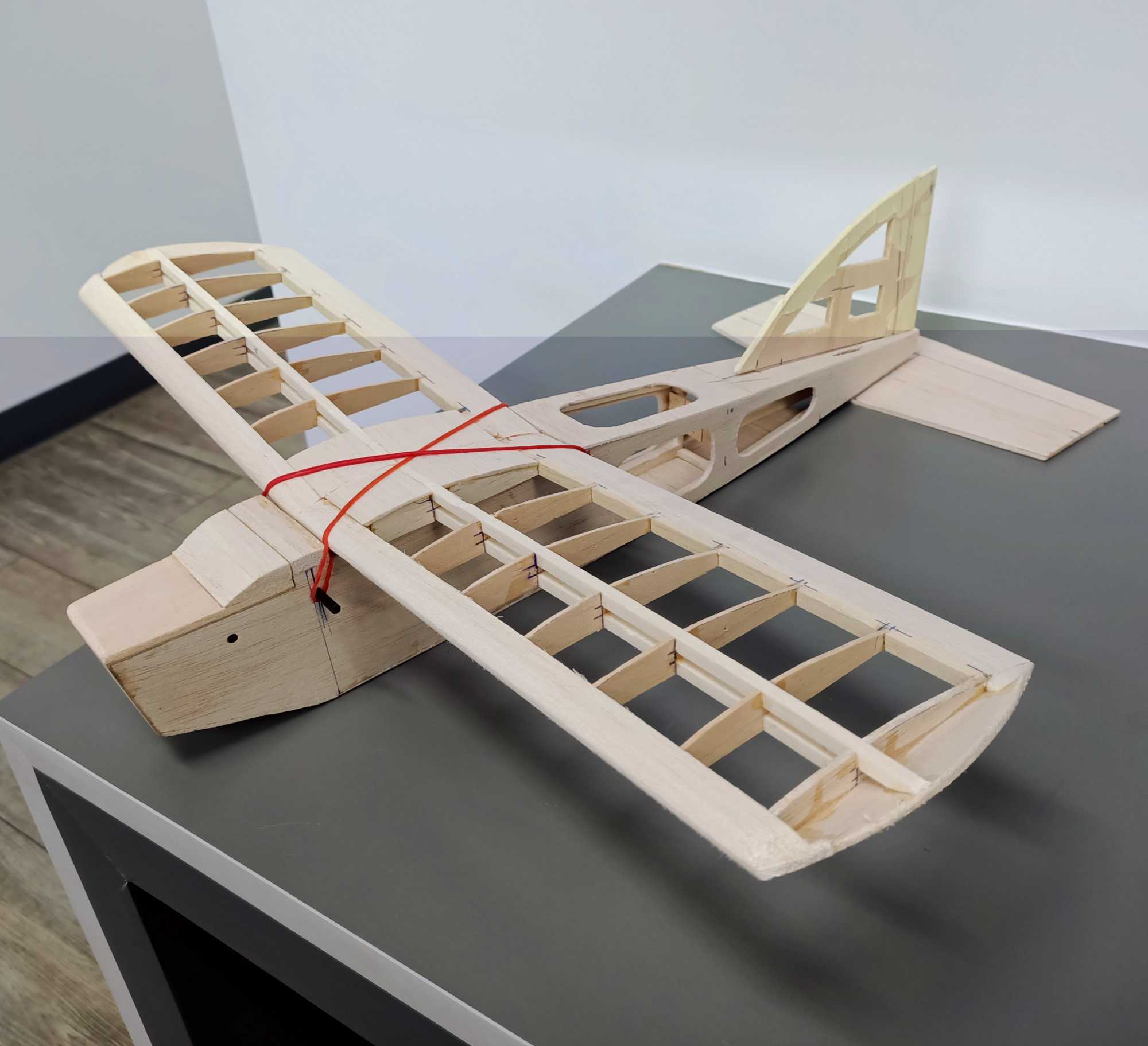

I have recently completed building the Shark Face model airframe. I like to seek advise or opinion to go forward with the build.
1) What size of brushless motor is suitable for this model
2) Is Sharkface suitable for beginner flying Single Channel?
I was advise by some local old timer that I need a bigger span model
Thank you
Thank you

Hi, I definitely would not recommend the Sharkface for a beginner to single channel. The model flies really well, but it is very fast. You will need a slower flying model to start with.
There are a couple of user comments on Outerzone giving details of electric setups for the Sharkface, take a look.
I am using the following setup on a similar model which I think would work well in the Sharkface :
Motor - Turnigy Aerodrive v2 2822/14 1450kV
Prop - APC E 7x4
Battery - 3S 11.1v (850mAh or larger)
This setup produces about 100W which should be fine.
I use a 12A ESC, but I think a 20A would be safer.
Hope that helps, Barry

I use a turnigy 2204 50watt and a 2s lipo and 10amp ESC, hope that this helps.
On my second build, I extended the nose by 20mm to avoid having to place lead up front to get the C of G in the correct position.

Thank you both for your reply. Since I have a 2822 brushless motor, I will use it on my Shark face
Also I have also decided to use conventional radio for guidance until I have build up experience to convert it back to Single Channel operation.
