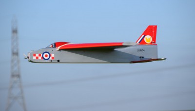

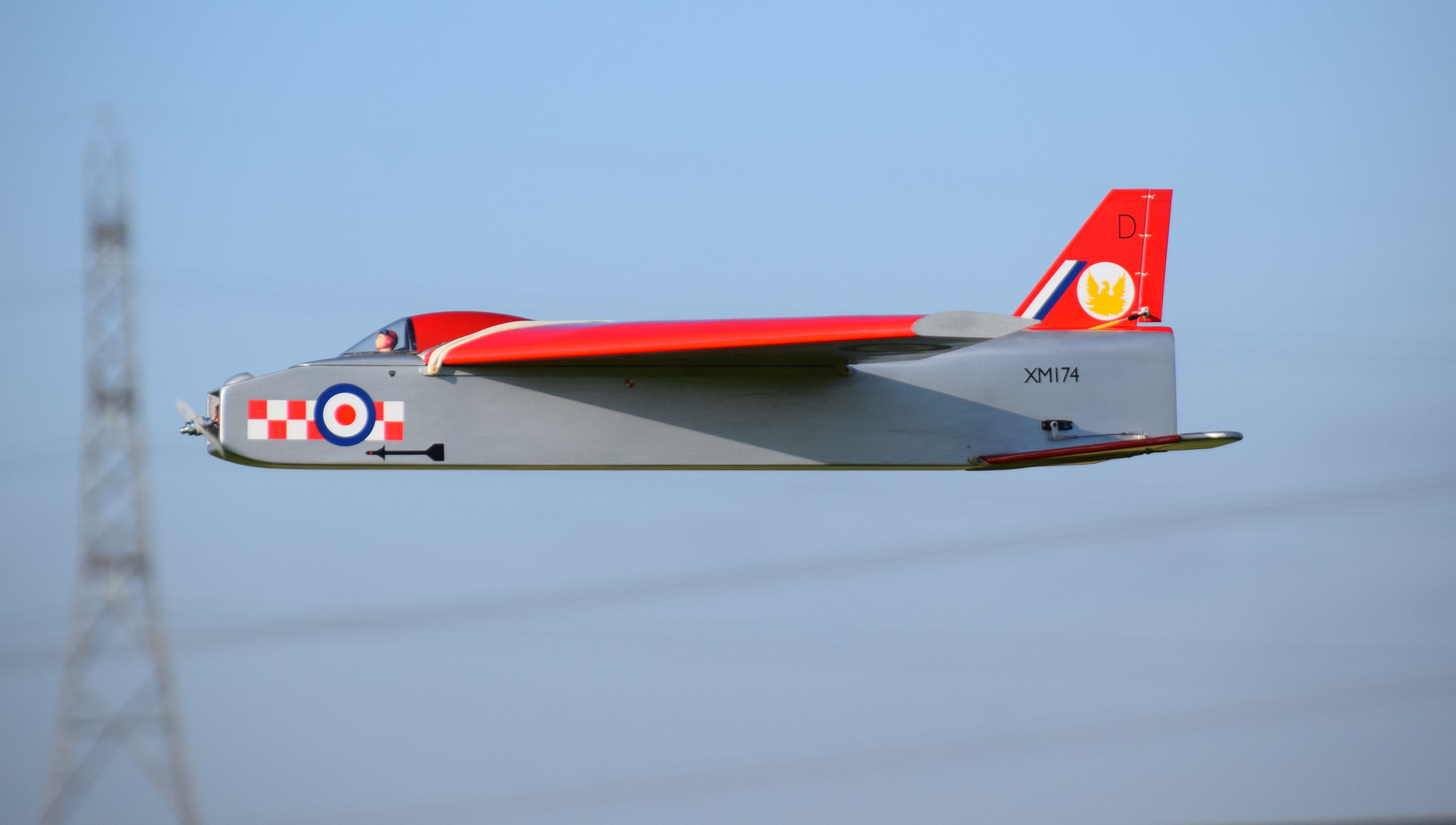

Test flew the Lightning today with Phil on the camera. A superb plane to fly and will go worryingly slow. I really expected it stall and fall out of the sky but it doesn't. It will also climb almost vertical with a w.o.t. (but there again just over 2lbs with 500w its not a surprise)
It has brilliant manners and would make a great trainer. Rudder banks it over, release and it stays there going round and round like a control liner until a dab of opposite straightens it up. I modified mine with tailerons (opens up the flight envelope but you really don't need them); rudder only rolls etc are easy.

The Lightning looks really superb, the red fin and wing against the blue sky really set it off. And I love how you've painted the redtop missile on the side.

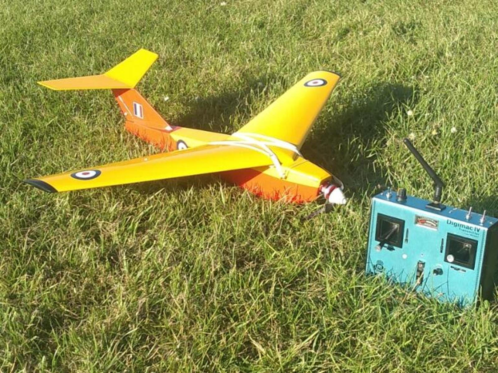

At Last, Go-Jet maidened! As our field is blessed with a strip of long grass I carried out a few hand launches first and as the GJ showed little urge to do anything other than dive straight in I added 1/8" packing under the l/e of the wing before getting a trusty model thrower to sling said model skywards.
Need not have worried because it went off nice and straight. Probably the easiest ever single channel model maiden I have ever had.
Whizzed round the sky and ended up with some nice big jet loops and rolls to finish with.
Well chuffed with this one.
p.s Sorry about the colour my phone camera doesn't render bright red at all well
