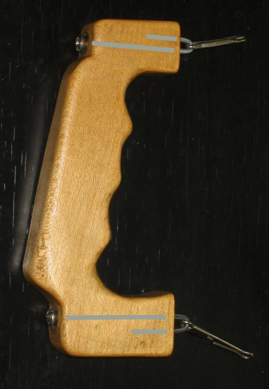

Oh yes, did I mention that an adjustable handle will save you many head aches?
A block of Maple, two 2 mm spokes and 2 washers....:
