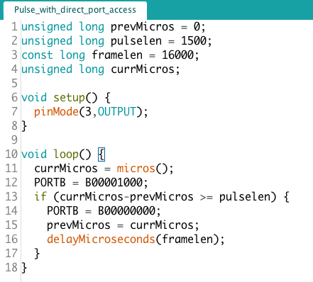

No I did not apparently, but when I do put it in setup it indeed compiles without errors. But the result is not good, the pulse analyser hangs in the opening screen.
However, this seems to work well, producing a rock steady pulse length, albeit some 10% shorter than expected: I am not sure what will happen when the micros() counter overflows.
Max.
- Posts: 633
Re: Digispark as multiple servo driver.
You keep moving the goalposts Max , I thought we were talking about your simple 1500uS generator example?
I would expect this latest iteration to chatter, if (currMicros-prevMicros >= pulselen) is a lengthy statement with lots of processing of longs within the pulse itself (32-bit arithmetic on an 8-bit processor takes a relatively long time to do). I'd suggest doing all the calculations first, rather than within the pulse.
again, with "try cli()" I was referring to the simple 1500uS example you posted, sorry

We are talking about the 1500 us generator, but that is how I check the output, with the pulse analyser that you designed Phil. And I did try noInterrupts() and cli() with the sketch based on delayMicroseconds() and delay().
But there is no harm in investigating other routes, is there?

if (PINB & (1 << Rxch)) { // Check if input pin has changed state 0 > 1
timer_mark = micros();
else { // state change must be 1 > 0
Rx_pulse = ((volatile int)micros() - timer_mark);
sync = 1; // triggers output loop
Max.
