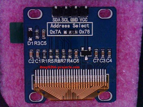

It is possible to change with solder jumpers on the back.

My sh1106 and ssd1306 showed both ADDR 0x3C running an I2C scanner.
But the hardware is different.
Have a look here https://forum.arduino.cc/index.php?topic=256374.0
br KH

Re: SBUS decoder, display, and wireless buddy box project
I know
Both are 0.96" OLEDs. Both have I2C connection. Both show ADDR 0x3C.
But how to say, this one is a sh1106 and that one a ssd1306?
cu KH
cu KH
- Posts: 787
Easiest way is to just edit the config.h file, recompile and upload and see if it works. When you have the wrong display driver enabled, you either get a blank display or a display full of fast-changing 'snow'. The 1106 driver is most often used for the 1.3-inch displays, and the 1396 driver for the 0.96-inch ones, but there may be exceptions.
You won't damage the displays or the Arduino by selecting the wrong driver.
In config.h you'll see the different driver types listed near the top, and you comment out (using // ) all the lines except the one you want.
A bit further down in config.h the default addresses for each display type are defined. If you want to use a different address, just edit the address for whichever display type you have enabled.
Another thing to watch out for with OLED displays, is that the four pins aren't always in the same order. You can get two displays that appear almost identical, but the VCC, GND, SDA, and SCL pins are shuffled around. It's very annoying when you've laid out a PCB to put the pins in the 'correct' order for a display, only to find that for the next batch of displays you buy, it's now the 'wrong' order.
Of course, if you're wiring to the displays with individual wires, it doesn't really matter, so long as you're careful to note which pin is which.
My fault was, thinking that the I2C ADDR is linked to a specific type....
Found out, that my thinking was wrong
br KH

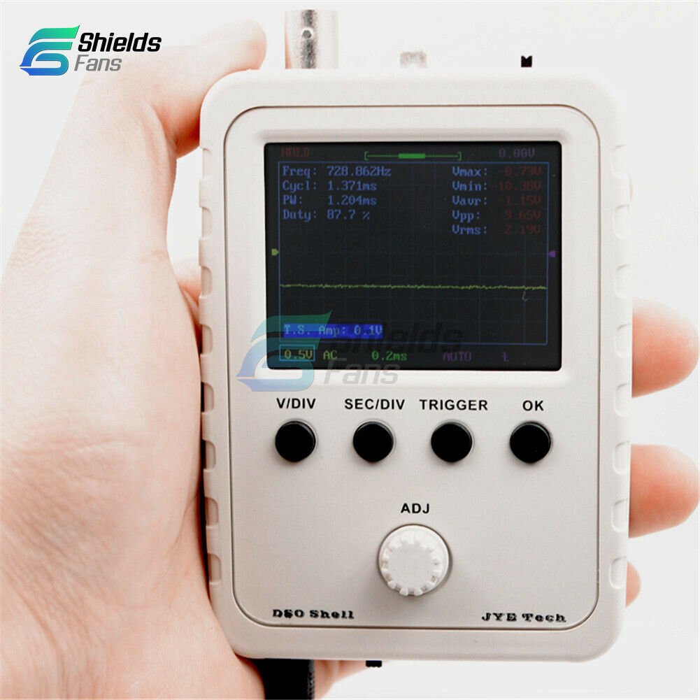

What nice little Oszi you have got? Is it self made or can I purchase it? And if so, where?Martin wrote: 22 Jun 2020, 13:13

- Posts: 787
It's my PPM decoder. There's a thread about it, and details on how to build one here: viewtopic.php?f=41&t=612
It's not really an oscilloscope. The 'oscilloscope-like' display only works for PPM signals - you can't use it to display, for example, audio signals.

- Posts: 776
The only problem with that scope is they're only 200KHz and one of my friends bought one and was a bit disappointed. I briefly tried it and it had trouble in measuring a 100K baud serial and can only display ppm with a 5uS resolution (only accurate to the nearest 10uS, even though the advert pictures show mS to 3 decimal places which infer 1uS resolution). He finished with one of these in his flight-box which is slightly more suitable for R/C work:
https://www.ebay.co.uk/itm/384187706880 ... SwanFcrdtk
