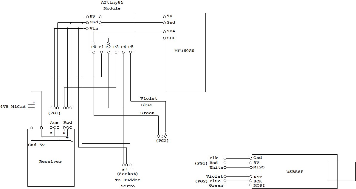

- Posts: 750
Re: Any Arduino Gyro Projects
Jeff (bluejets on the forum) has PM-ed me this nice schematic diagram. Thanks Jeff! I'll include it in the next revision of the "manual". Click on the schematic to see a clearer view - I think the inline version is being resized for display which makes it look blurry (on my PC screen anyway).
