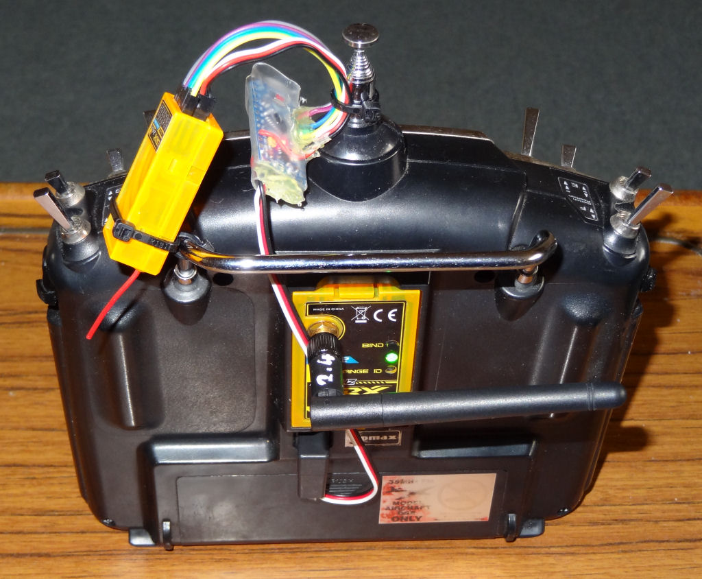

I began instructing a new student today, and in these socially distanced times, thought it better not to use the usual "hardware" buddy box lead.
Idea was to have an ordinary radio receiver mounted on (my) instructor's transmitter, and use an Arduino (I used a 5V Pro Mini) to take the outputs from that receiver and convert them into the usual buddy-box format (CPPM). The receiver is bound to the student's transmitter, and then you can stand as far apart as you like!
You can use any brand of radio you like, and use 27 MHz, 35 MHz, 2.4 GHz or a mixture - receiver outputs (for connection to servos) and buddy box signals (save for using different connectors) have always been the same, for about forty years now!

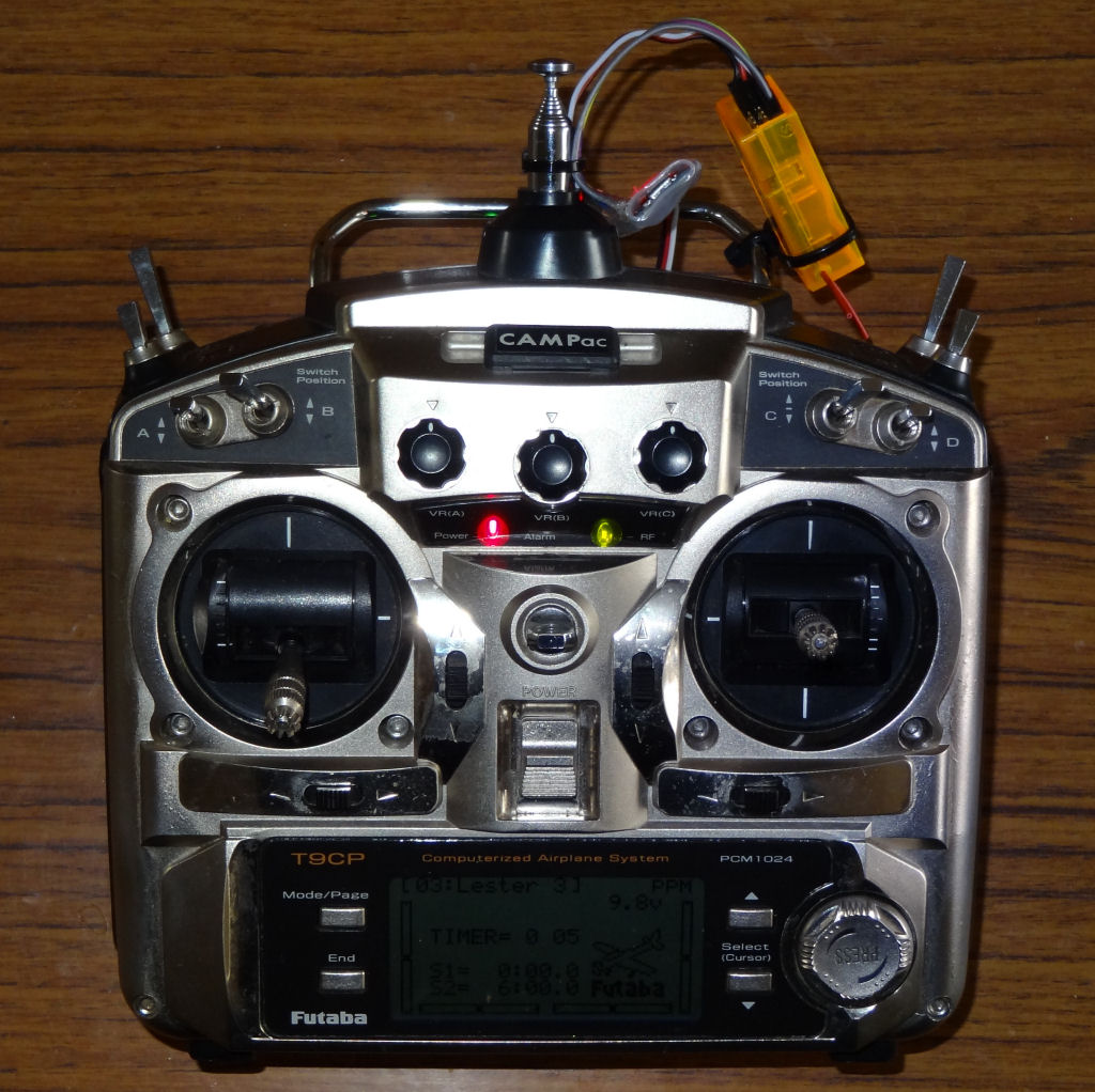

Some other guys in the club want Futaba-compatible buddy connectors, so even though this student used Spektrum, I dusted off my old Futaba FF9 and lashed up a system using an Orange transmitter module in the FF9 and an Orange receiver to receive the signal from the Student's DX7.
That's a quick and dirty lash-up, of course, but I didn't have time to design and 3D-print a nice case to put the stuff in.
I could have used a CPPM receiver or an SBUS one, but using a plain dumb receiver has the advantage of making it easy to swap the received channels into the correct order, by simply swapping around the wires linking the receiver to the Arduino. This was definitely needed with the old FF9 transmitter. I didn't want to start swapping the servo connections around inside his plane, partly due to virus cares, but also so he won't have to swap them back again when he's ready to go solo. A bit of fiddling around with custom mixes allowed me to configure the Futaba transmitter to transmit in Spektrum channel order, but my old transmitter isn't smart enough to swap around the buddy box training lead channel order - so I did that by moving the wires where they plug into the receiver.
It all worked nicely, and we had a few successful flights.

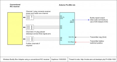

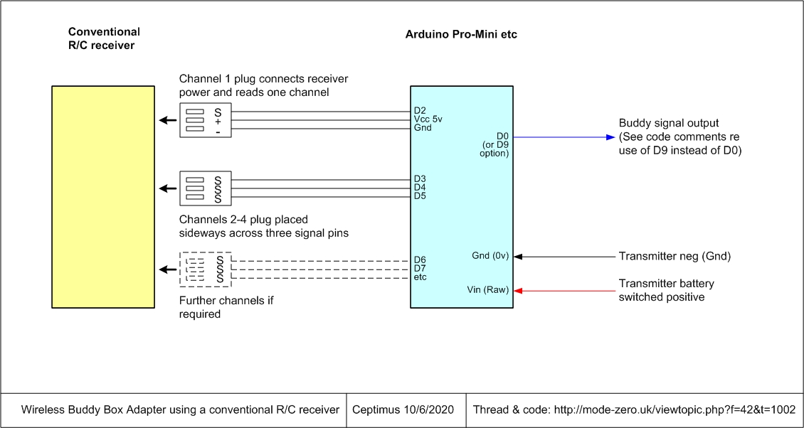

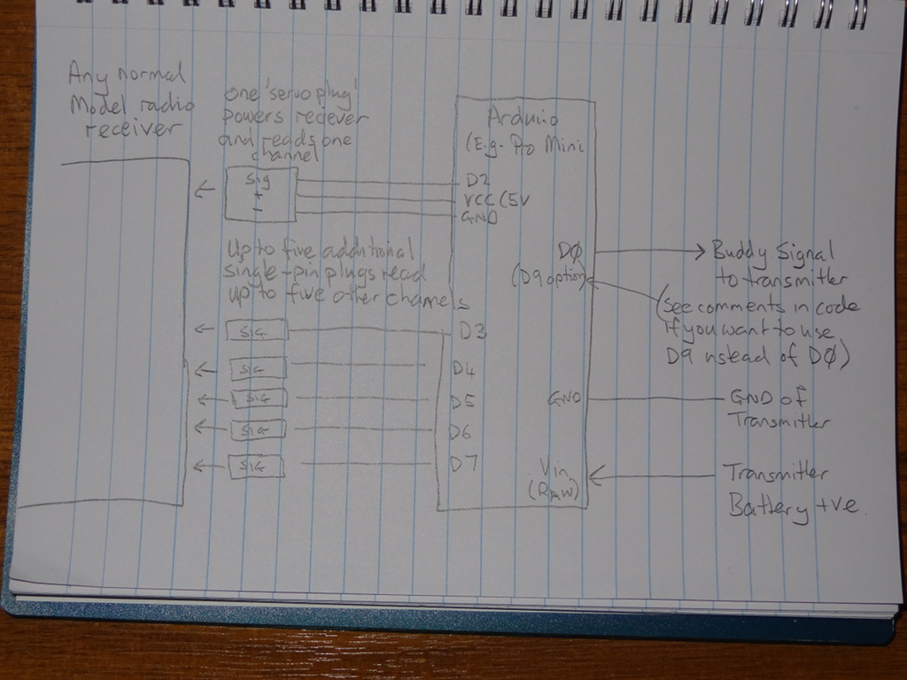

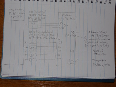

Here's a rough schematic. (Click for larger view).
If you're using a Futaba transmitter, or a Hitec, with a training port (buddy connector) then you have access to the transmitter battery +ve on one of the pins. Futaba have used two different round DIN connectors in the past, and now use the 'square' connector. You will find plenty of diagrams of which pin is which with a quick internet search.
The square connectors are difficult to obtain. I robbed a connector from an old simulator lead - the back of the connector comes off by carefully inserting two small screwdrivers to push open two catches where the 'barbs' of the other connector part engage: then you have access to the solder pins and it's a tiny fiddly soldering job. Plug the connector into a transmitter if you can, while you solder, as this acts as a connector heat-sink and stops the plastic melting.
You won't harm anything by having the signal pin connected wrongly, but if you mix up the GND, and battery +ve with each other, or run the battery +ve into one of the signal pins, then you may damage your Arduino. In the worst case if you short the transmitter battery +ve to the transmitter signal pin(s) you may even damage your transmitter - so be careful!

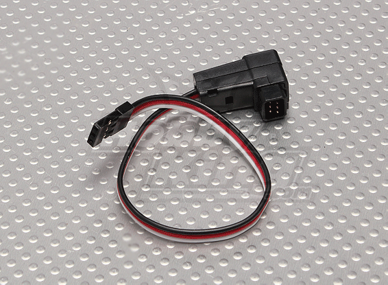

Hobby King sell a small adapter lead that links the square plug to a servo-style plug (but beware that plug has the transmitter battery voltage on the middle pin, and not the usual servo or receiver 5V). I don't know if that adapter is intended for use with computer simulators (it probably is) in which case the 'signal' wire will be connected to the 'signal out' pin (3) and not the 'signal in' pin (6) which is what you need. So even if you buy that adapter, you'll perhaps still need to take it apart and move the signal wire over.
With JR or Spektrum transmitters it's more difficult - they use a 3.5 mm mono jack plug where the tip is the signal, and the sleeve is GND. If the transmitter has a USB port, you can pick up 5V from that (and connect to the Arduino 5V (VCC) rather than Vin / Raw as you would for a higher battery voltage. Failing that you can either use a separate external battery, or somehow modify your transmitter to allow the (switched) battery +ve to be routed the Arduino's Vin / Raw.
If you need more information, let me know, and I'll try to provide it.

The futaba plug is available from Hobbyking for around AU $1.60....
https://hobbyking.com/en_us/futaba-6pin ... rh_pdp=6
Edit...slow brainwaves today......just saw your explanation..
Going by your diagram, the servo plug would be removed anyhow I'd imagine and the Tx voltage feeds RAW .
Just found one in my box of goodies and the power, Red is pin 5 , Gnd is pin 2 and White signal is pin 6.

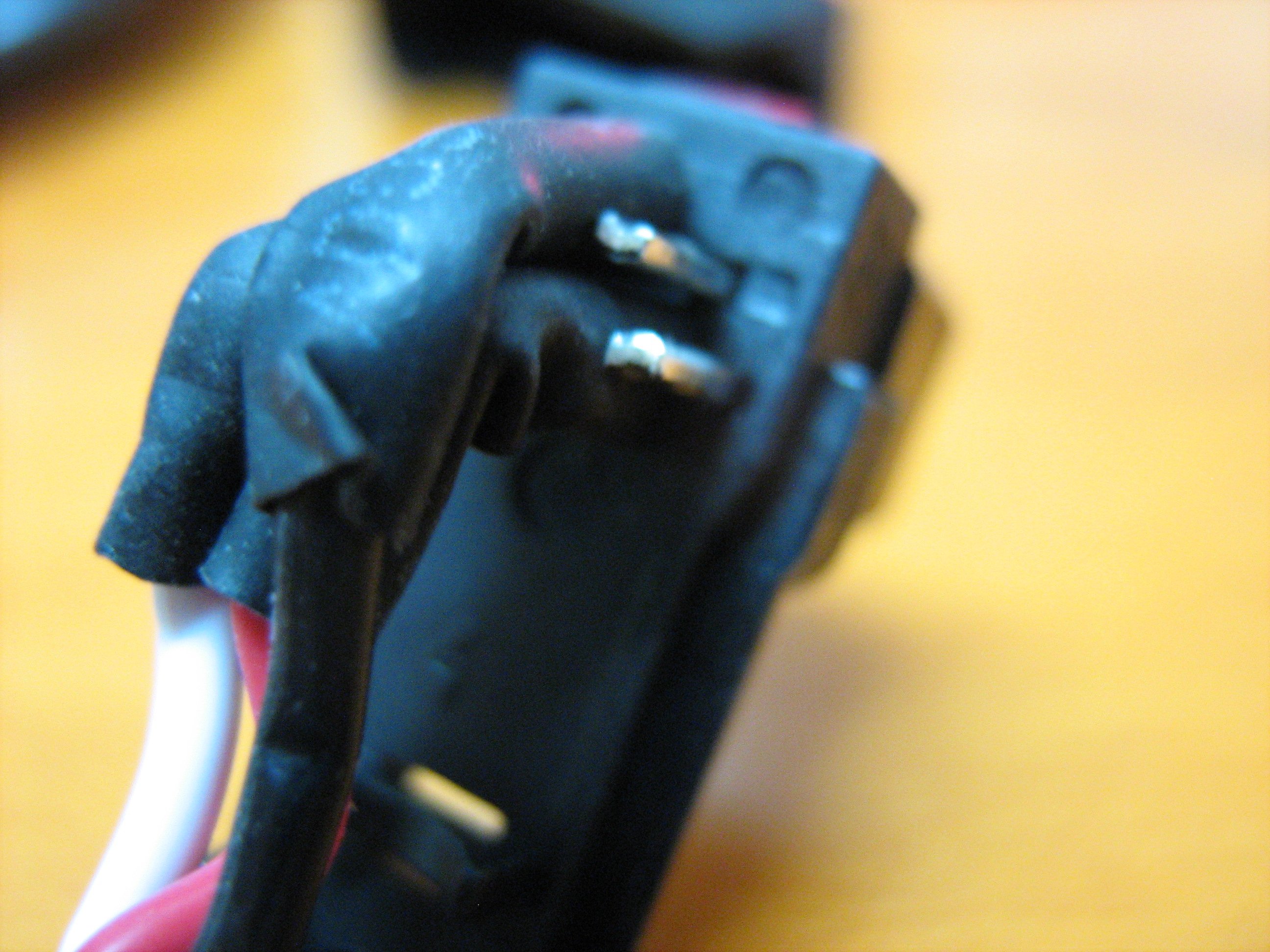

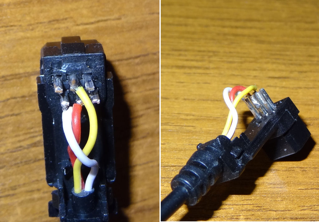

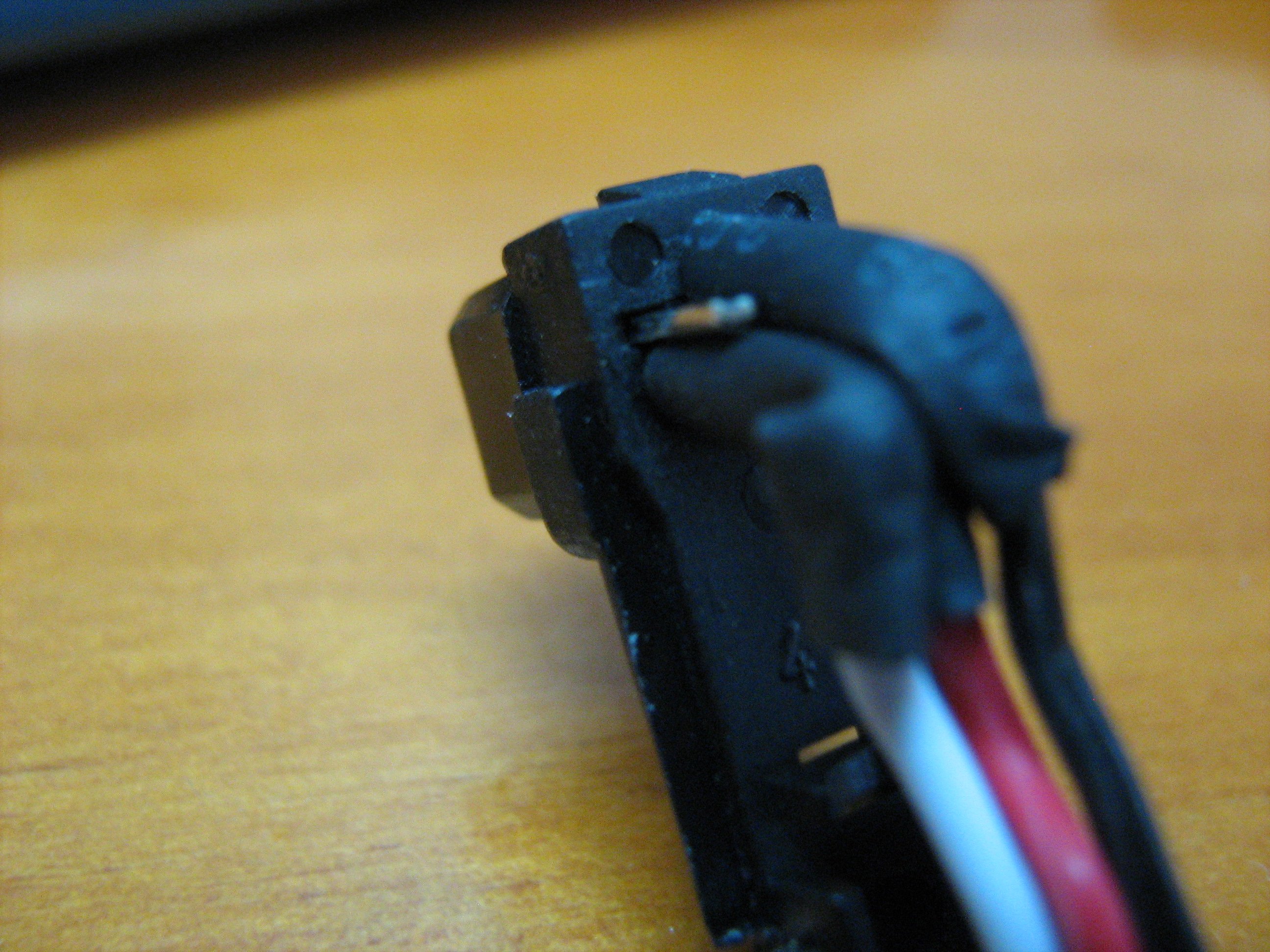

I found one of those square plug to servo plug adapters in one of my boxes of assorted leads. I've no memory of where it came from and I don't remember ever using it. It's slightly more upmarket than the Hobby King one, in that it uses a posh three core cable instead of the flat servo cable.

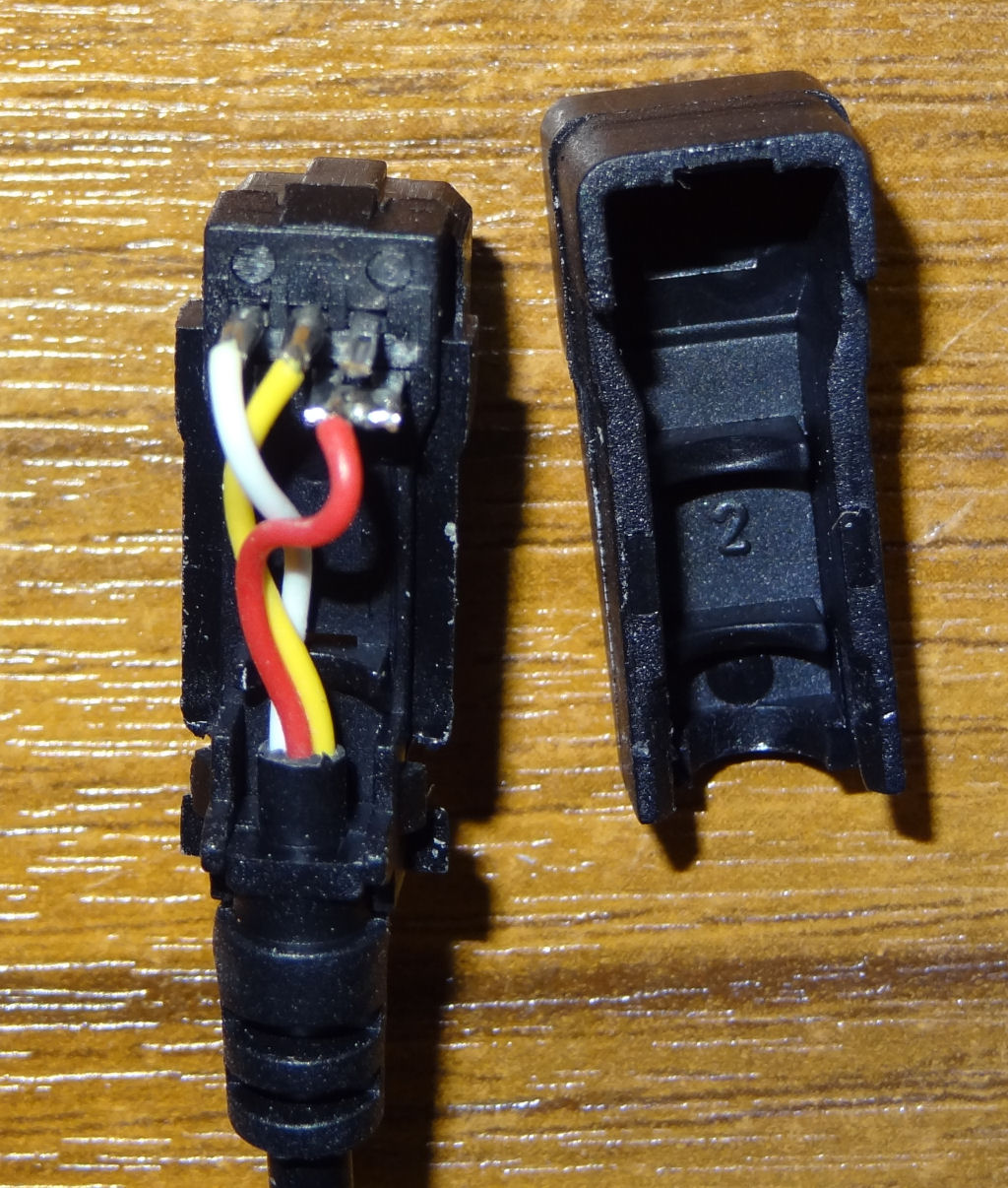

I prised the back off (carefully) and this is what I found - as I expected it's designed for use with computer model flying simulators. Click photo for larger view.
AS FOUND - NOT WHAT'S NEEDED FOR THIS PROJECT
The red lead is soldered to both pins 4 and 5. The first of these is a direct connection to the transmitter battery (unswitched) and the second powers up just the encoder part of the transmitter (but not the RF section). With the two pins soldered together like this, the parts of the transmitter needed for simulator work are powered up as soon as the plug is inserted - even when the transmitter power switch is in the off position. This is not really desirable for buddy box work because you'd have to unplug the connector after each flight to avoid running your transmitter battery down (and getting 'inactivity alarm' messages on newer sets).
Incidentally, the reason Futaba designed their connector like this, is that with a real hardware buddy lead the battery and switched encoder pins are cross-connected through the lead. This means that the slave transmitter doesn't need to have a battery fitted (the required parts of the transmitter being powered through the lead from the master transmitter), and more importantly, the RF transmitter part of the slave transmitter isn't powered up, so back in the days of 35MHz you didn't need to worry about getting a frequency peg for the slave transmitter, or the risk of the slave transmitter shooting down its own model if both slave and master transmitters were fitted with the same frequency crystal.
The yellow wire is soldered to GND. That's fine, though the yellow colour is confusing - with the Hobby King adapter the black wire would be soldered here.
The white wire is soldered to the 'transmitter signal out' pin. This is fine for simulator work, but for this buddy project, it needs to be moved to the 'transmitter signal in' pin.
HOW IT NEEDS TO BE WIRED FOR THIS PROJECT
Code: Select all
        Arduino
          GND
         black
(3)       (2)       (1)
 O         O         O
      O         O         O
     (6)       (5)       (4)
   Arduino   Arduino
  D0(or D9)  RAW(Vin)
    White      Red
Here are some photos of my lead after modification (click for larger view). Remember, your lead will most likely have a black wire in place of my yellow. Remove or disconnect the battery in your transmitter, and then plug the connector into your transmitter while soldering - that supports the connector pins, acts as a heat-sink, and stops the plastic melting. Use your best pair of eyes! Hobby King probably use the eyes of fourteen-year-old girls when making the original adapter leads! :lol:
