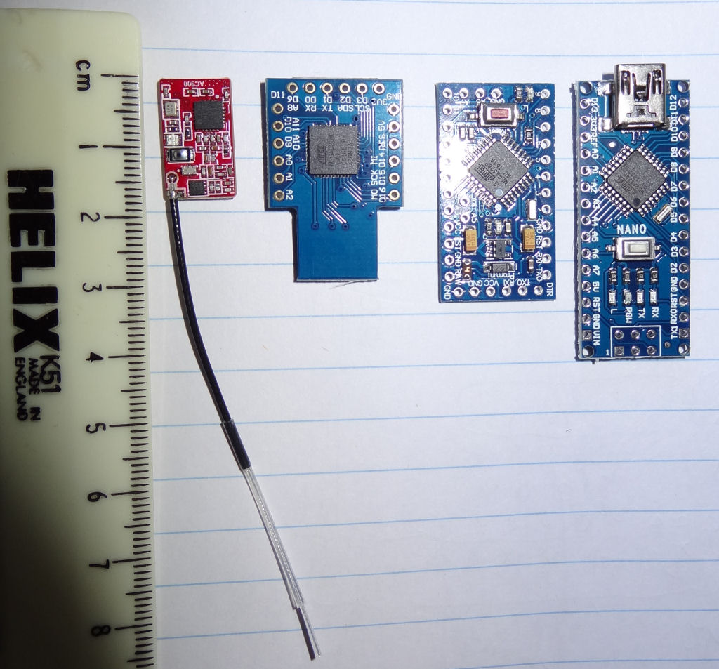

The photo compares the sizes of a Nano, Pro Mini, Beetle (from which the 'tongue' can be sawn off) and the receiver. You can see why I wanted to keep the Arduino small! That receiver, by the way, can bind to Futaba or FrSky, and for FrSky it can bind to either EU or non-EU protocol transmitters (something that "real" FrSky receivers can't do - with those, you have to re-flash the receiver firmware to swap between EU and non-EU).

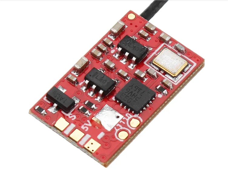

On the xboss receiver, right next to the sbus signal pin, is that an inverting transistor? If so you could remove it and pick up 'true' fhss from the base pad ... dont think its a reg as it looks like two visible regs above it.

Interesting! :D My receiver has a different layout - it's the X-BOSS AC900 V2. I need to get it under my microscope and follow the track from the signal pin. The microscope can take photos so I'll post them if I find anything interesting (and possible for a mere mortal to solder to). :D

Thanks for that information. It's possible that my V2 receiver can switch between inverted and non-inverted. There's a section in the brief and slightly-Chinglish instructions about "RECEIVE MODE SWITCH" that I didn't understand. I'll do some tests and maybe I can remove the bulky transistor and resistors.
