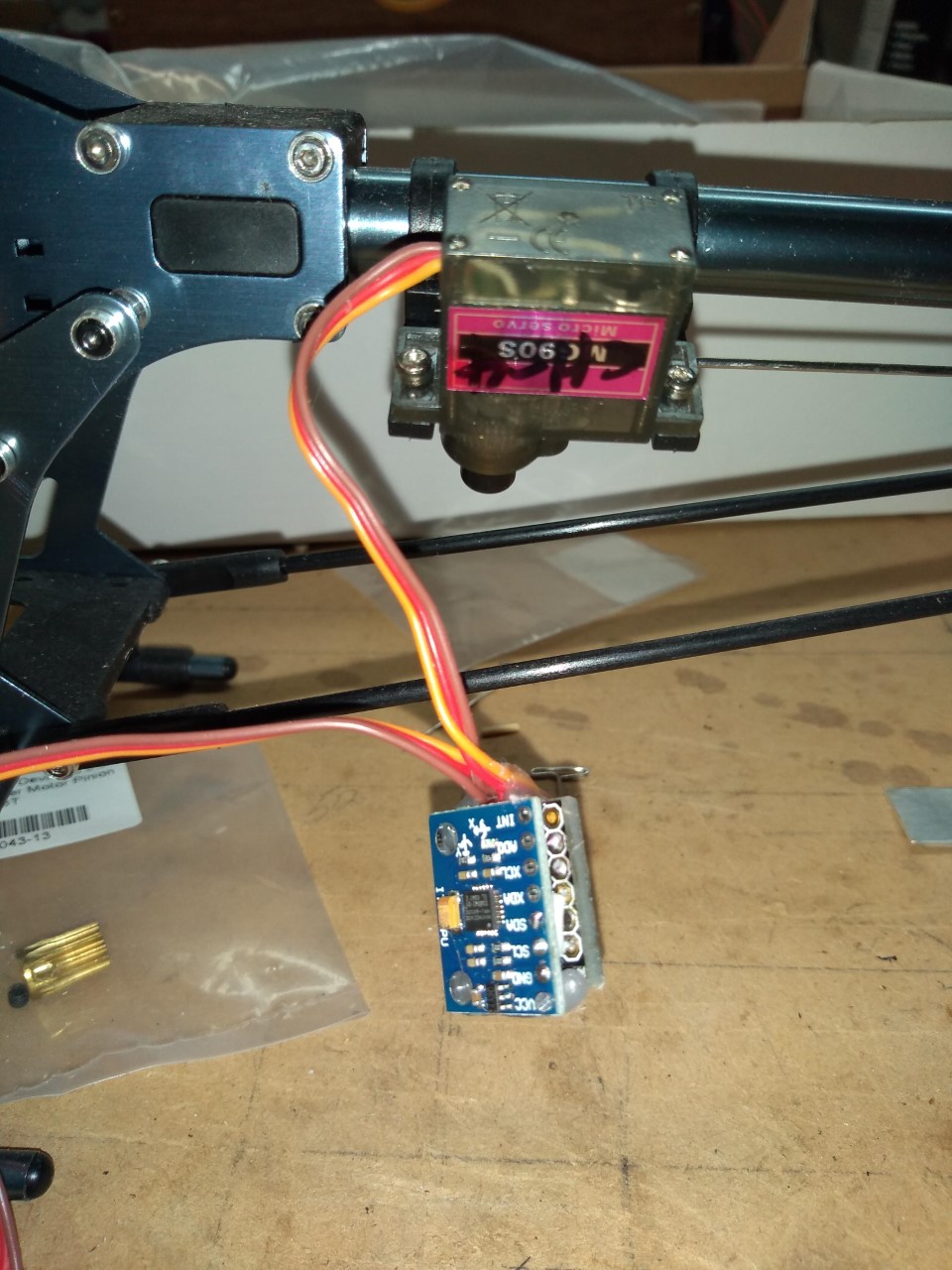

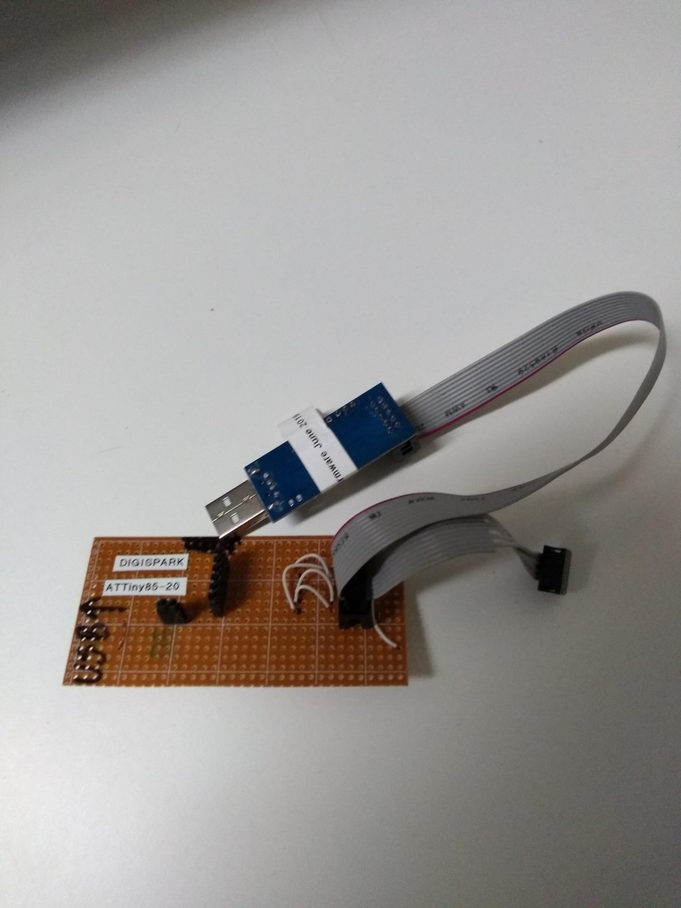

Re: Any Arduino Gyro Projects
Made another gyro today and will use just the rate mode so cut down on the cabling.
Programmed the board first and then built up from there.
Should be able to try it sometime in the next couple of weeks.
Still have to set up the rest of the machine.
