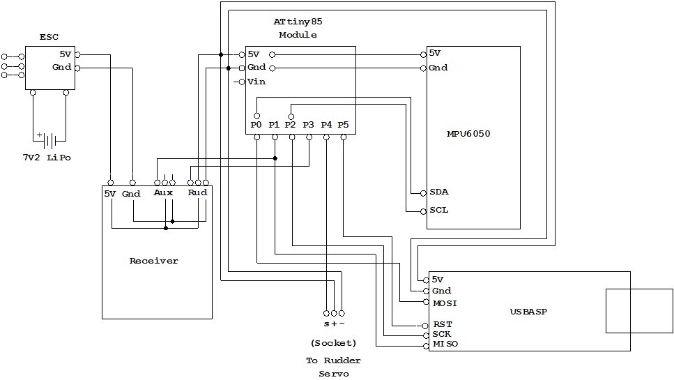

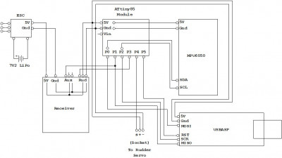

Possible to get someone to check the enclosed drawing for the correct connections..??
Thanks...

- Posts: 748
Re: Any Arduino Gyro Projects
Nice diagram, Jorgo! It looks right to me.
For the ones I built, I connected the +ve common from the battery / Esc / Servo to Vin rather than 5V. This means that it's safe to connect a battery (or Esc) that puts out more than 6V, but of course has the disadvantage that the volt drop across the Digispark's on-board voltage regulator means that the whole contraption stops working at a higher voltage than it otherwise would.
I tried mine with the MPU6050 connected to the same Vin point as the Digispark and everything worked down to 4.1V input, but stopped at 4.0V. I also tried connecting the VCC in to the 6050 to the "5V out" from the Digispark (which of course is a lot less than 5V with only 4.1V at Vin) and the whole thing still worked with a 4.1V supply.
My conclusion was that the ATtiny stops working first - probably at around 3.3V on the actual chip and that the MPU6050 (which has its own on-board 3.3V regulator) keeps working even when the supply to its regulator drops to around 3.3V.
I wound the supplied voltage up to 9V and nothing went pop: something would actually burn out at perhaps 13V or so, but I didn't want to risk testing that high!
If you have a supply from a battery or Esc that you are confident will never exceed 6V, then the connections you show in your diagram are a better way of doing it.
