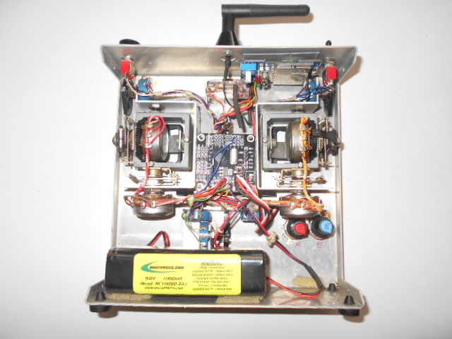

Here is a Proline 6 with a Multi-protocol module set-up for DSMX, PPM mode. Has CAR active mix, rates and expo.Trainer button does cal and single channel emulation. Other switch is for mix.
Thanks Phil G for excellent encoder.
