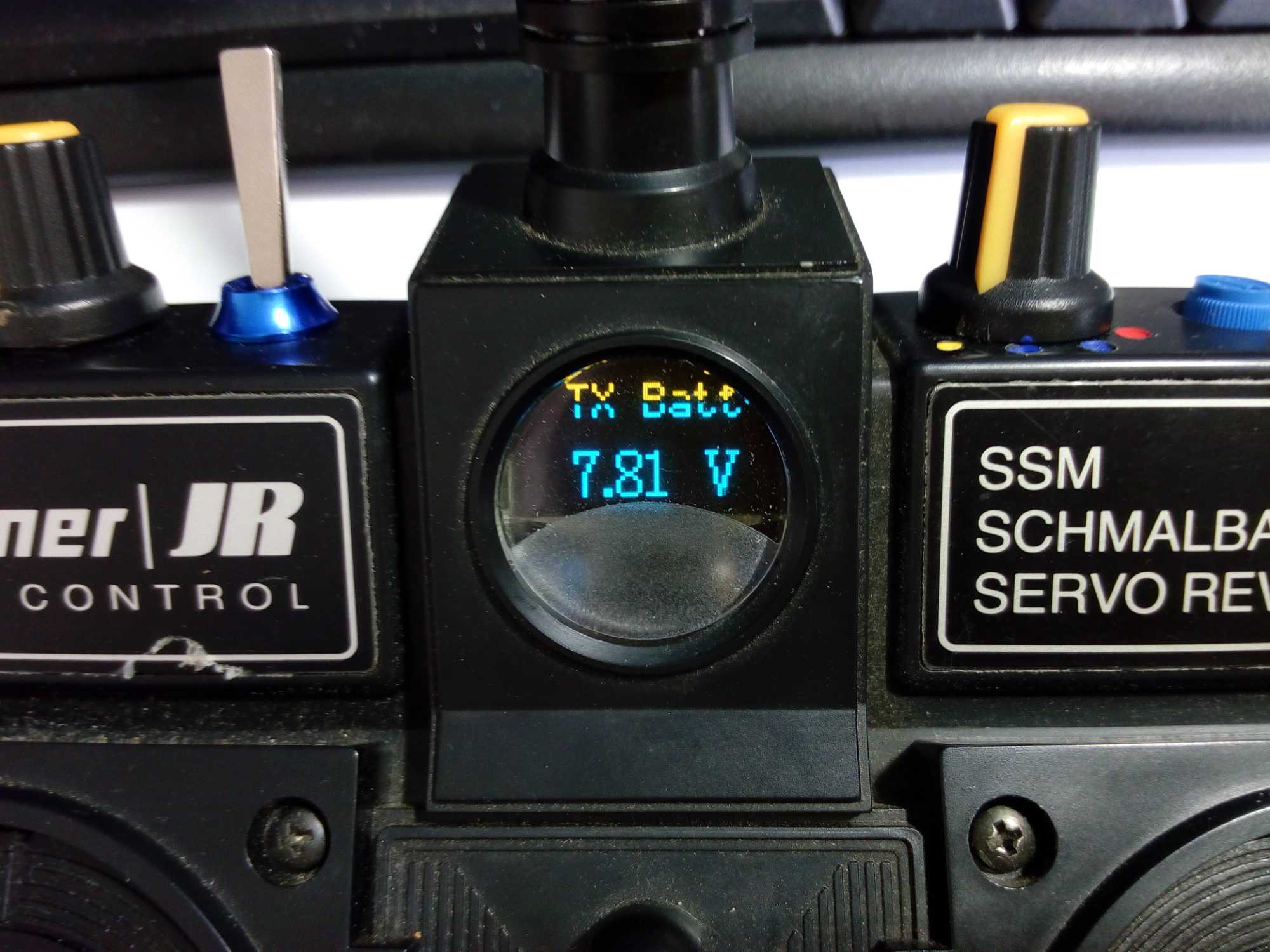

I have uploaded details of a replacement OLED digital transmitter battery voltage module at
https://forums.modelflying.co.uk/index. ... nt-1045618
Files are here https://drive.google.com/drive/folders/ ... sp=sharing
OLED Tx battery voltage display

Re: OLED Tx battery voltage display
Any problems give me a shout.
Common failings -
you will need the 'ATTINYCORE library, the Tiny4KOLED library and the TinyWireM library
don't forget to 'burn the bootloader' in the Arduino IDE before flashing the sketch, it doesn't actually burn a bootloader but it does set the fuses - set the clock source to 8Mhz internal, then burn bootloader then program via programmer.
Happy fergelling.
Common failings -
Happy fergelling.
