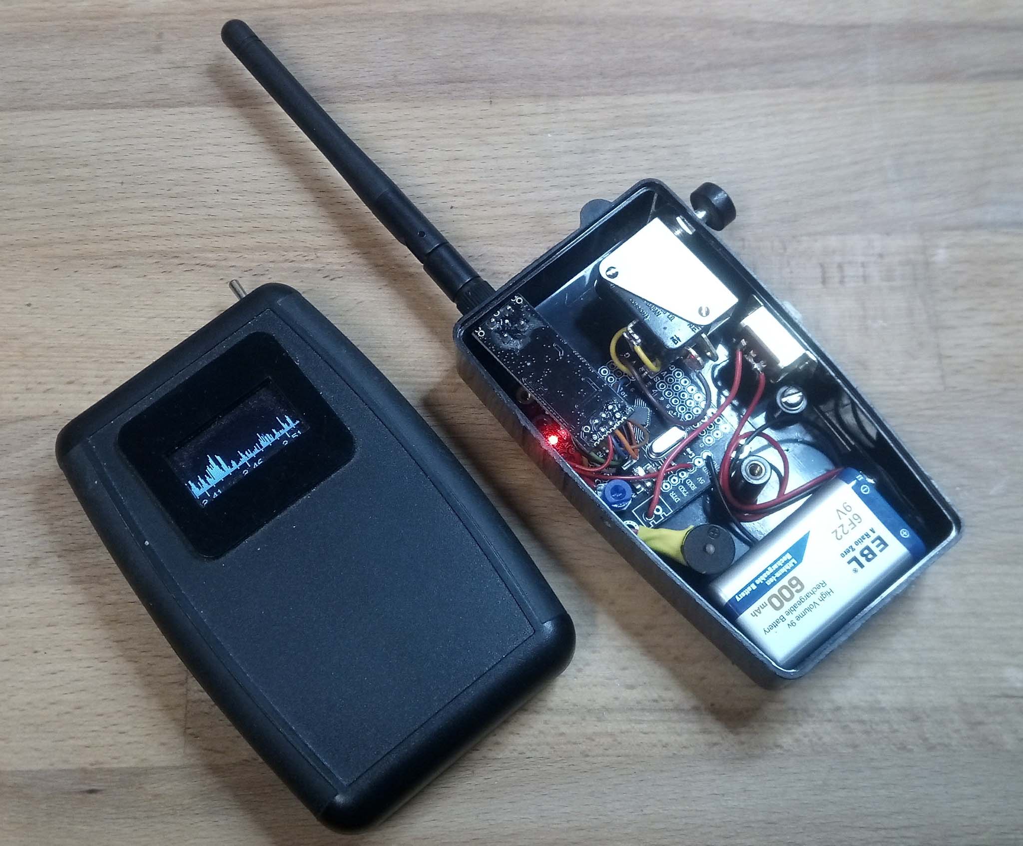

This was initially just a quick hack to test the RF-Nano, but I love my S/C gear so I've since done a more functional, usable single-channel emulation encoder using full FHSS for either the RF-Nano or a separate Arduino and NRF24L01 module Image
All of the RF bits are the most-recent timer2 code taken from the propo FHSS project so it works to the same receivers, based on the RF-Nano, or Promini with NRF24L01, etc.
Like the propo set it uses sixteen RF channels well spread through the band and has Single-Channel compound emulation giving rudder, kick-up elevator and quick-blip throttle at either of two selectable compound keying speeds (similar difference to the Elmic Commander vs Elmic Conquest), also does sequential escapement emulation, has an inactivity alarm, servo reversing, Vtail & Elevon mixers, minute-minder, travel adjust (rates) with 'minimum' set for torque-rods - rudder & elevator throws are governed either by a pot on A7, or a link which gives a fixed 50% for torque-rods. It has the 'button follower' channel for driving a genuine escapement via a channel switch.
The quick-blip throttle is a cyclic 4-position 'off-half-full-half' just like the PIC S/C encoder, and of course the two 'half' throttle positions dont have to be 'half' and dont even have to be the same.
I havent done a motor run timer for sequential yet but I might add that, with manual trigger & ramp-up, maybe the time could be set by a pot on A6, say 1 to 5 mins? Does anyone use sequential? Image
(thinking about it, thats silly - if theres a pot it might as well be a throttle pot!)

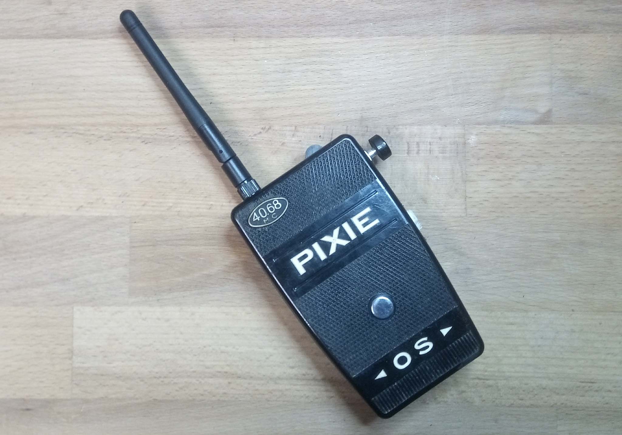

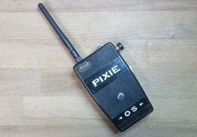

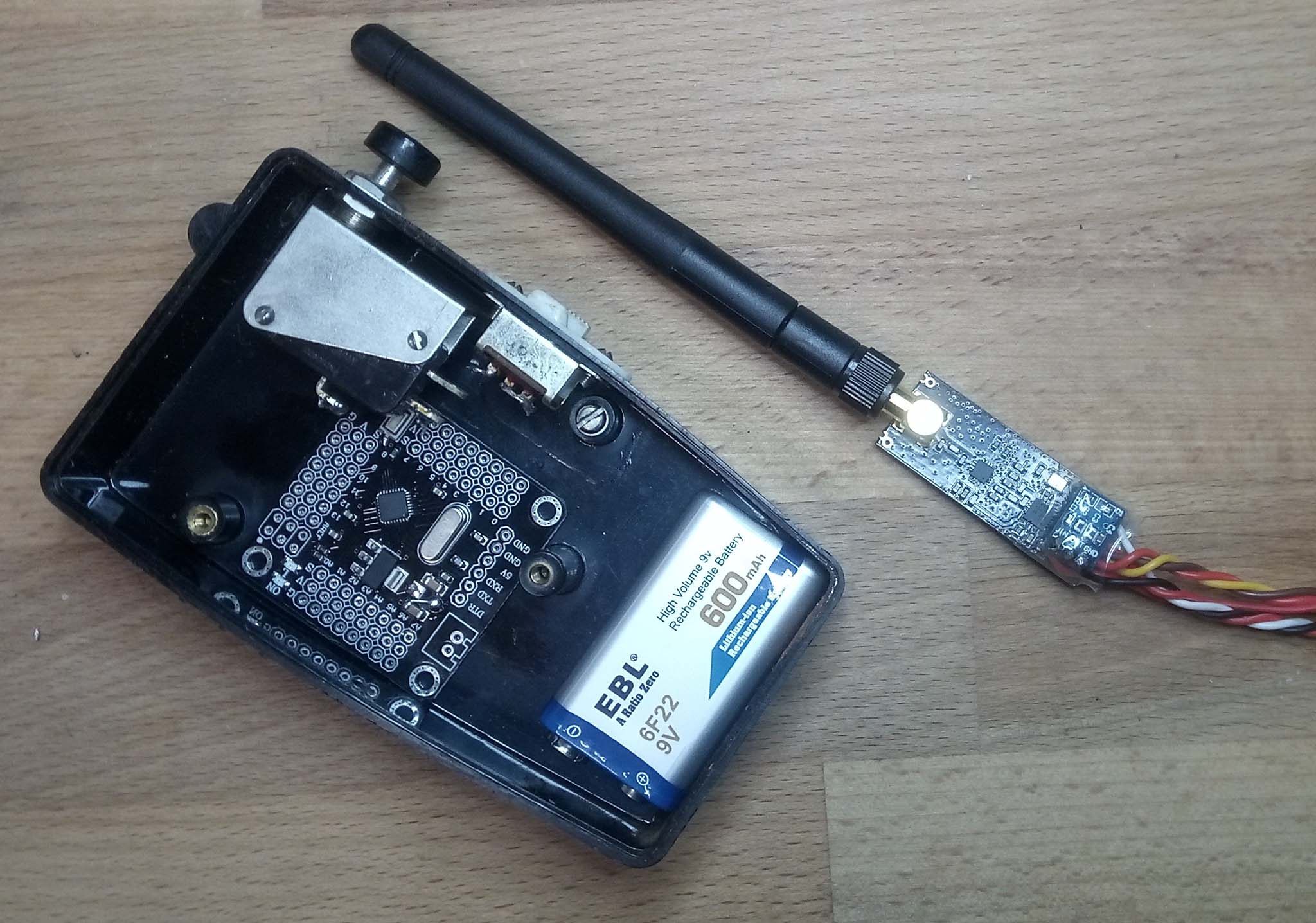

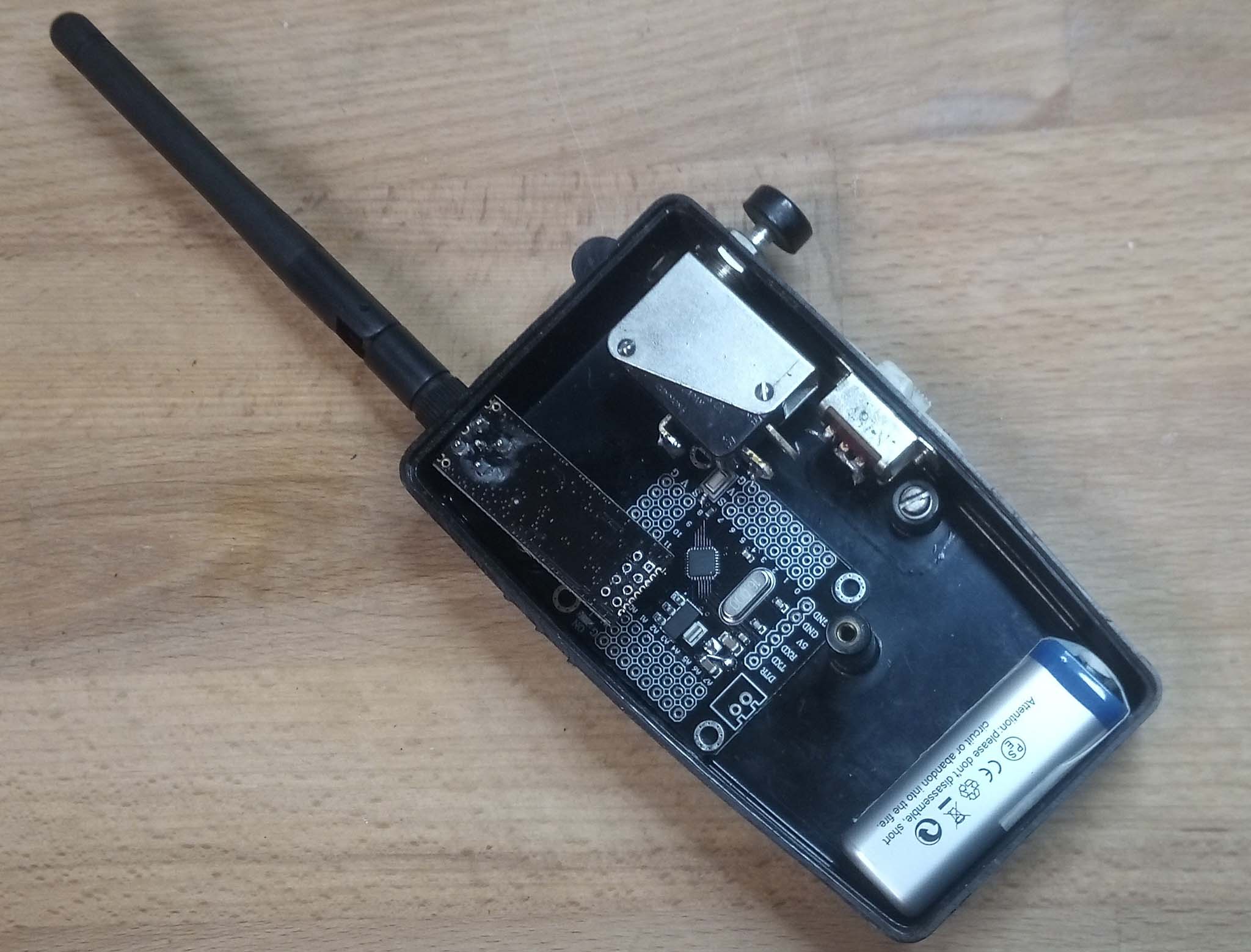

Theres just enough room in a Pixie Mk2 for a Strong board without the headers, the only problem I can see is the original aerial hole cant be used as its under the microswitch, its a shame but I'll have to drill & mount it on the opposite side. The tx module uses one of Franks tiny 3v3 regulators standing on the 3v3 and gnd header pins, with the usual 100uF tantalum across them:
Done, works great, cost about a tenner including a receiver :D
Demo: Simultaneous use of a common configuration :D
Remember the furore when Futaba accidentally released a few transmitters with the same GUID? That was a Bad Thing, but doing the same thing intentionally can be useful within your own fleet - it means you can fly any model with any of your transmitters, and the instant linkup means you can even change transmitters mid-flight. But what happens if there is an overlap, where two transmitters with the same configuration are on at the same time? Whilst it maintains synchronisation, the receiver is unaffected by the second transmitter. Inevitably at some point a few packets will be missed are it will re-sync, at which point its a 50:50 chance of which transmitter it will lock to, and you wouldnt intentionally stretch the period when both transmitters are on. But for a brief overlap, there is no conflict, no failsafe, no magic smoke, just well-behaved continuity.
Whilst I might choose to set up my transmitters with either a common configuration, or have them all different - yours can also be all the same or all different, BUT all of your configurations must of course be different to mine. This is why the actual config I use is never included in published code!
PS since making the video, my 4-way dipswitches have arrived so its easy to switch between sequential and compound, fast or normal, reversing etc, from inside the Pixie
PPS the Pixie has since had its NRF board swapped for the screened version, and has flown many times in this guise.
