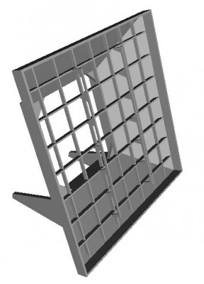

I use a computer fan, powered from a 3-cell LiPo when soldering. I 3D printed a shell to hold the fan, and it sucks the air through some filter material I bought on-line. I stand it on the desk behind where I'm soldering, and it produces a gentle air current that takes the smoke into the filter rather than up into my face. The filter probably doesn't catch much of the flux smoke, but at least the smoke is going away from me rather than towards.
