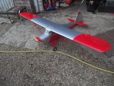

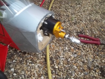

A few photos of the Aeronca which also might be a Cessna!, she weighs 70 oz. complete less battery and has 700 square inches with a 70" span so certainly towards the floaty side, I don't possess any 2s lipos above 500 ma so have a few tired 2.2 3s or similar which I will use for test flying attempts and try not to use full throttle! If she flies as good as she looks I will definitely be happy to buy a couple of suitable 2s packs.
Blue jets, I have looked for the BMS type device you mentioned but cannot really find anything, if you had a link or source that would be very grateful, like I have said before, I was a builder in my other life so problem solving generally involved a lump hammer!

My money's on it being an Astro Flight Porterfield Collegiate.
Gary
