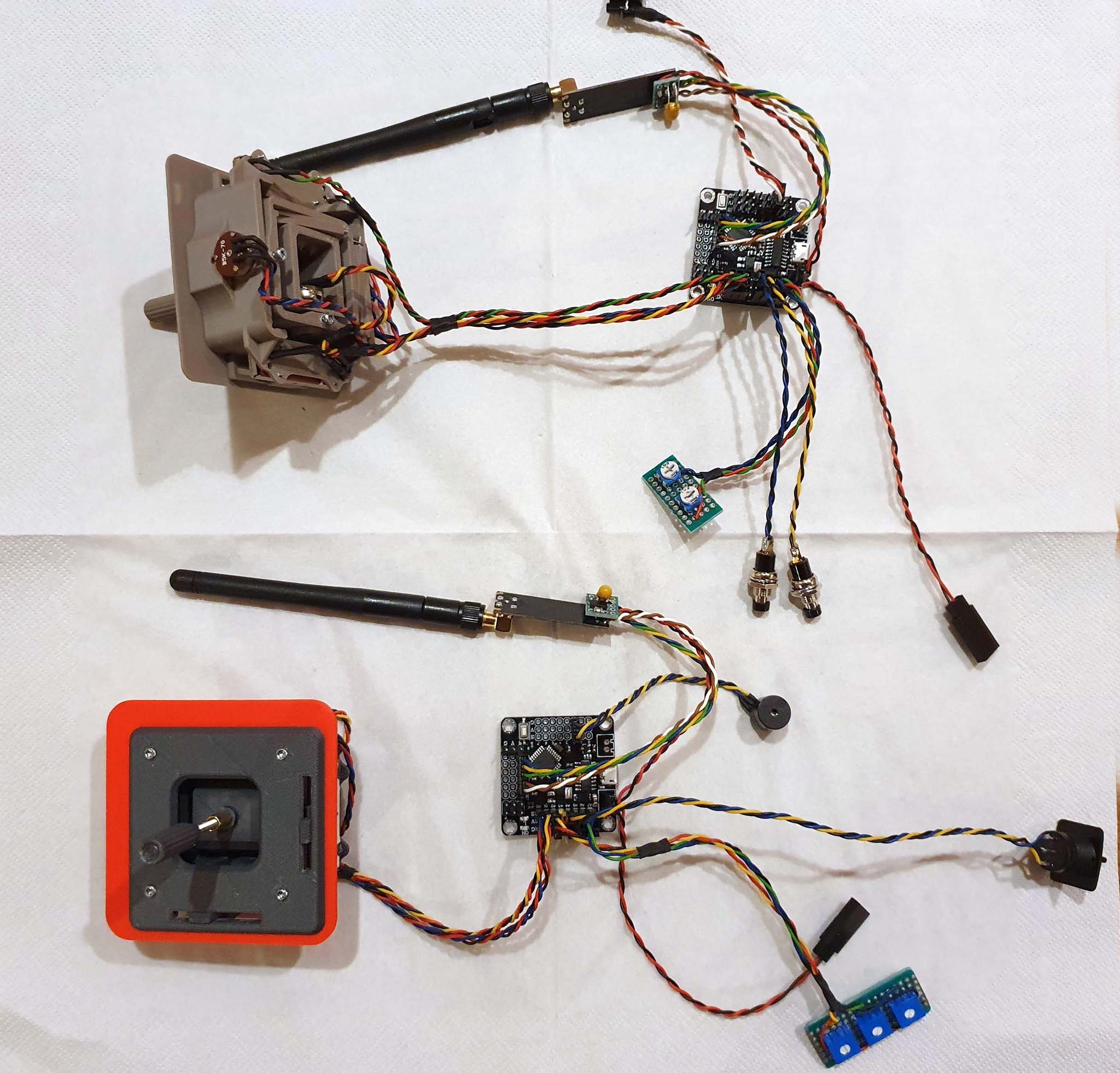

What encoder are you going to use for the conversion?
My encoder board has two pots on the board for that purpose and would manage all Phil's sketches as a few others
True I use most nRF24L01 but a ppm can eased be accessed and thus run a regular RF module lie the Lemon
I have not only suitable pots that could be mounted on a piece if strip-board but also encoders that I could program for in accordance with what you are looking for

Re: Internal potentiometers for rates and expo
Hi Tobe
I'm using Phil's 7 channel encoders for these conversions and the Lemon RF modules that I had from Stuart. My plan is to have the s/c button mounted on the front right of the transmitters and no additional switches outside of the case. They will likely each be dedicated to a single model, but I thought that the option to be able to set rates and expo would be useful, if they needed to be bound to additional models.

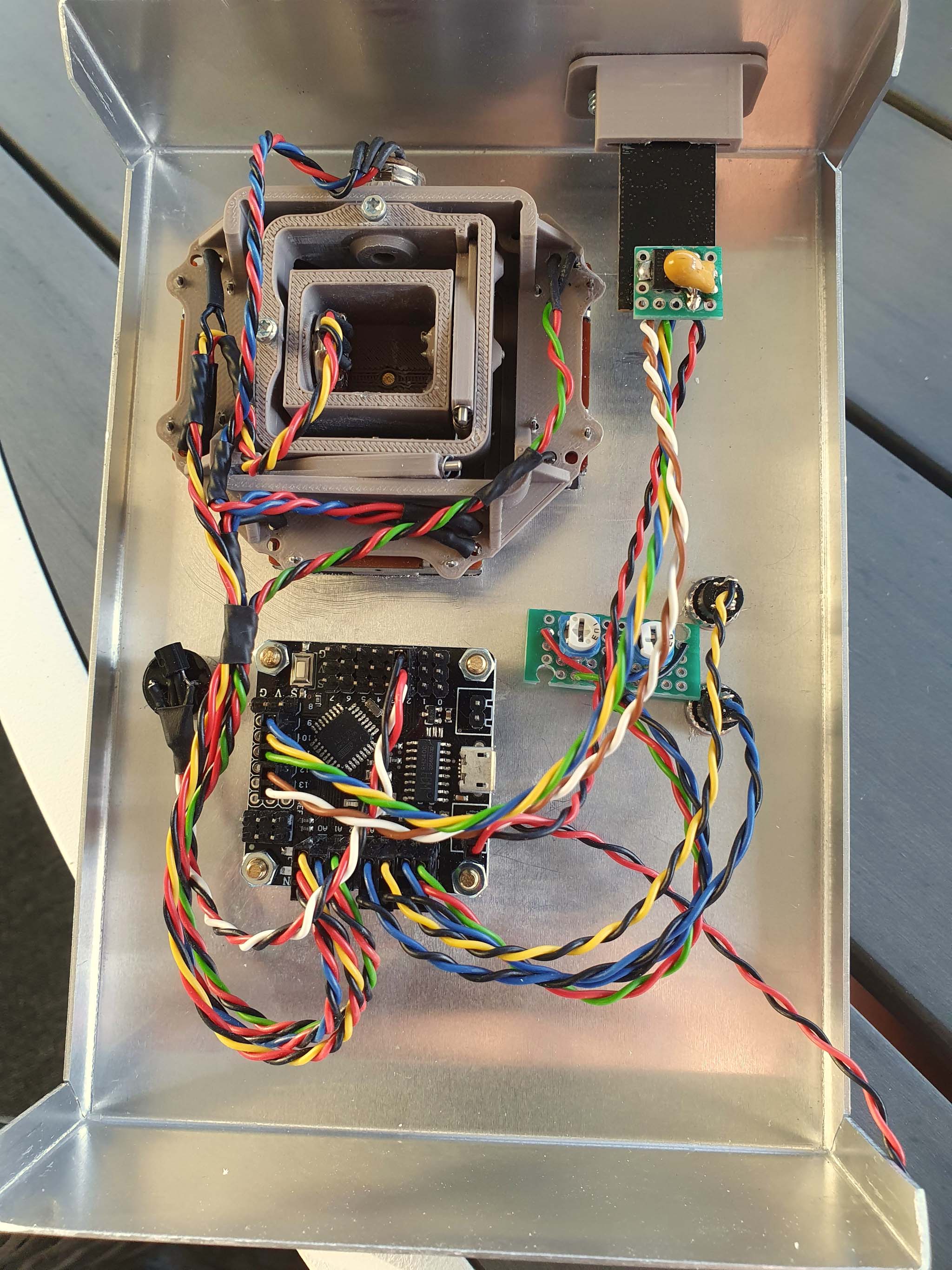

- Posts: 668
Just to give you an idea in how to solve internal "pots", here they are connected as per Phil's instructions
- Posts: 115
- Joined: 30 May 2023, 16:52
- Location: Perthshire
Thanks Tobe - that's really useful. I'm sorted now with a source for some suitable pots, so as soon as those arrive I'll be able to get started. It'll be just about my first electronics project beyond a simple light and buzzer circuit many years ago. I'm bound to have extra questions, but will put them in the thread showing my progress.
