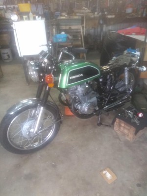

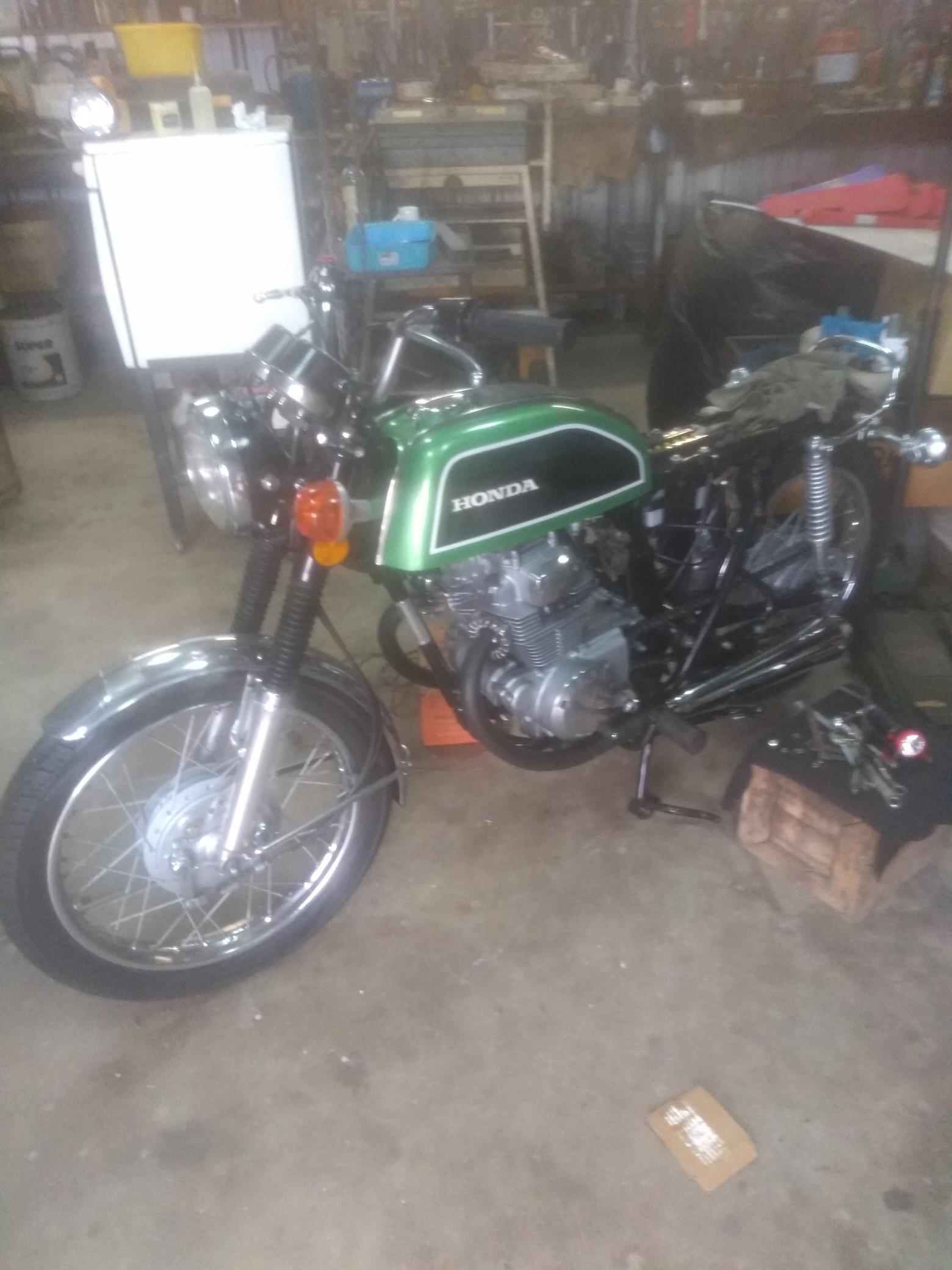

Latest February 2023, going together nicely.

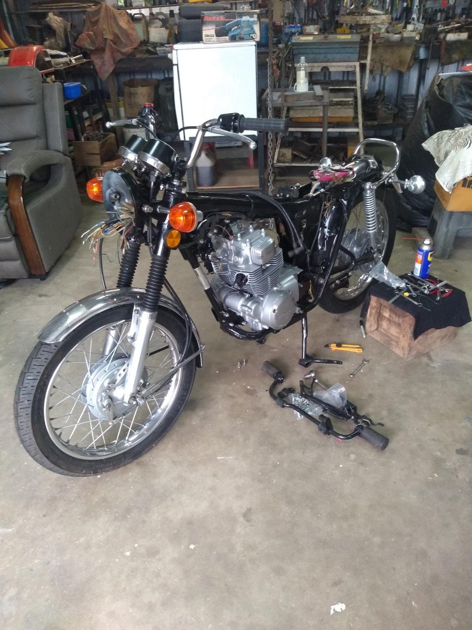

Currently working on electrics which can be daunting as there are UK, USA, French,European versions but Aus seems to get a right mix.
So went back to basic logic, works for me.
72 yesterday, need to get the finger out......... :lol:

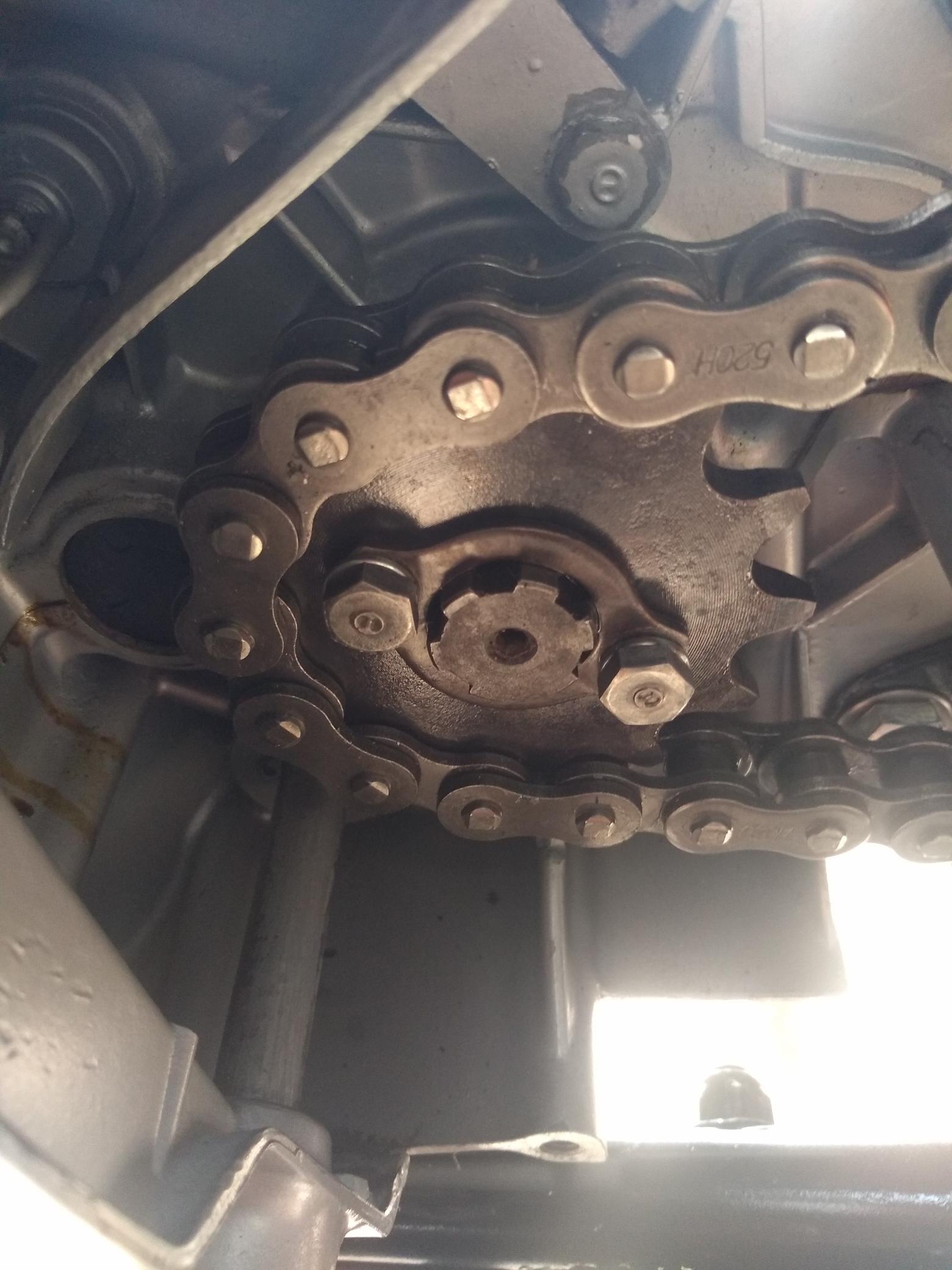

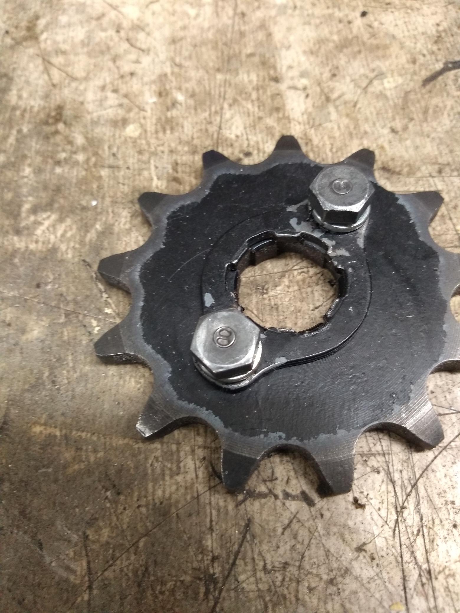

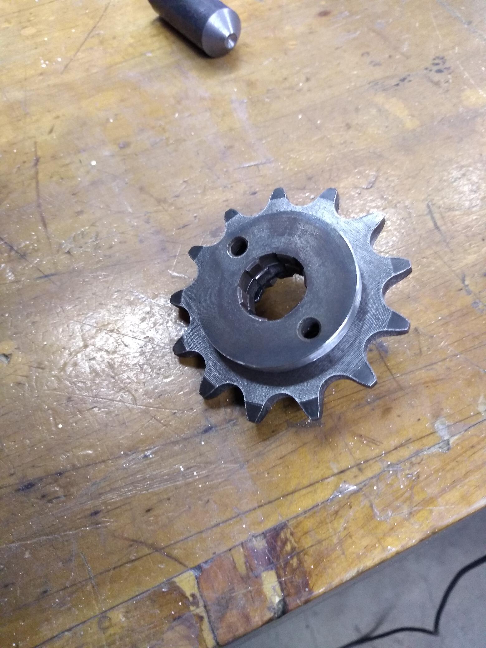

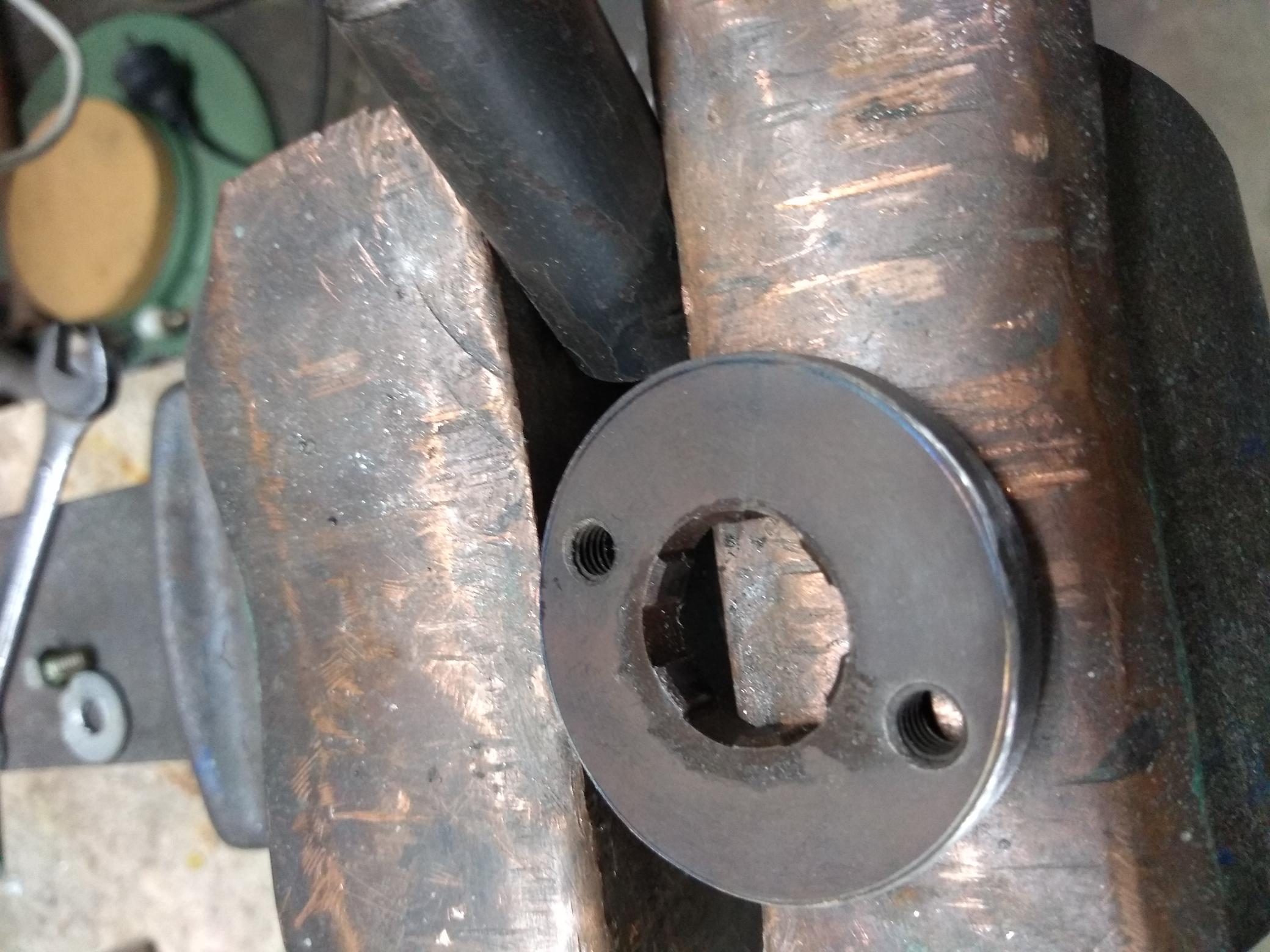

Final drive sprocket was a bit loose on the output shaft, not in the sprocket itself (one has to wonder why they do it this way) but on the shaft. Sprocket inner only covers slightly more than 50% of the available spline, other section never used.
So found an old sprocket (hard as the knobs of hell) marked out and ground away most of the outer section and epoxied this to the back side of the good sprocket I already had.
When applying the epoxy, outer(good) was turned on the spline so it took up the slack(just). After epoxy cured, clamped all up in the vice and welded the newly ground section to the back of the good sprocket. Had to dremel grind a small angle to the back of the newly ground spline to allow the whole assembly to go back(maybe additional 30 thou) to allow the front keeper to fit the provided slot.
Brilliant job, nice and firm again, better than new I'd have to say.
