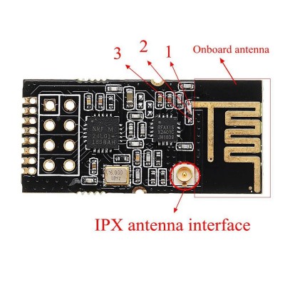

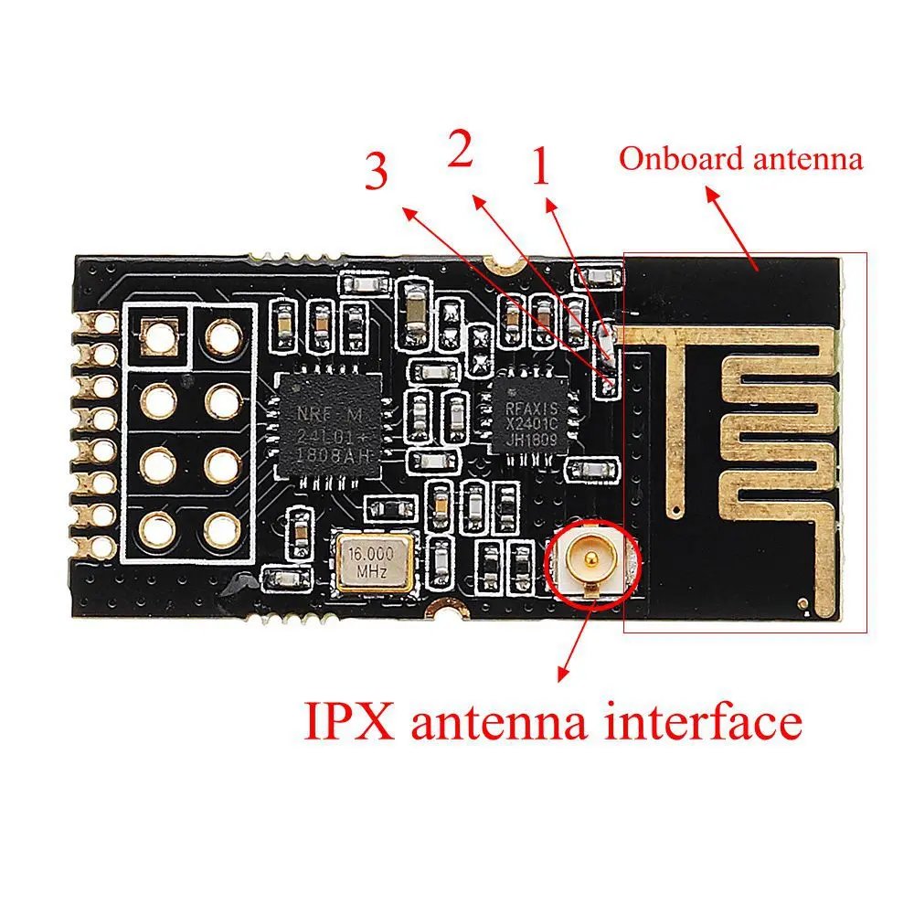

Anyone used these at all.
First saw them in use over at iforce2d site, imagine the same to set up as any NRF24 module..??
https://www.banggood.com/GT-24-Digital- ... ehouse=CN
GT-24-Digital-Wireless-Module-2_4G-NRF24L01-PA-LNA

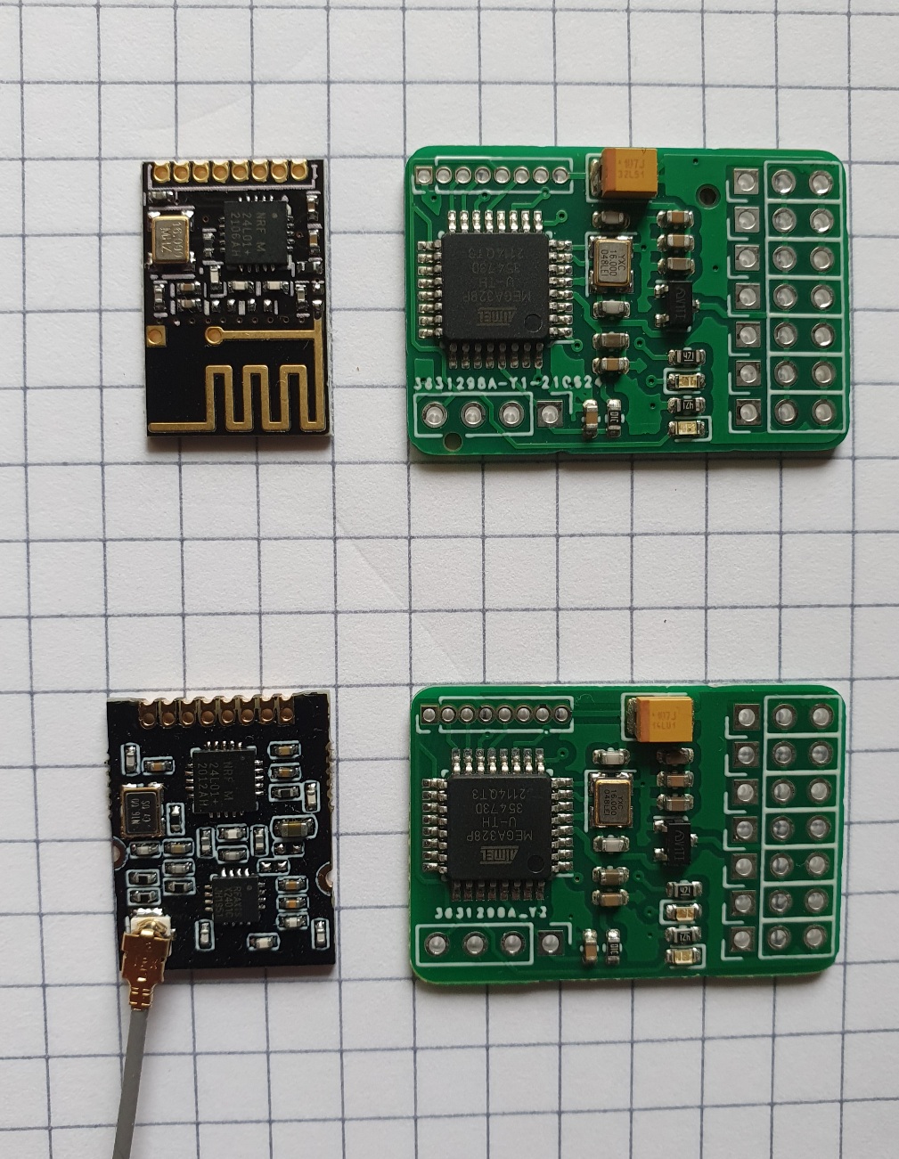

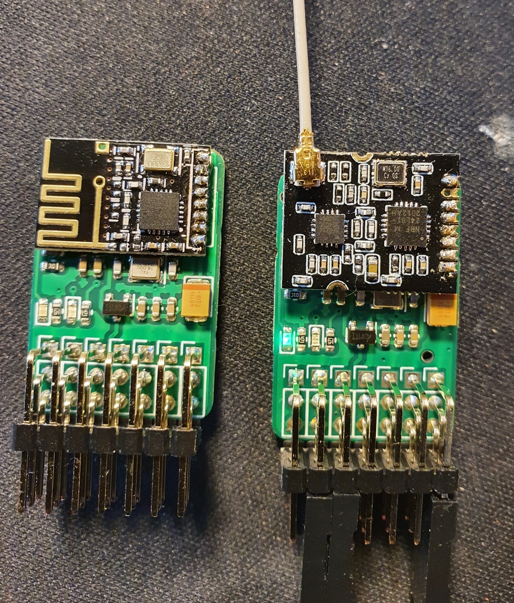

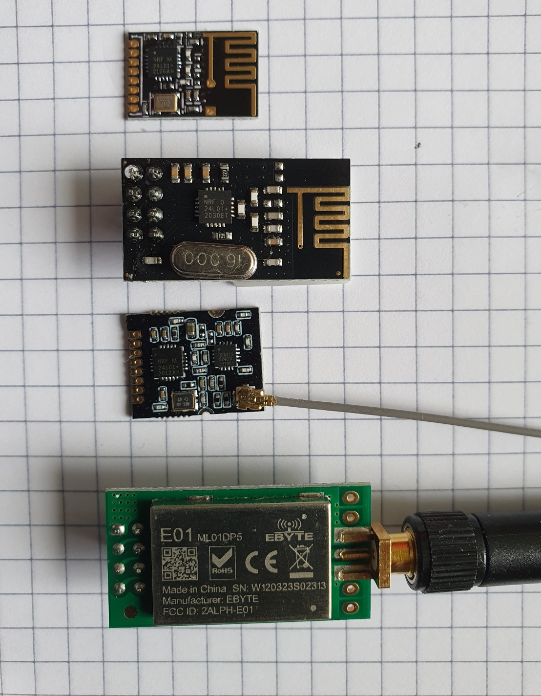

Thera are several versions of this nRF24 boards with and w/o PA as shielded and unshielded.
For Tx I use the shielded ones.
Here is what I use in my Rx, the one w/o antenna whip is for pure small models and I consider it a low range Rx as the antenna could be shielded by the main PCB but in trials I haven't seen any issues.
The second Rx with the external antenna is a full blown up Rx full range.
I have test flown this 2 and a few other versions and all works well.For Tx I use the shielded ones.
