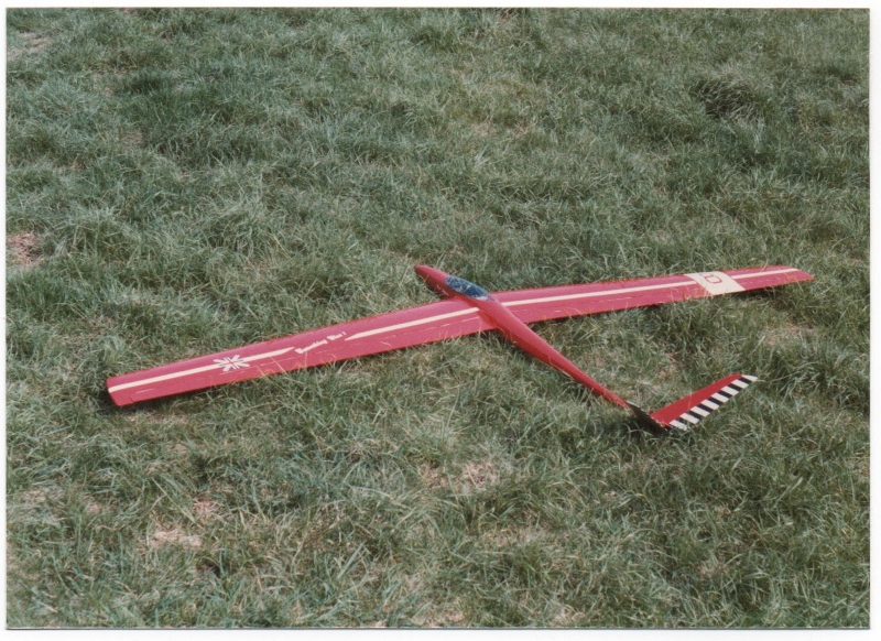

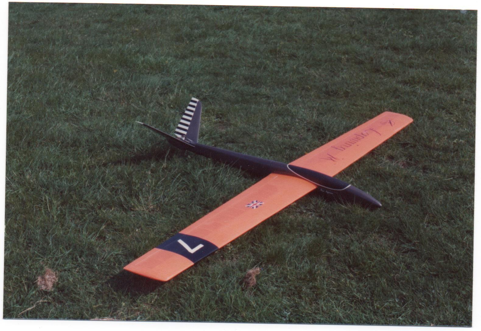

Sundancer thanks for your comments....... The included angle of the Corona's tailplane was 110 degrees. I can't remember the area but I think it was about 10%. I have built several V-Tailers in the past and all had an angle of 110 degrees but they were all slopers, mainly slope pylon racers and had no rudder function, just Elevator (with coupled Flap) and Aileron with zero dihedral.
The last (red) one was a not very successful thermal soarer but used Flaperons and Elevator but no Rudder. It had a very small tailplane and was quite controllable but it was too heavy. I think the Corona's tail was big enough but I suspect the wing could have done with a bit more dihedral....... Hindsight is a wonderful thing! Paul

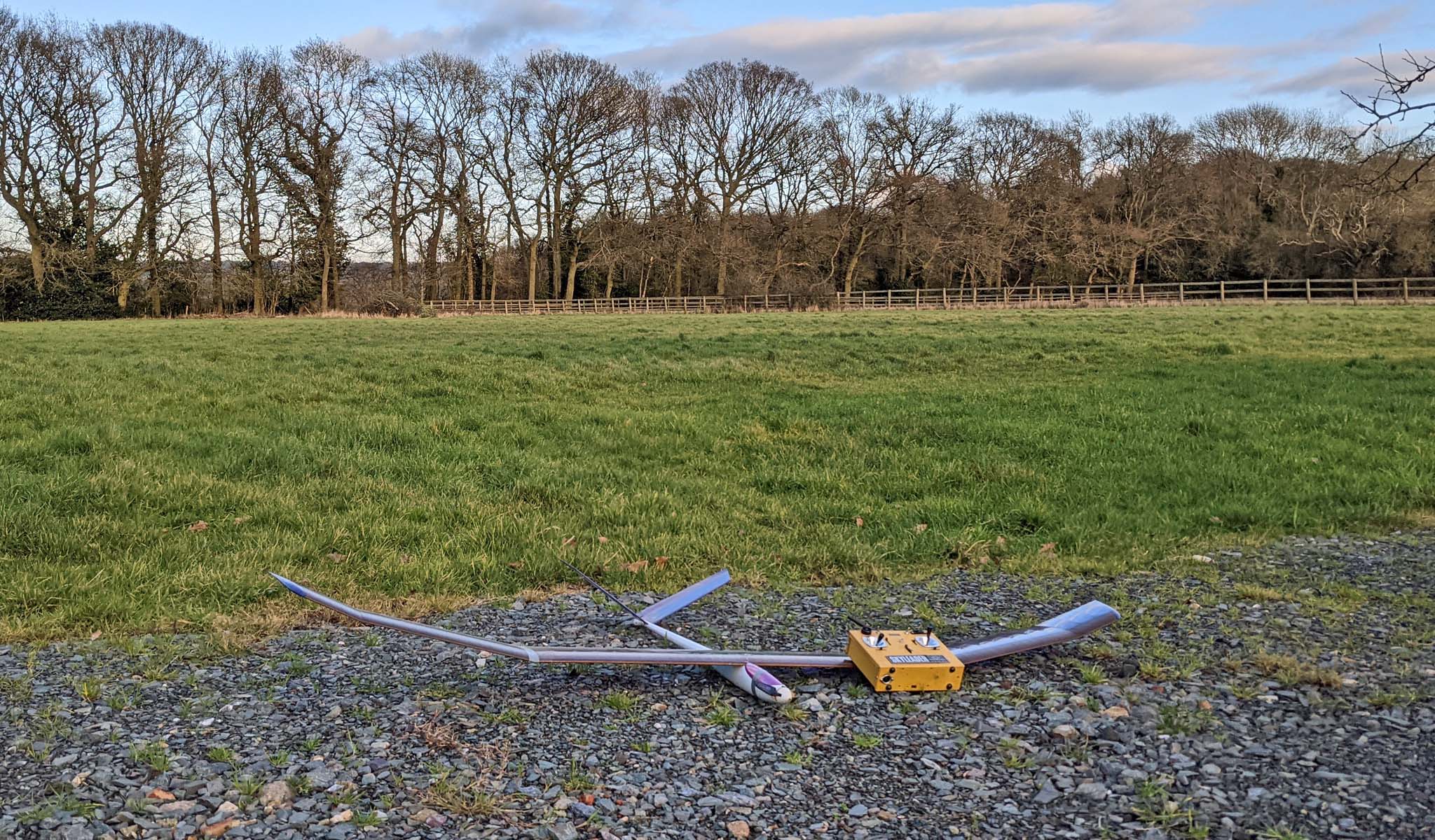

I was out flying today with my V-Tail glider, an FVK/Vladimir's Models "Simply-the-Best" and while flying a steep banked turn, I remembered the problem you'd had with your e-powered glider. I took a picture of it from a low down view, so you can see how little dihedral it has, there is none in the centre section and then one dihedral brake at about 50% span and another dihedral break around 90% span. Similar to yours, it's 2-channel rudder/elevator and flies as nicely as any other e-powered glider I've flown.

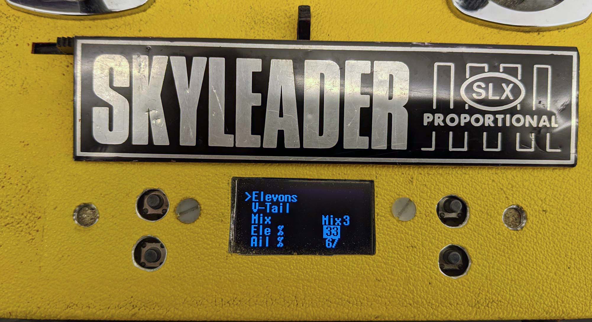

The setup is per the instructions, the cg is 35% cord and instructions say it can be between 30 - 40% and I tried adjusting the v-tail mix and 66% rudder movement, 33% elevator was the minimum I felt I had adequate rudder control (I know the transmitter photo shows an elevon, but as it's 2 channel and I want to use the aileron stick as it has to be elevon mix, not a v-tail mix). I wonder if your glider would benefit from a slightly more rear cg, more rudder movement and/or some additional dihedral at the tips?
Just for the record, there was a surprising amount of thermal activity around earlier today, though I was too rusty to hook up to most. From a 30 second motor run, I had a few 4-minute flights and a 9-minute flight. I hope you try and repair your model as it was good looking and I'm certain you weren't far off success.

Many thanks for this but sadly it is too late...... In the cool light of a few days later I had a good look at what was required to repair the Corona and decided that the fuselage needed a new nose grafted on and the wings were just too badly damaged and it needed new wings..... It had been quite a big build and frankly, I just didn't want to do it all again so I salvaged the hardware and burned what remained of the airframe. "You win some, you lose some......"
