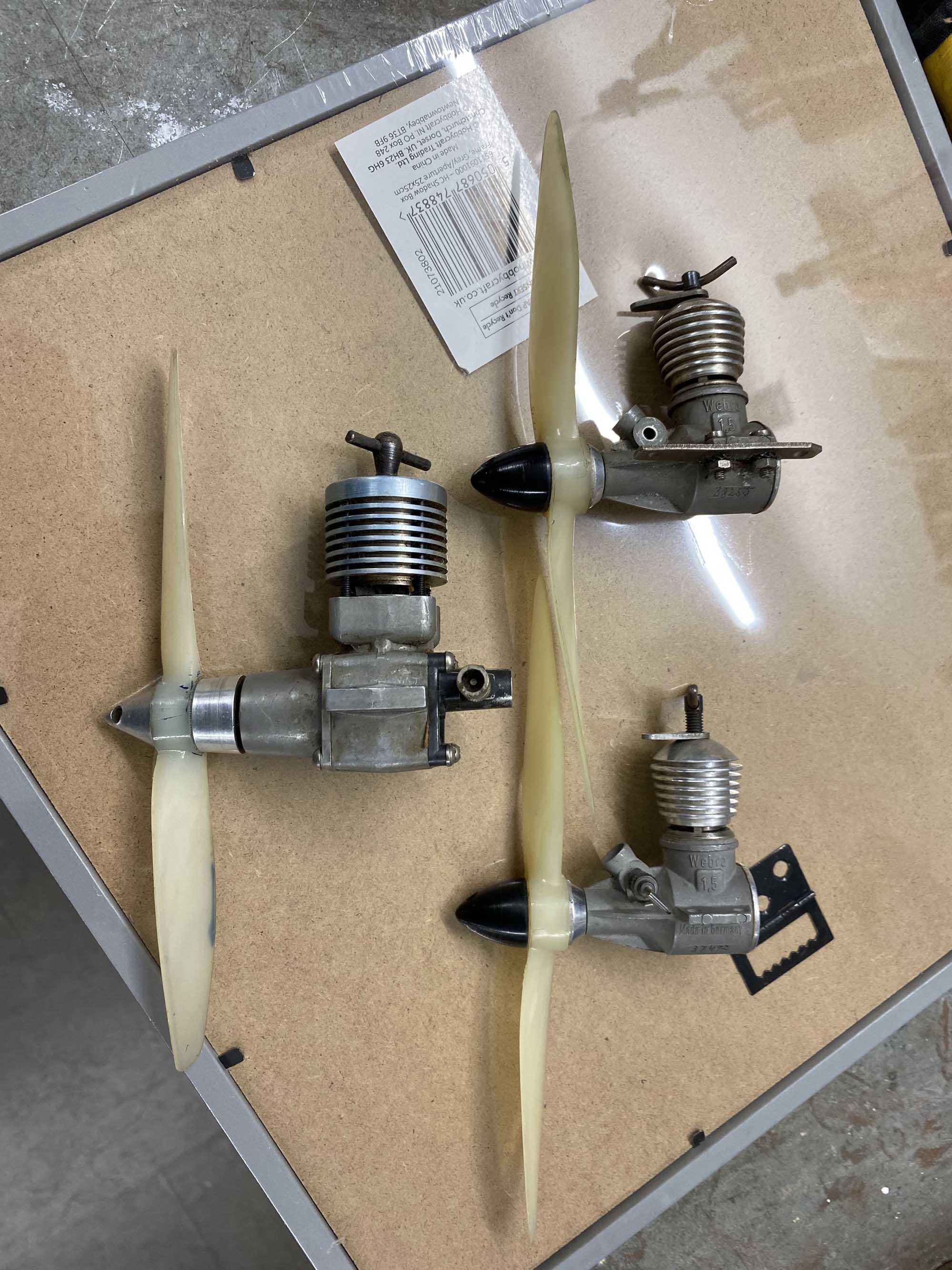

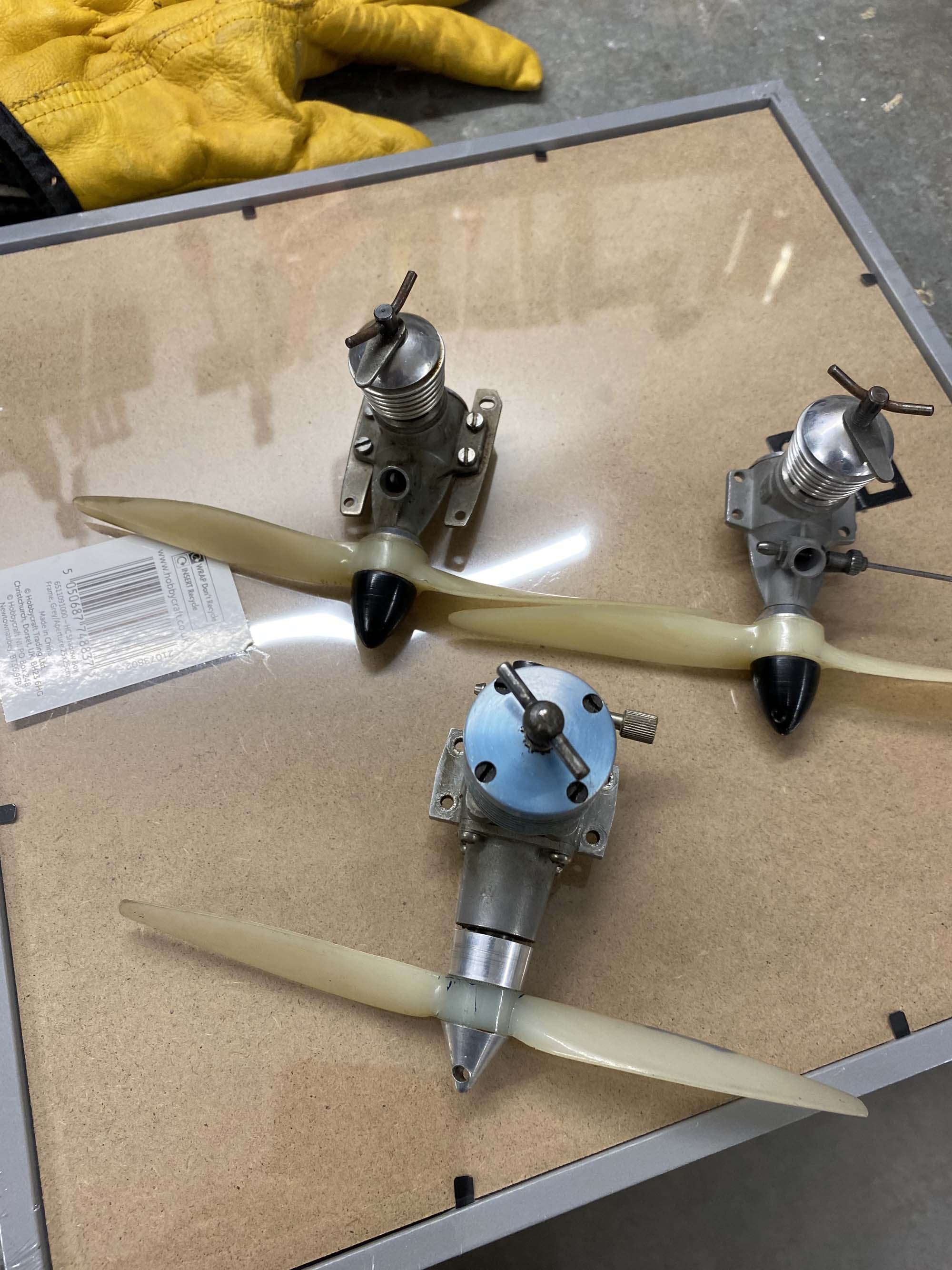

A few months ago a pal of mine, Rob, who isn't a modeller, was having a clear out and was going to take some old model diesel engines from his younger days to the tip. I said that was a shame and he said I could have them. They have last been run over 60 years ago in the Netherlands, have been well used, in control line models and have some lovely alloy spinners and vintage nylon and a wooden prop, plus a matching aluminium engine mount, which looks like it might be from a C/L speed model.
There's a pair of Webra 1.5cc diesels, one with no needle valve assembly and a rather nice ETA 15 diesel with a blue anodised head, rear venturi and black nylon backplate. I think I'm going to put them in a small display frame and put them on the wall, as I don't use diesels anymore and they don't have silencers or throttles -open port diesels wouldn't be very welcome at my club fields. I suppose it might be nice to give them a run before consigning them to display but I was doubting that they will fly again. I didn't have a lot of success with CL in my teens and I reckon I'd fall over after two circuits now, Nice things to look at though.
Following a thread that I started on the RCM&E forum, I've had some suggestions, had some offers to buy them, then got some diesel fuel from Leeds Model Shop, found some of my old control line tin tanks, dusted down my old engine test stand and plan to give them a wee run in the near future.

About the 'Dutch Connection'....
I do recognise the Webras as being from the ~1965 variety that had been sold together with an ARF CL trainer.
It was at a ridiculous low price at an Amsterdam dumpstore. Hundreds of them found their way into the Amsterdam clubs.
Most Webra Records we're running nowadays are still from that origin....
I got one at St. Nicholas eve (the Dutch version of Christmas presents).
Colours were like the Cox PT-19, yellow wing and stab, bright blue fuselage and fin, red wheels.....
The mounting strips on the Webra without spraybar and the props were the giveaway.
You can just see one of the four self tapping screws that connected those mounting strips to the plastic fuselage.
I learned to manage this little engine and afterwards taught myself flying CL with this model.
Time well spent, as only three years ago I concluded my 'career' as a F2B contest pilot.

Cheers Bri,
It was fun to get the engines running again!
To avoid traumatising the neighbours too much, I took the engines to our club field, and clamped the test stand to a B&D Workmate.
Webra#1 looks unused, and fired up without any drama.
Webra#2 was obviously not new, but over compressed and the contra piston was gummed in place. I did try to start it in the hope that the CT would break free, but no dice. It backfired, and the prop hit my hose-clad starting stick, breaking a prop blade.
The ETA 15 just coughed a few times and broke a blade just for fun, I think.
A 5 minute drive home, and a new Kavan 7x6 prop on the ETA. Webra#2 had the cylinder warmed with a heat gun. This was removed to allow access to the top of the contra piston. More heat, and some gentle tapping with a wooden dowel and rubber hammer saw the CP come free.
Back to the field, and the two recalcitrant units started and ran after a few minutes of messing amount with the settings.
The ETA is a scary thing......
Fuel used was Model Technics D1000, which dates backs around 3 years, but is kept in a tightly closed tin in a dark cupboard.
Fitting silencers or throttles to the Webras is liable to be a challenge.
Tim
