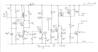

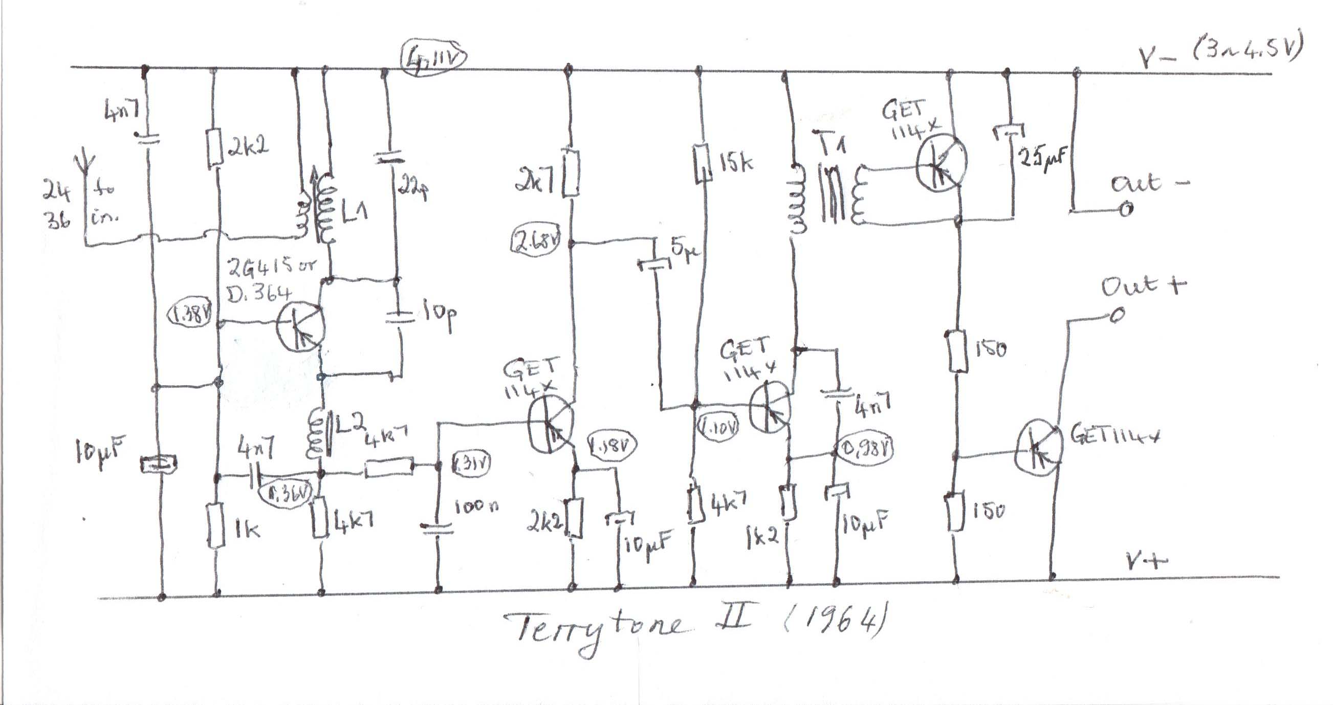

Hi All, I am back working on the Macgregor Terrytone two pc board I made. Now that I have the components list I have replaced all my guessed components for the originals and guess what - It didn't work at all. So I investigated with the scope and the signal gets as far as the third transistior base then stops. I checked around and there is no negative voltage on the collectors - I am measuring with reversed avo leads - i.e. Positive earth. I can't see how it can work as the collector of the third transistor goes to the primary of the what should be the ardente d1001 5:1 transformer but on mine is an audio transformer. and then to the collector of the forth transistor. If I short forth transistor collector to the negative rail it then comes alive and works. All be it still short range. A coulpe of feet only. Im using a macgregor 27 meg tone transmitter. the signal shows up quite well at the base of the forth transistor then is much smaller on the emitter follower. As said befor I have used available pnp silicon transistors BC557's the out put relay transistor is a germanium Mulard AC128. Apart from starting again using a propper ardente d1001 and all the propper germanium transistors I cant think what to do next. Has anyone any Ideas? I know these type of receivers did rely on a quite high gain ocillator (first) transistor to get it to super regenerate at all and it looks like from the data sheet that someone change a couple of small cap values around the first stage. A Mate of mine said that that kit never did work very well anyway and the only kit he ever built that worked well was a Kraft kit with very high gain first transistor, but i know they do work I'n obviously missing something somewhere. This project of mine is only for nostalgia and for me learning i bit more about the subject and a bench demonstration only and not for flying on. I have the excelent 2.4 set from Phil G for that. I do have a minimac receiver too and a Supermac relay rx. I would just like to know why the terrytone 2 does not work properly. If anyone can help like has anyone got a Terrytone two propper circuit diagram, I would appreciate any help. Happy Christmas all P.S. I have just found out that the short I put on to make it work should have been there all the time. I think my next move is to find a propper d1001 transformer from somewhere. I know they are hard to get. I may have to borrow one from my Rex boyer simpletone rx which works resonably well for a super regen. This may improve ther range somewhat. I will keep you informed. All good stuff. (Wiggles)

Here are the scematic of my Terrytone II and a Mc Gregor instruction booklet for the Terrytone receiver.
Xicon makes small 10k:2k audiotransformers at a decent price which are most probably suitable for your project, even though not as small as the originals.
I got some from Mouser:
https://www.mouser.com/ProductDetail/Xi ... e91g%3D%3D
Good luck with your efforts!

Hi jmp_blackfoot, Thanks for the Terytone 2 circuit and the other stuiff, most helpfull. All working now. Sorry about the slow reply. Kindest regards Phill W

Re: Pixie Mk2 Case - terytone two
