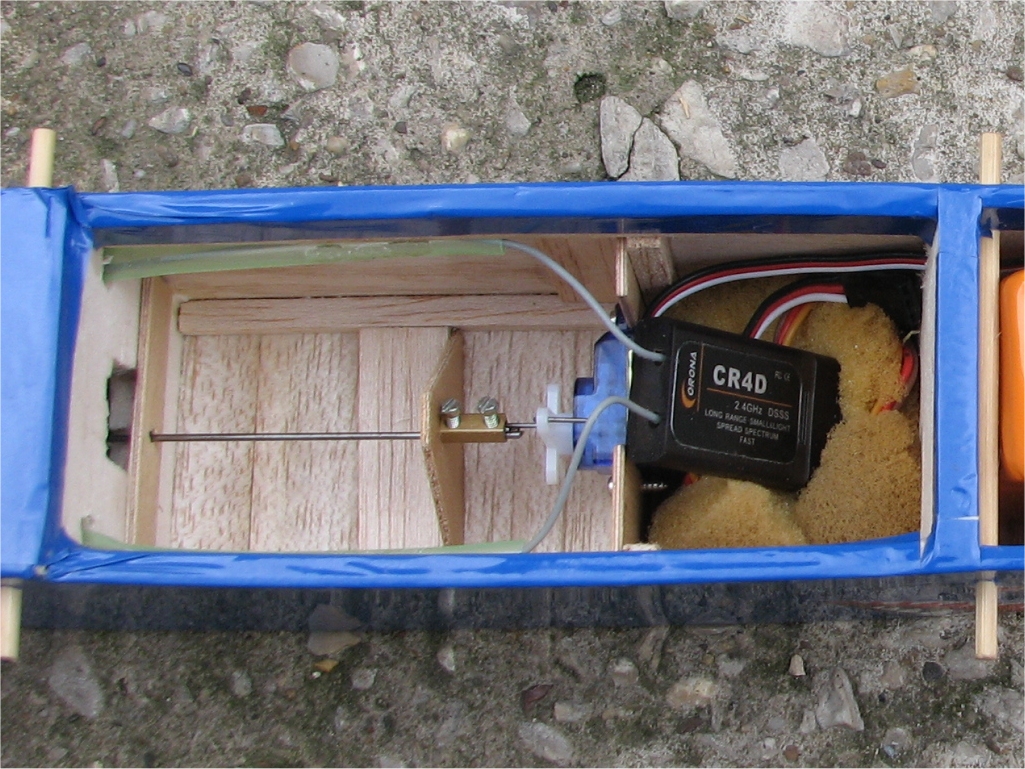

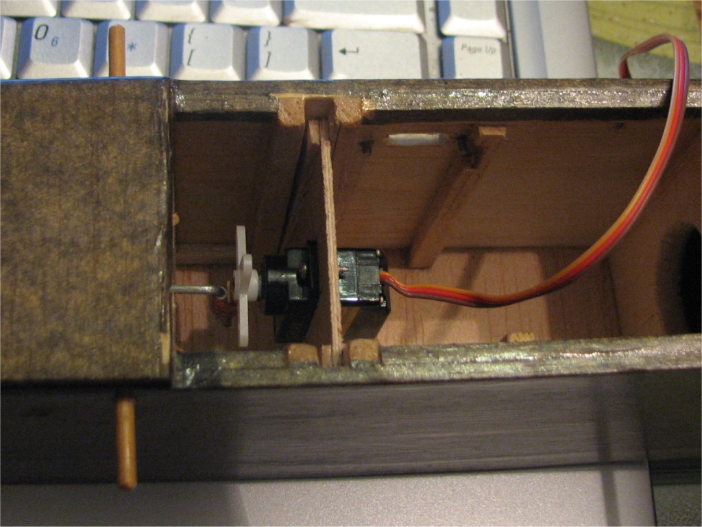

Just to confuse the issue, this is how I do it.......

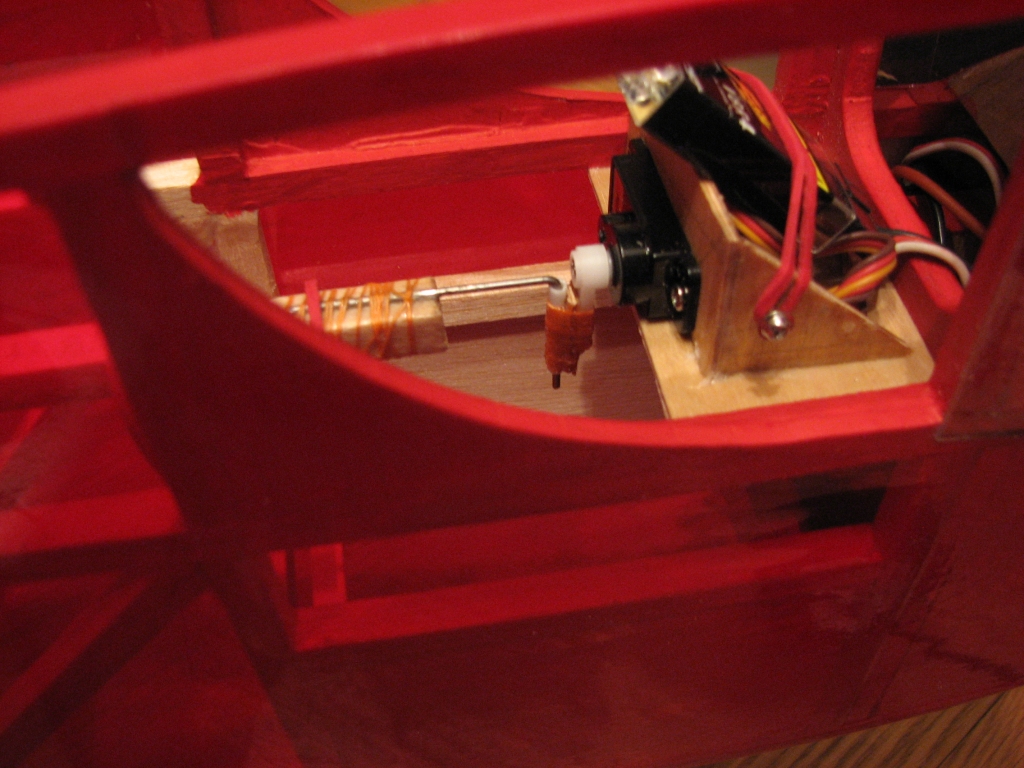

Loads of options. I just bind a tube (earbud stalk) to the servo arm and arrange it pointing down at neutral.
The torque-rod has a small bend vertically down and drops into the tube. Meercats :D
