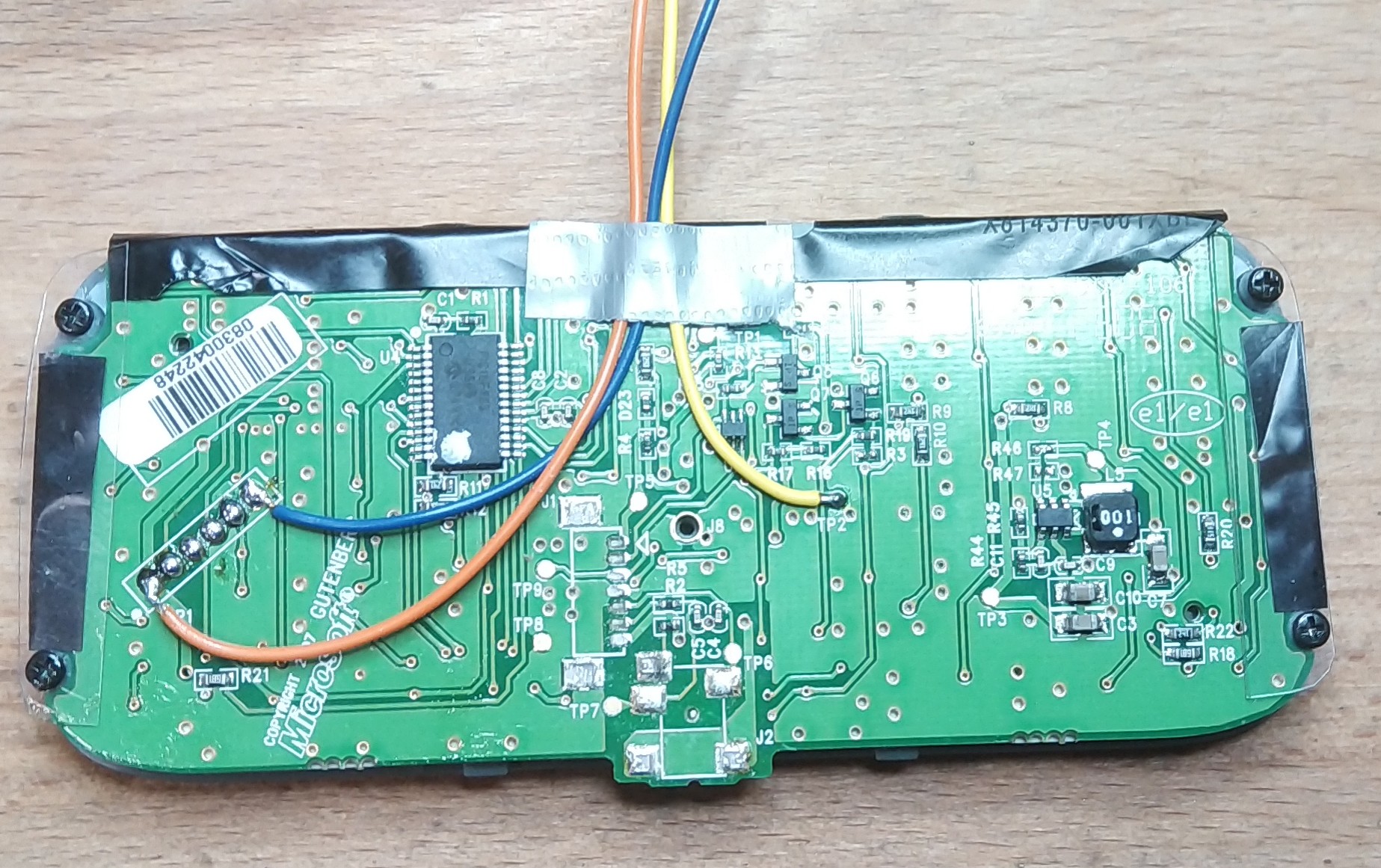

The ideal Chatpad for this mod appears to be from 2007, so its pot luck when buying used. The replacement firmware is hard-coded to 4800 baud, and for my NIBL board I needed 1200 baud, so set about disassembling and manually patching the hexfile and manually recalculating the new checksums, which was uploaded using a cheap Pickit3 clone. The result is a working 1200 baud version of the code [edit: also 9600, see below]. I removed the protruding earphone jack and the multi-connector so the board lays nice and flat. Note that I pick up the transmit line (yellow) from a pad labelled 'TP2'. Receive is not used.

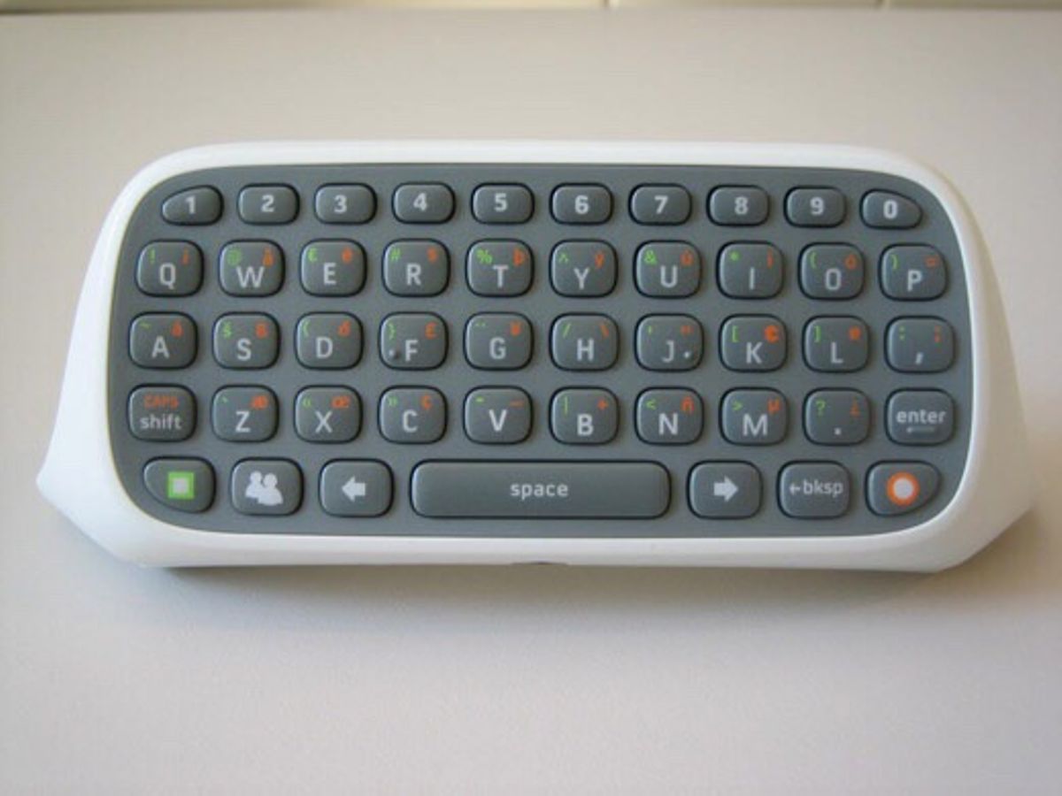

Please note that the keyboard firmware is Giancarlo's work, all I have done is a small edit of his hex file. A hack of a hack! The 1200 baud version is attached. It might be my Chatpad - after all its 13 years old - but whilst it works well, I do get occasional keybounce. Its an unavoidable compromise if you need a really tiny keyboard - and it does match the 4" screen perfectly Image

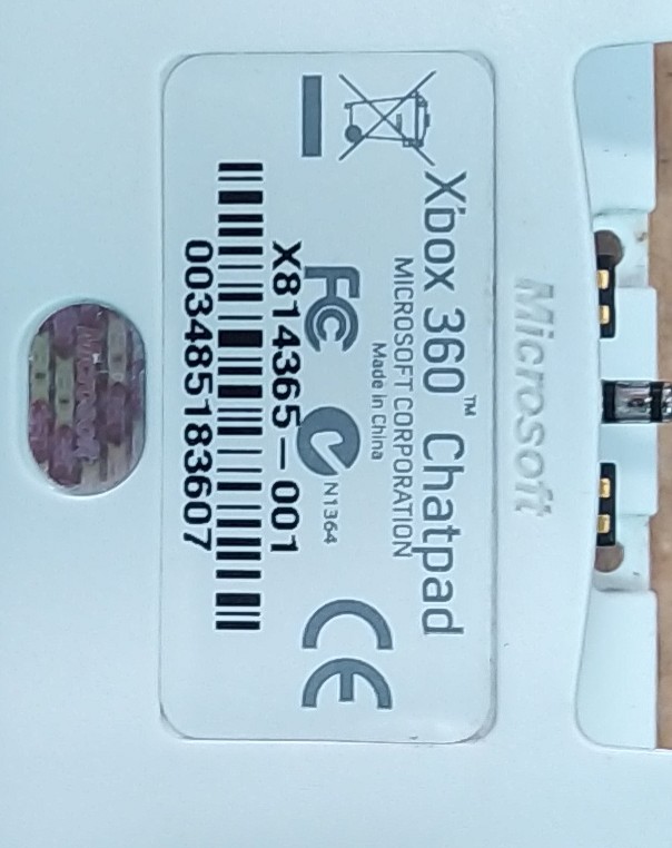

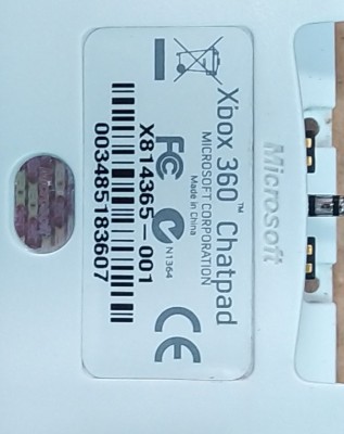

Yet a later edit, April 2021: If you look for the following label on the Chatpad, this will be the PIC version we need. "X814365-001" is the key thing to look for:
