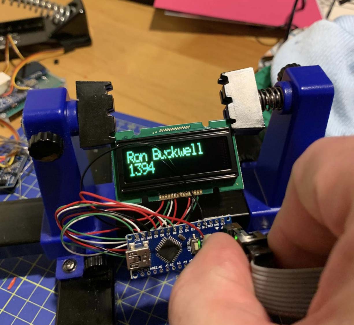

Managed to get the display working in alphanumeric mode,
Perfect for a PWM/PPM tester.
Its a lovely display, really small, OLED, very crisp, clear and CHEAP

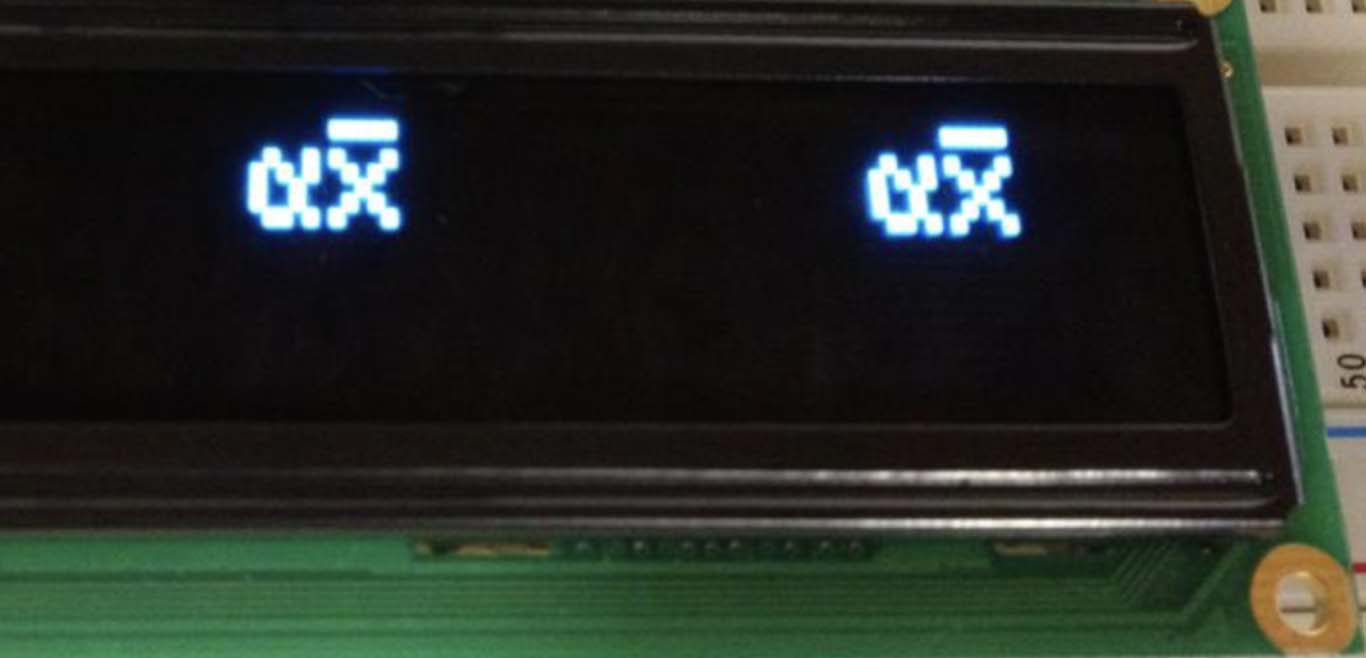

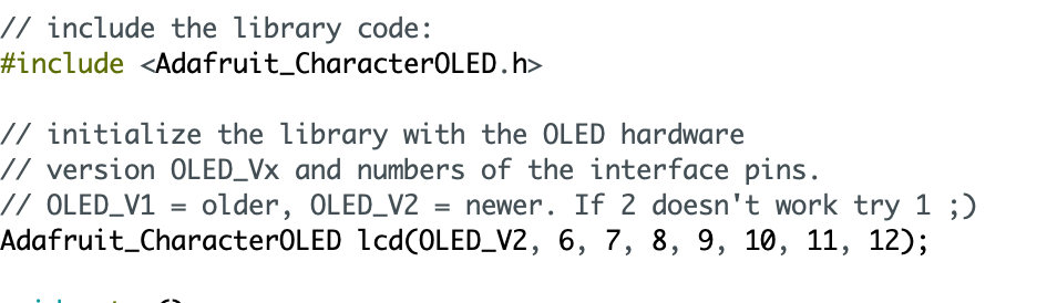

Heres an important bit of information for anyone using these 76x16 oleds.
If after uploading your sketch, you get either a blank screen or the Ax Ax characters on the screen then you need to use the V1 version of the library, like this...
From my observations, it only seems to happen with the Yellow OLED version but that's more than likely because the yellow ones I have are the older stock versions
Another point is both versions seem to like the OLED to be re-booted (completely powered down) after a sketch is uploaded.Once powered down and re booted, it works perfectly normal.
