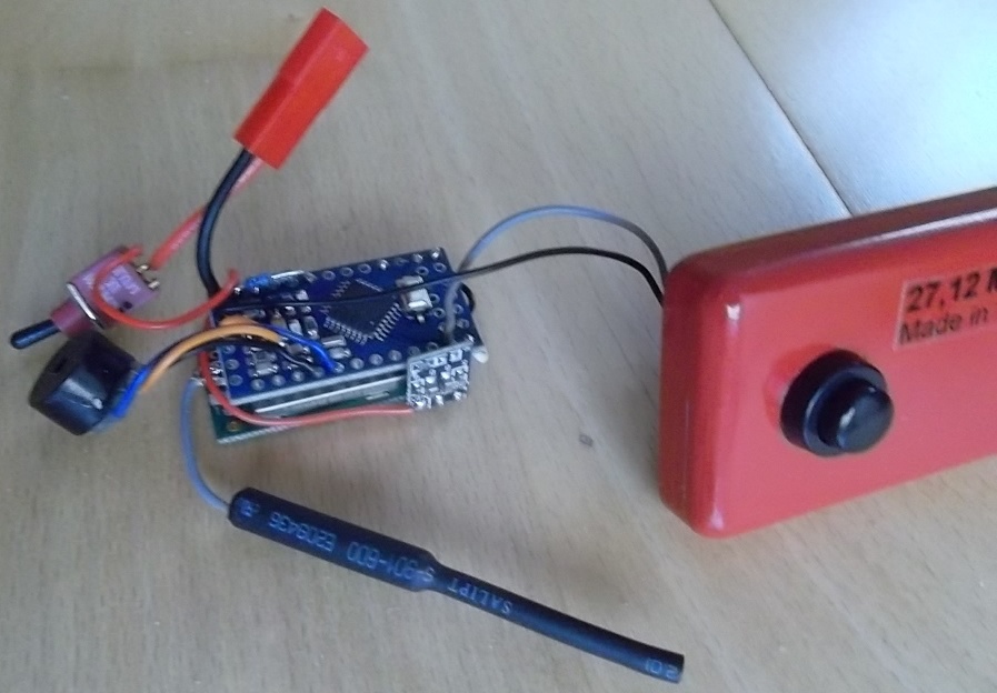

Thanks Mike, good to know... and Rich, his comments after 18:40 ring true with some but not all of my own 'open' modules - I've found screening helps the funny ones, I have several times noticed hand-proximity effects, usually making the signal better but sometimes making it worse!
The 'new' screened NRF versions show none of these effects, dont appear to need extra capacitors, and seem impossible so far to upset, and believe me I've tried, I've thrown everything at them and they carry on regardless. For me theres no doubt now, this was indeed a Eureka moment!
I left a pair running on soak test overnight last night, with logging to pick up any failsafe or resyncs - no issue, 100% all night long and still running now - thats about 18 hours solid. Yesterday I was constantly cycling transmitters & receivers trying to provoke a hiccup but failed dismally - a solid 200 packets per second all day long. I wish I'd realised from the start that screened versions were readily available!

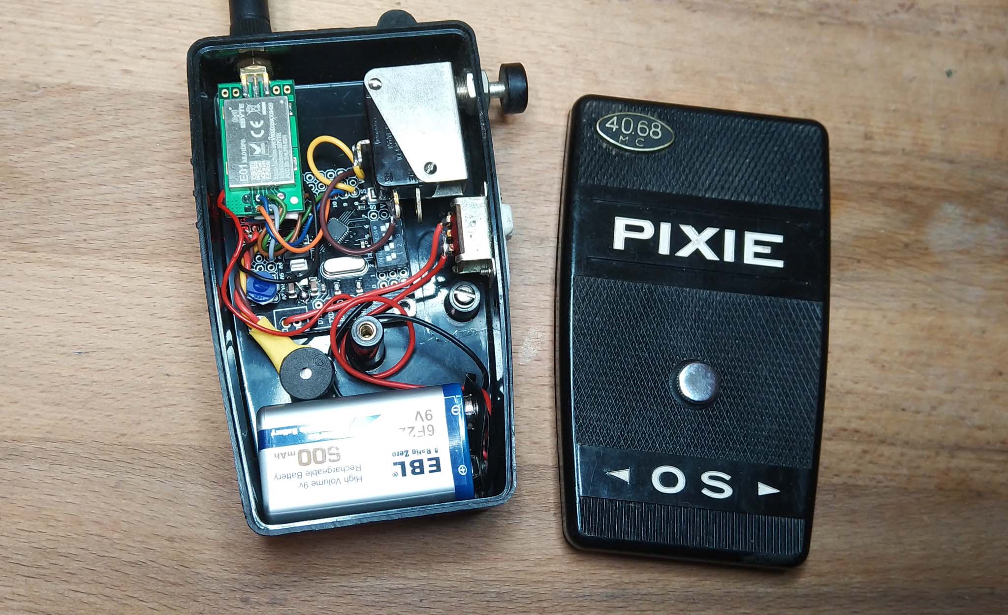

I've swapped out the 'open' modules in the Talisman, the RS Navigator, and the OS Pixie, and I'm going to do the model car transmitters next. I'm convinced the change is worthwhile. The OS Cougar still has an 'open' NRF set to 1mbps awaiting the range-test I never got around to - I will.
Heres the Pixie with its shiny new module, compare with the top pic above - kitchen foil consigned to the bin

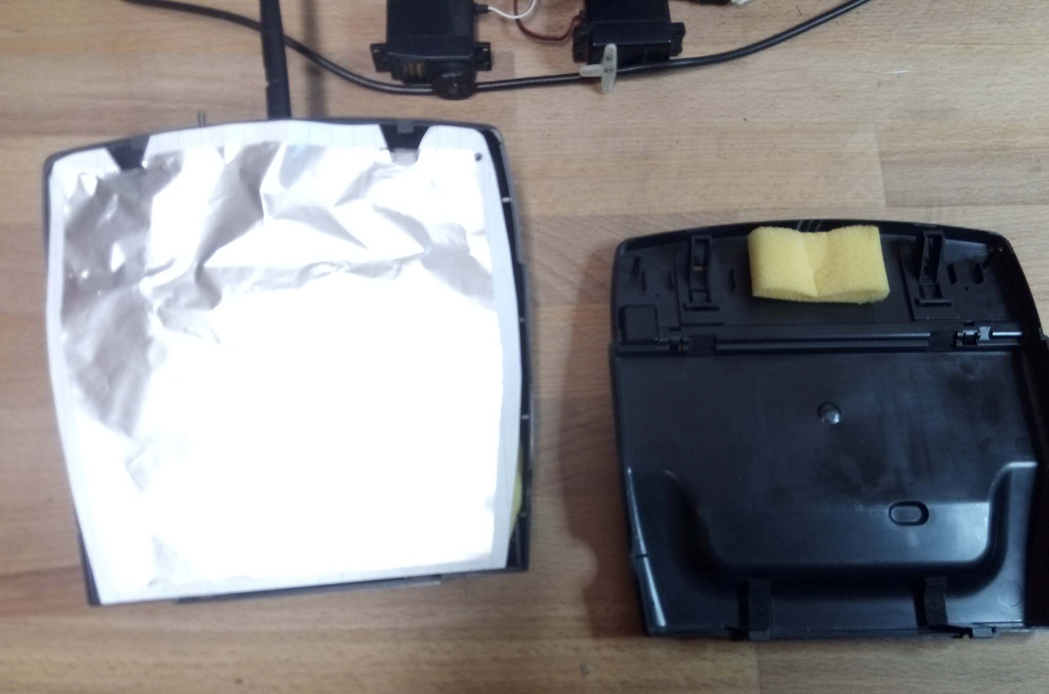

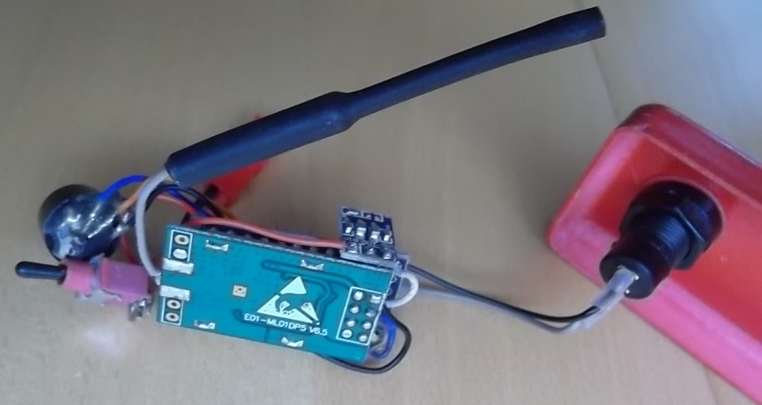

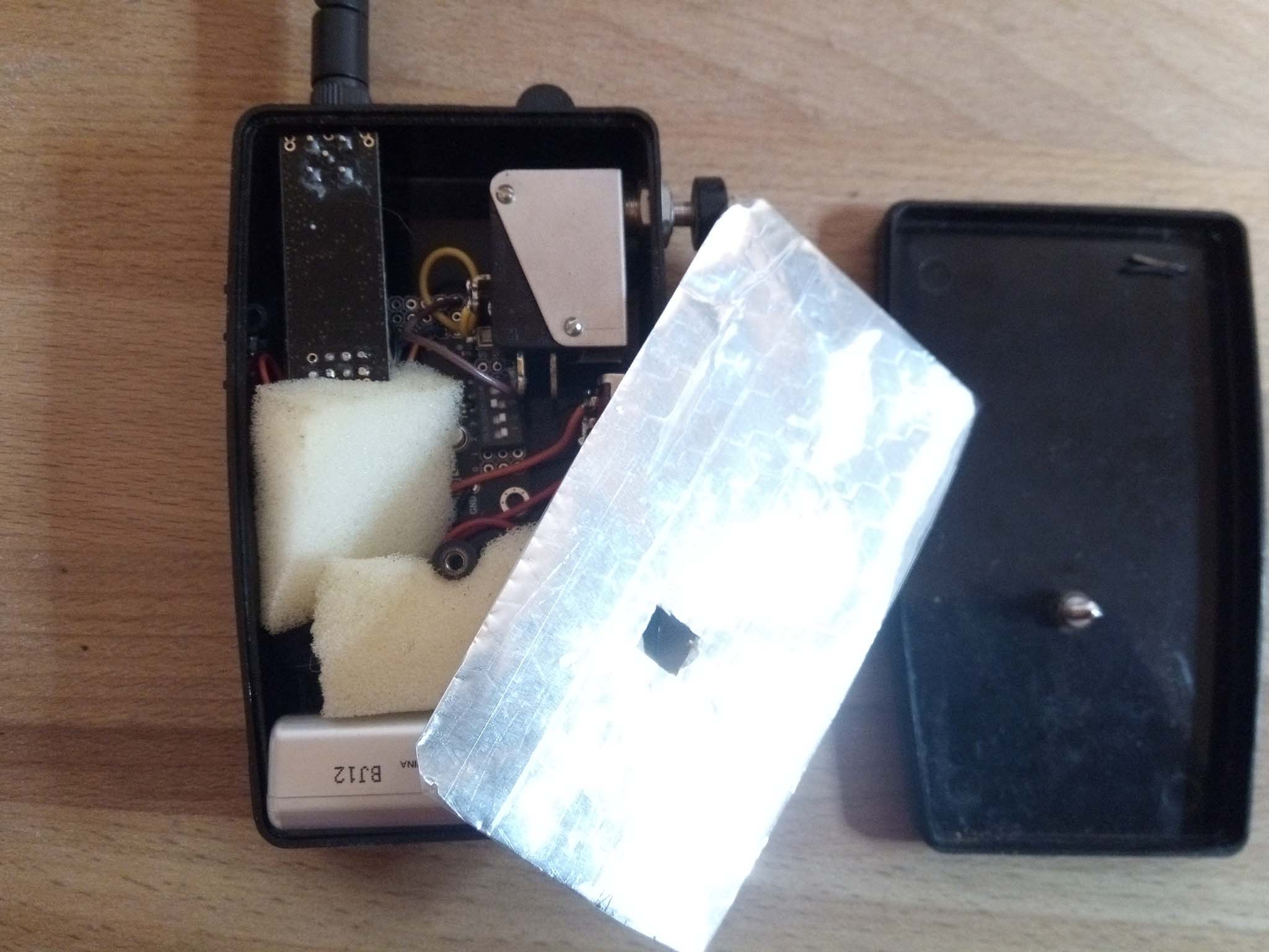

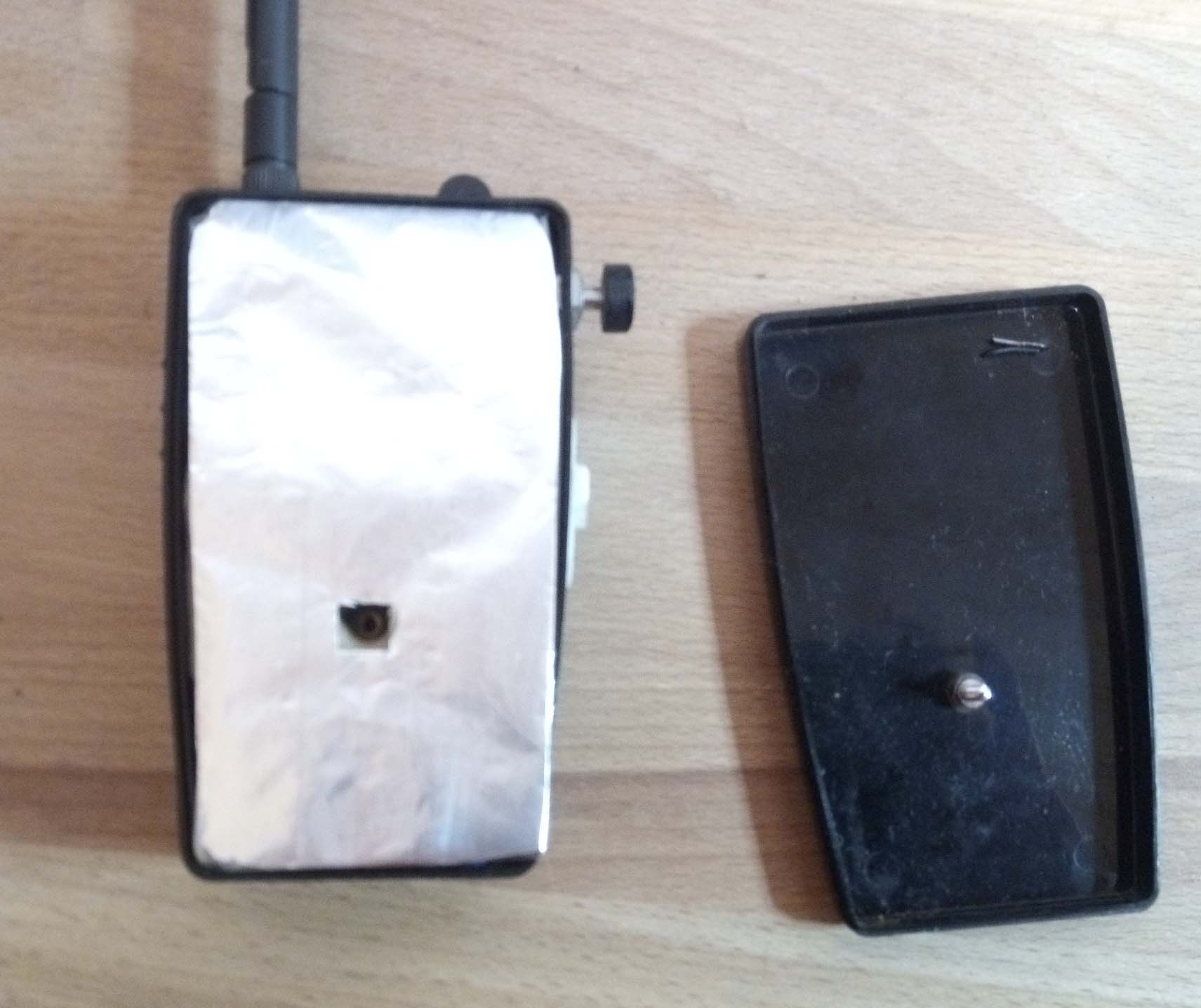

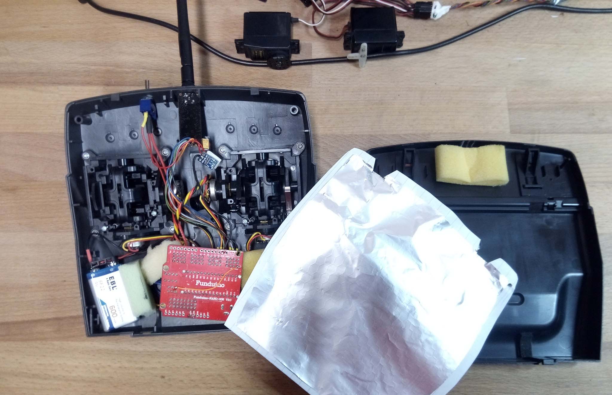

My Pixie and Pico both have a screen made from kitchen foil on card, and one of the car transmitters improved with a couple of copper-wire radials:iforce2d at 19:20 in the video wrote:"...I was wondering about whether the whip antenna was interfering with the actual radio board itself, due to it not being shielded... ... this is what my transmitter that I keep complaining about is set up like... the signal from the antenna is quite strong and can interfere with the innards of [the NRF] since its not shielded..."

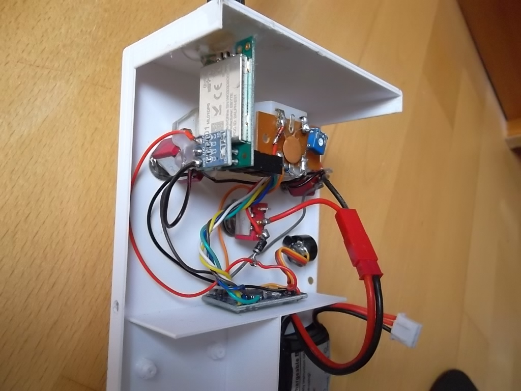

Now I replaced the tx module with the new shielded NRF24 version. Works great as expected and the instalation is more tidy as before. Frank

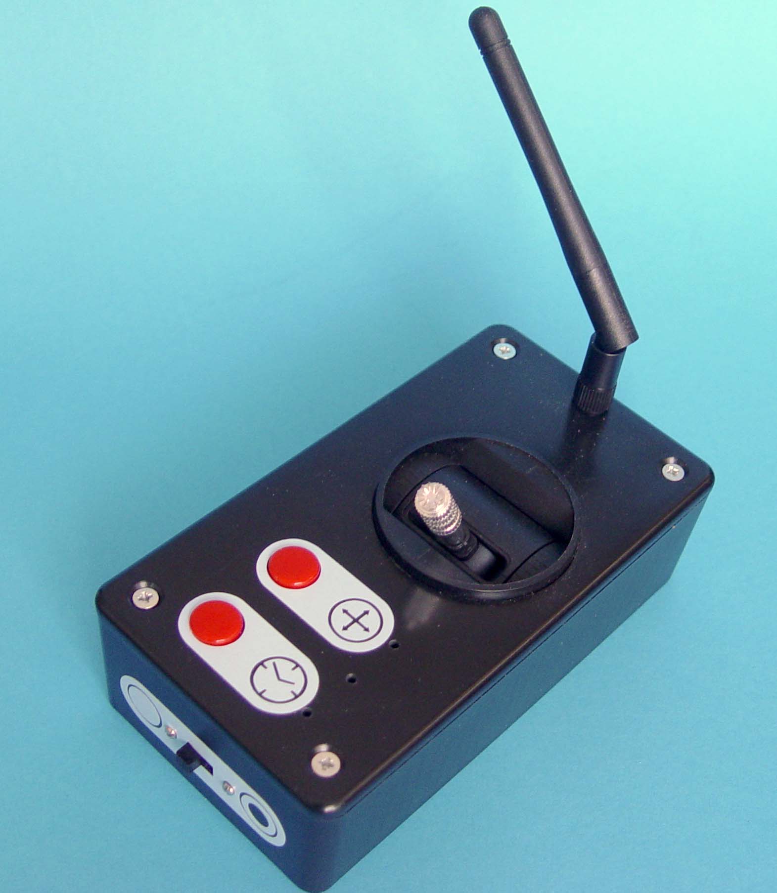

This is a simple S/C transmitter with only a few gimmics using the shielded NRF24 amd a promini.
It has full S/C compound incl. pick up elevator and three position sequential throttle plus inactivity buzzer, voltage alert and throttle led (not connected yet).
It is a very tiny block and will fit in an Engel Handy transmitter case in the original size with ease incl. a 2s lipo or a 9V block lipo.
My other Engel Handy replicas are all a little bigger to give enough space for either an Orange 2.4G module or a Jamara 35MHz module. They do not fit in the original size case. (75x35x35mm)
