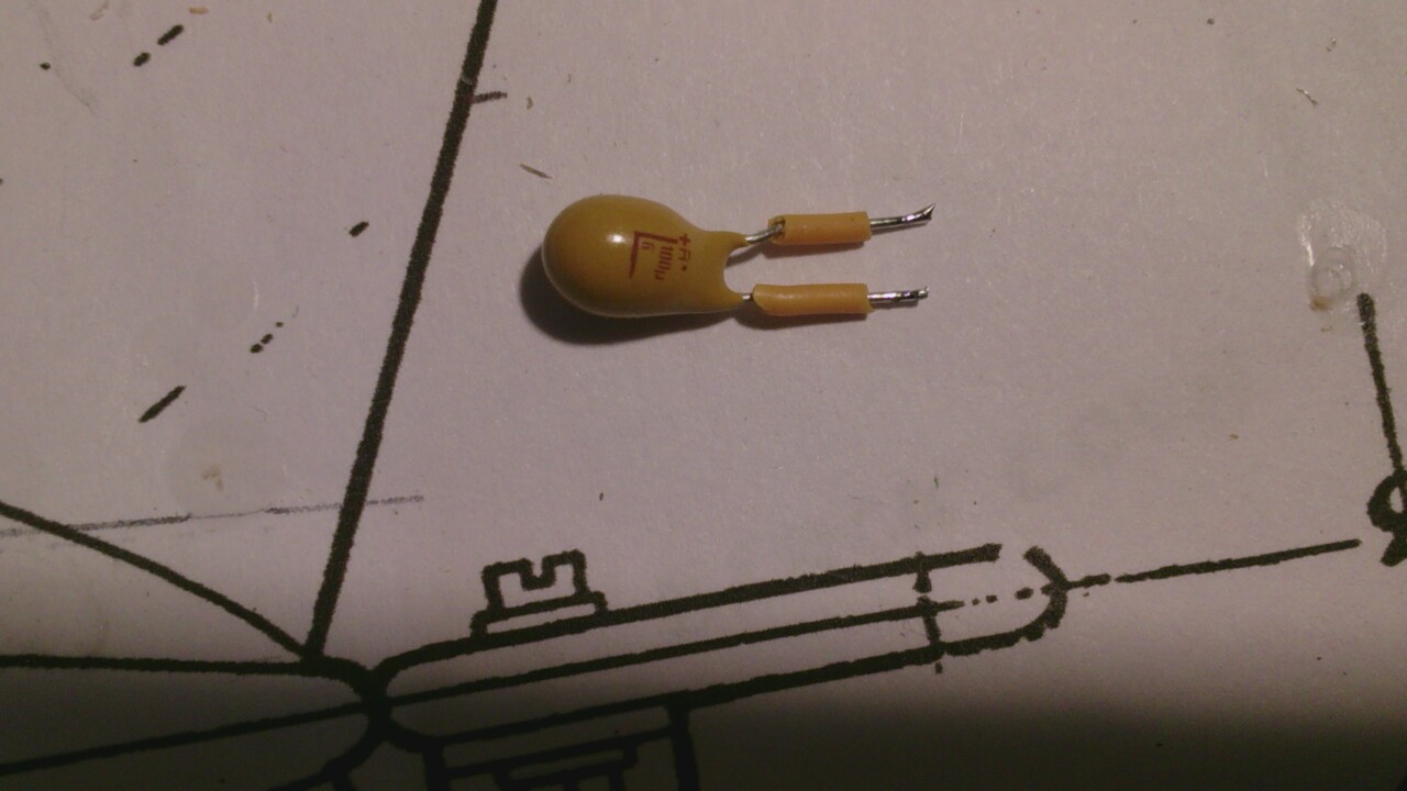

perhaps the 100uf is not the right one, pic attached.

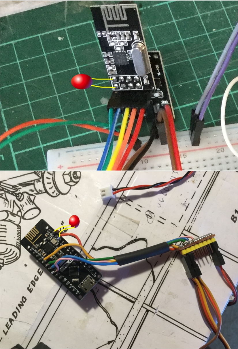

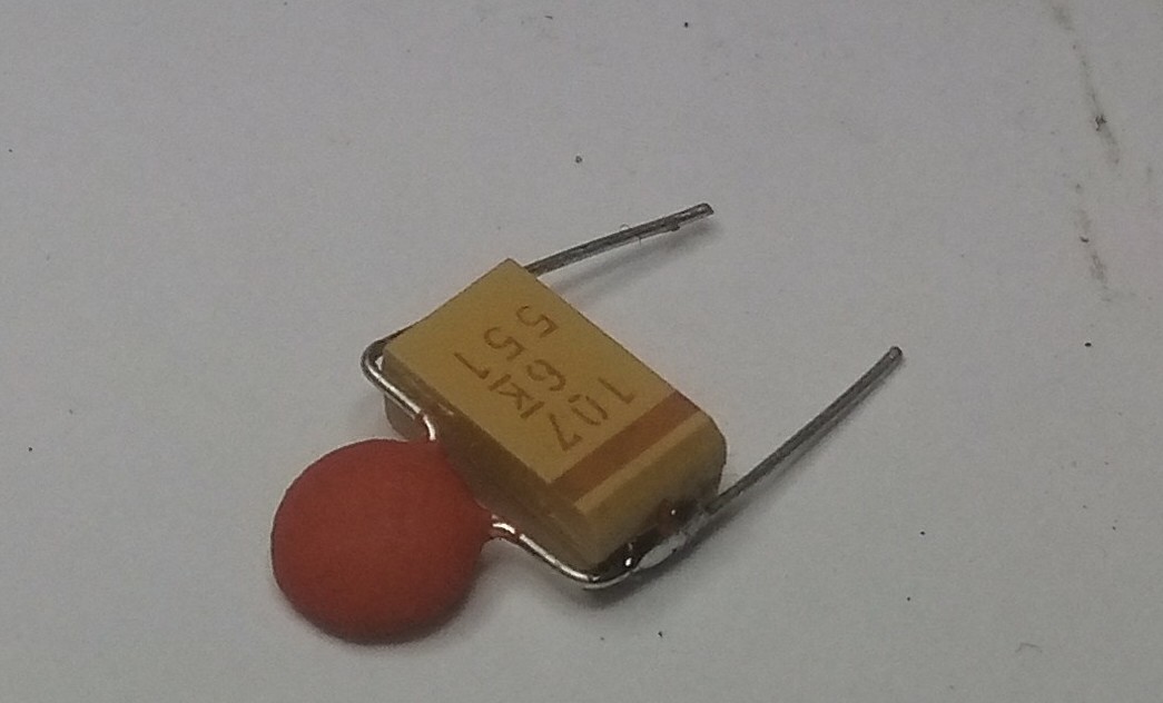

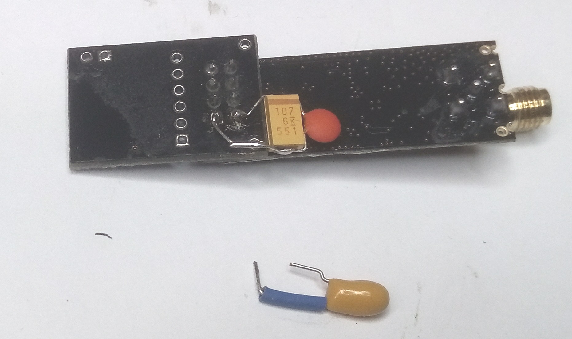

Today I put together another transmitter, and this time across the 3v3 pins used a yellow 100µF tantalum bead like Andys. On testing, it worked, but for the first time I had a lot of packets lost, the receiver traffic LED was very slow and there were was an occasional failsafe. I didnt have another module to try but it looked very much like the old 3v3 power problem again. I took the bead off and mounted an SMT 100µF in parallel with a 100n, directly across the 3v3 pins (pin 1 & 2) of the NRF module. It completely cured the problem to the extent that I had to check. I replaced the parallel combo with the bead, and lost loads of packets again.
I wanted to post this so to be absolutely certain I swapped the caps over three more times and its absolutely clear that with the bead alone, the power was not stable, and with the parallel SMT cap + 100n it was rock solid.
This is reminiscent of a problem both me and Ron separately experienced some time ago with LP2950 5v regulators oscillating. If you check the datasheets, many LDO regulators have a critical spec for the output capacitor ESR value, outside which the datasheet warns of instability. Consequently all my PIC encoders have a TAP226 controlled ESR tantalum on the LDO output. The AMS1117 datasheet however gives no specific esr requirement, only that the cap forms part of the compensation loop.
Despite this I am almost totally convinced that this is a similar problem. Until today I've used the SMT + 100n combination and had no trouble whatsoever. Maybe its RF induced into the DC, or ripple caused by the pulsed-current-burst nature of packet systems - this was a 'proper' NRF regulator board BUT these reg boards sell for 25 pence, who knows if its a full-spec AMS1117 or a chinese ripoff.
Its probably not the bead itself but the 100n that makes all the difference.
The first time I use just a bead alone, I get the exact same symptom as Andy.
Replace the bead with the SMT+100n as in the pic below, and its rock solid.
Swap back and I get packets lost. This is endlessly repeatable.
You may find just the tantalum alone has been ok, but I'd definitely suggest adding a 100n in parallel.
On the transmitters I've found its best to take the battery neg and switched pos wires first to the RF module regulator and then on to the processor, and to avoid taking the RF module neg 'through' a Nano - ie not to take battery neg to one Nano GND and use the other Nano GND to power the module.
The 3v3 regulator (for the RF module) I always power from switched battery, not from the Arduino 5v.
I use an adapter rather than the six-way ICSP pads underneath:
viewtopic.php?f=41&t=661&p=5124&hilit=adapter#p5124
