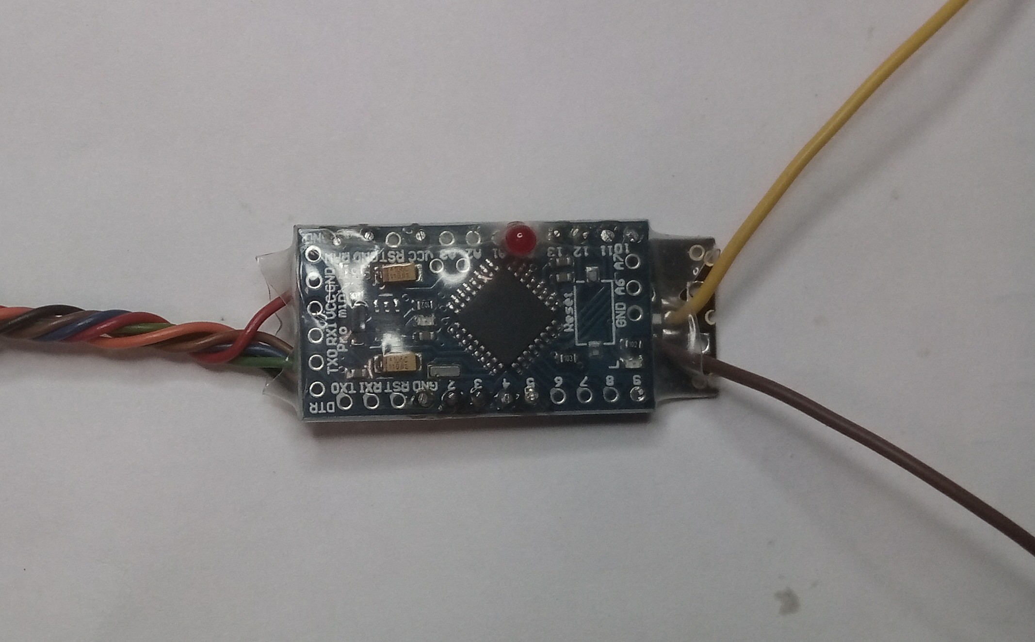

I made a couple more 8mhz/3v3 Promini+NRF receivers yesterday as I'd run out of RF-Nanos, not sure which I prefer - the made-up ones are free cos Tobe sent kindly donated some NRFs and Prominis!

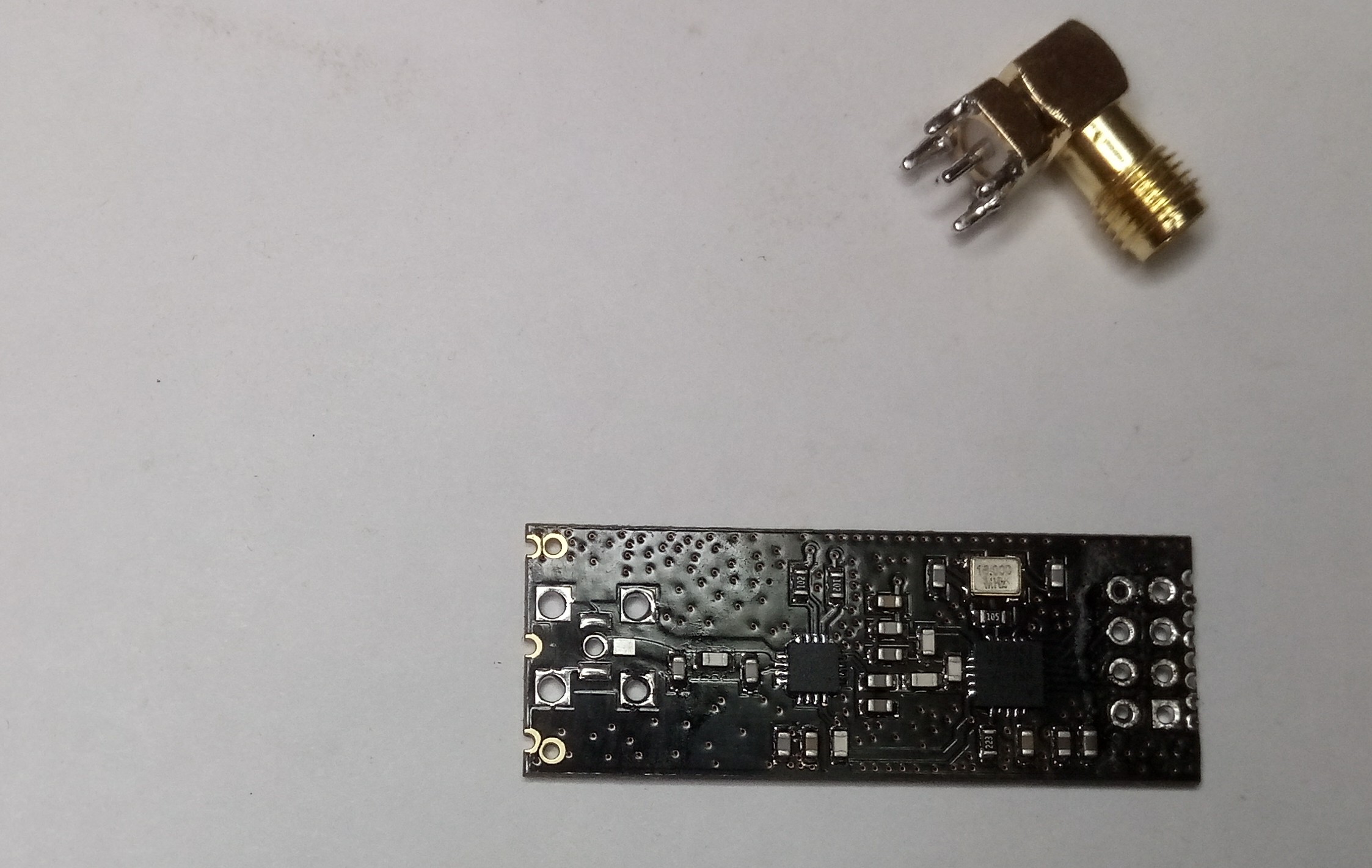

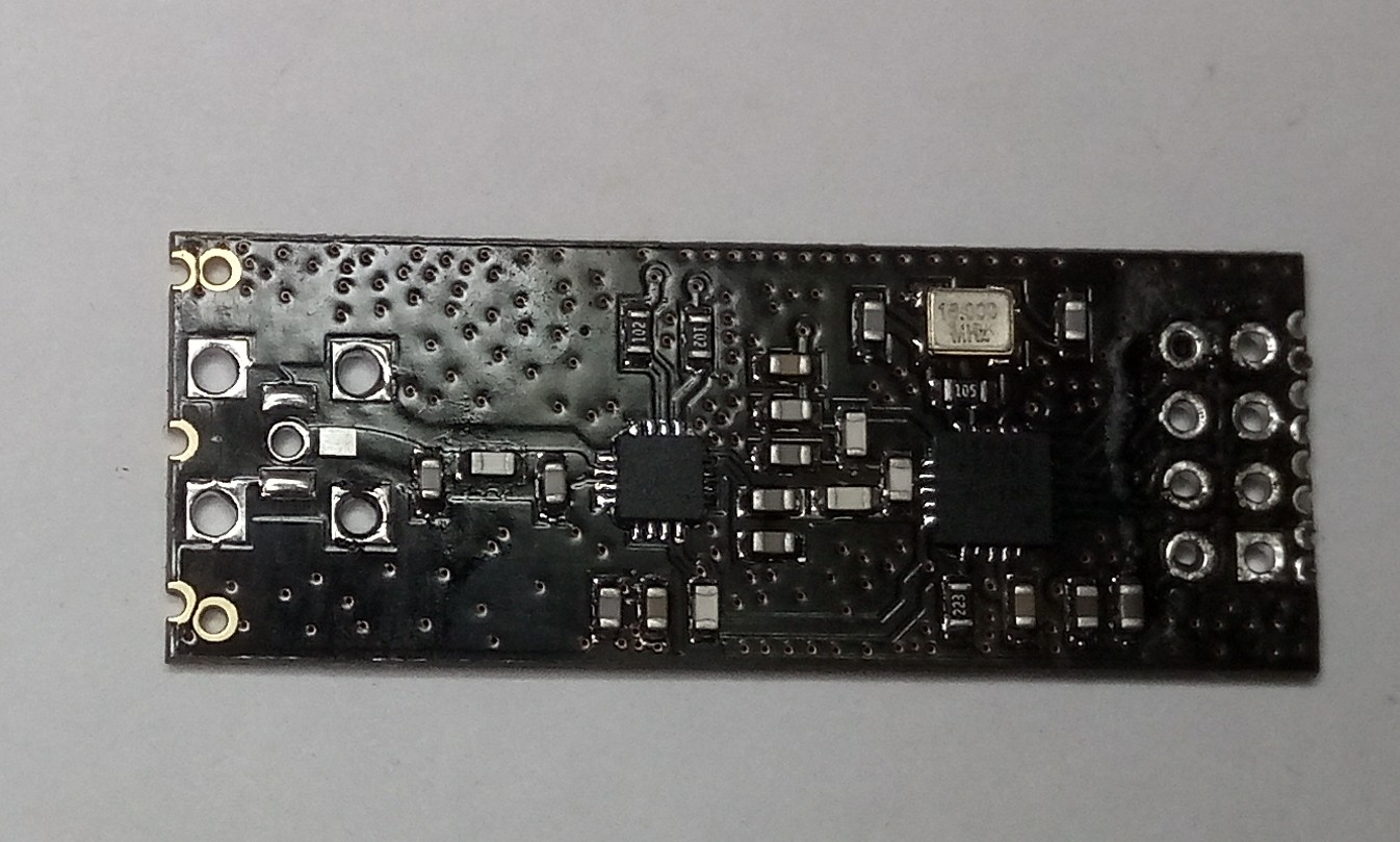

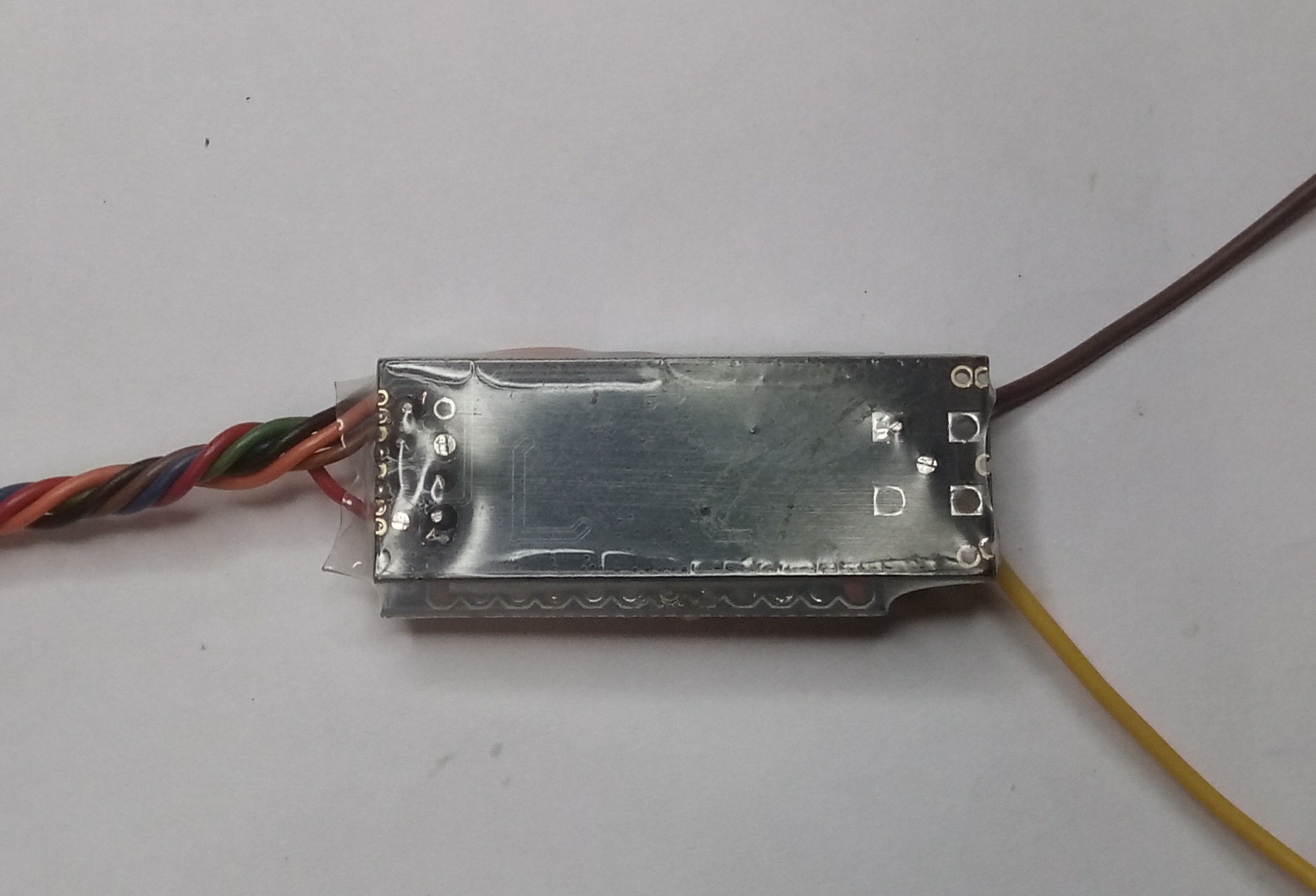

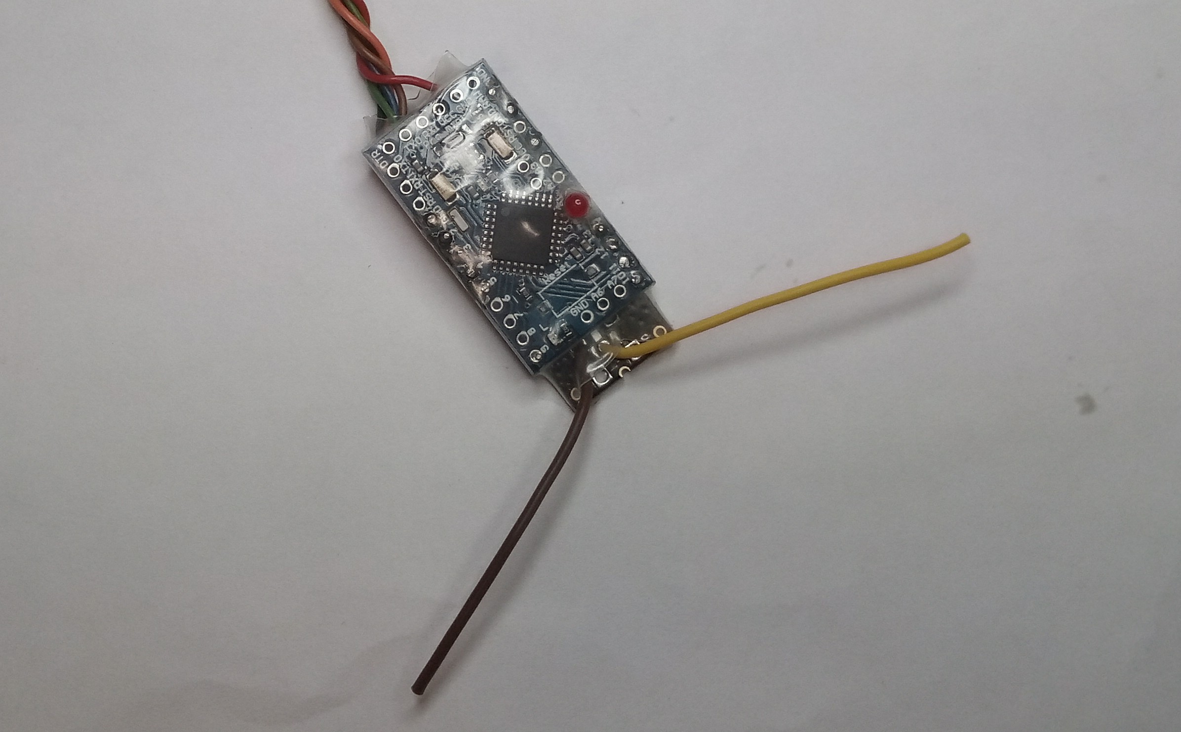

OK heres a receiver made with the "+PA+LNA" module that so far we've been using for the transmitter.
I've removed the SMA connector and soldered two 33mm whiskers, which with the LNA I want to compare against the PCB aerial. Works great on the bench but no range tests tonight, its raining pissinstently
I've rearranged the layout of the boards since taking the photos above, with the NRF groundplane between the boards so they're screened from each other. Minimum-power range tests seem 'at least normal', possibly better, hard to tell in the rain! One of my test transmitters has the bare NRF24 (no PA) and its set to the 'low' power setting (-12dbm or 1/16th of a milliwatt) and with that tx I'm getting about 30 metres in the rain

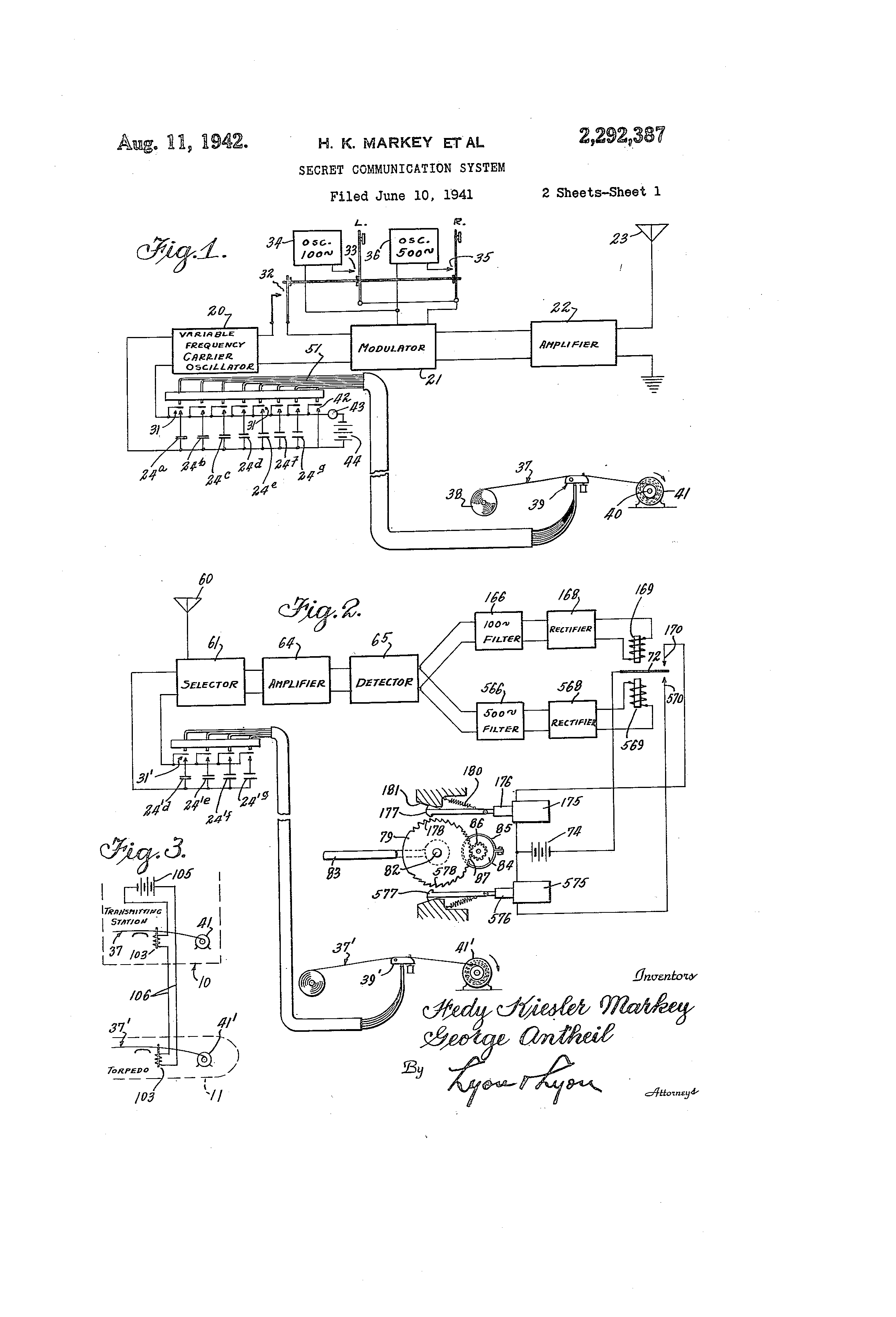

Did you know that American actress Hedy Lemarr invented frequency hopping. She was working on a system to stop radio guided torpedo's from bring jammed.
Beauty and bains eh!

A myth perpetuated mostly by R/C enthusiastsShaun wrote: 06 Jul 2020, 09:52Did you know that American actress Hedy Lemarr invented frequency hopping.
Truth is that both Marconi and Tesla beat her by 4o years
There were several methods of keeping two distant distributors in perfect sync, telephone exchanges relied on it
I'm a big believer in credit where its due, and the Lamarr/Antheil patent did include one of many methods of achieving frequency hopping (paper tape driving switched capacitors) but they absolutely did not invent it, there are several prior patents. The first I'm aware of is Nikola Tesla who described a method of discharging different value condensers into a resonant coil at periodically-recurring intervals via a rotating wheel in his 1903 patent US723188... he didnt use the phrase "frequency hopping" but the concept is there in 1903
Their 1941 patent was a combination of frequency hopping radio (which is one form of spread spectrum) and an associated escapement system for the remote control of a torpedo rudder. The modulation was what we would loosely call 'reeds' - simple amplitude modulation with a 100hz tone for left, or a 500hz tone for right - with tuned filters at the receiver. Essentially the simple frequency hopping element is almost identical to Willem Broertjes 1929 patent, as you can see from the scan above, switching different capacitors into a tuned circuit in sequence. The Lamarr/Antheil contribution was the application of this existing concept to secretly and securely guide a torpedo
It was never implemented.

But nobody at Marconi or Tesla were as good looking and
Tesla only alluded to it. She got the patent!

Yes frequency hopping was quite old technology by the 1940s. What she did was to combine frequency hopping AND spread spectrum. Where have I heard them two being used together?Shaun wrote: 06 Jul 2020, 09:52 Did you know that American actress Hedy Lemarr invented frequency hopping. She was working on a system to stop radio guided torpedo's from bring jammed.

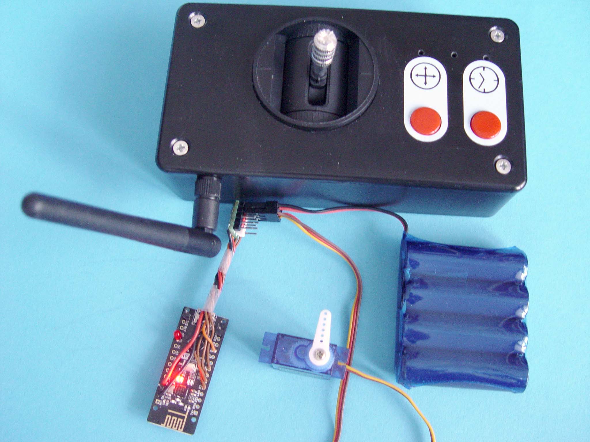

Right, here is the report of my first trials with the NRF24 hopper I built.
To begin with: it works! It took me some time to realize that the order of the output channels was different to the channel order as programmed in the tx (yes Phil, you mentioned it) TAER vs. AERT.

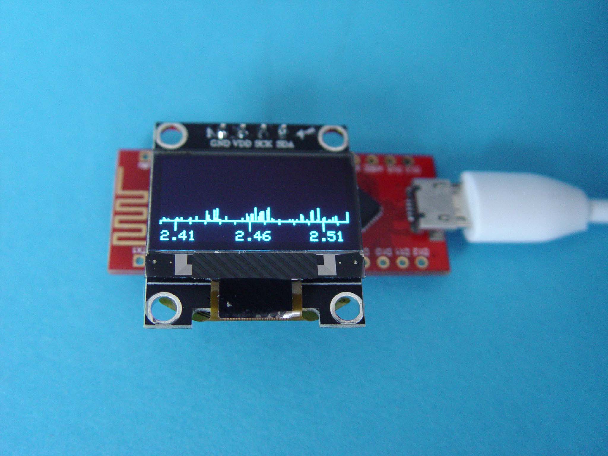

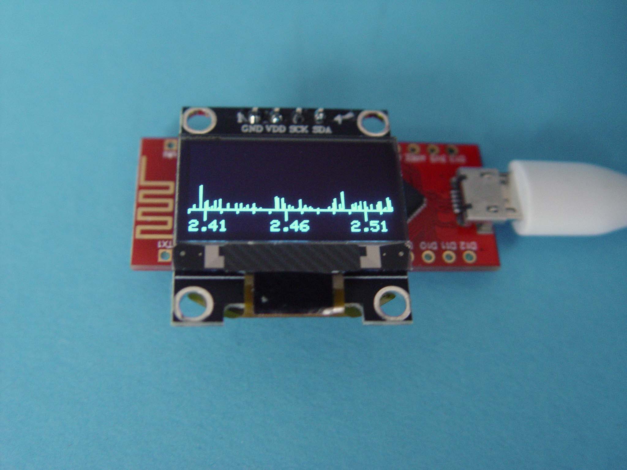

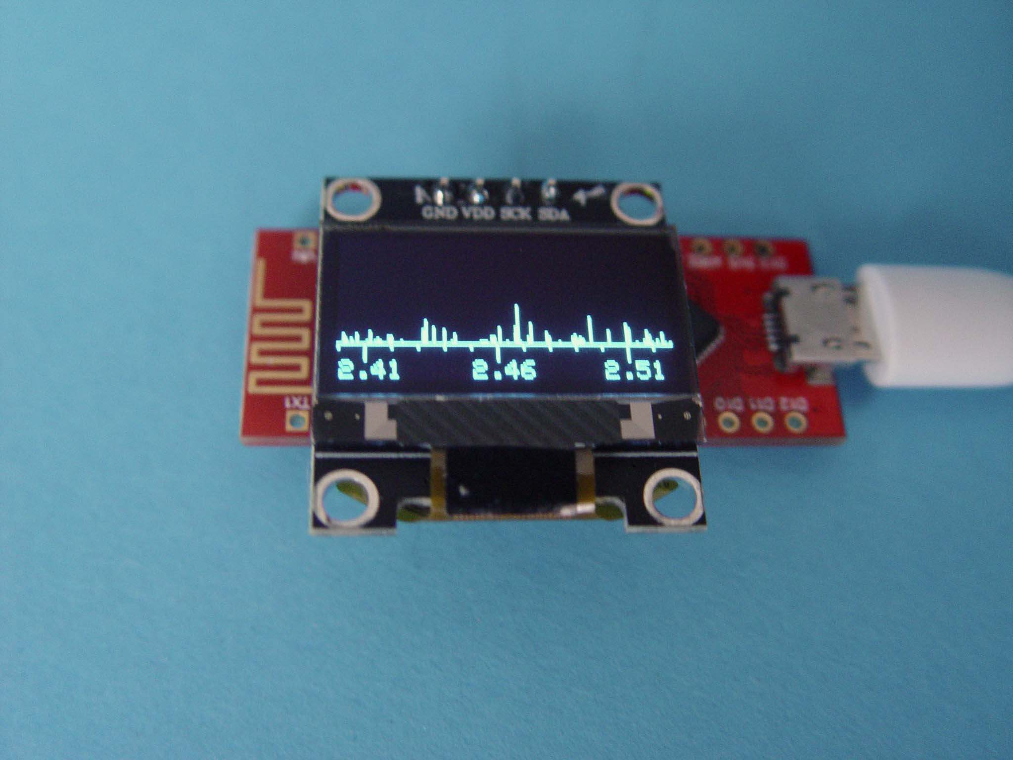

Two things worry me. I built Martin's little spectrum analyzer, and it does show that the tx is firing on all cilinders, but the picture is not steady:
The other thing is that the led on the rx is supposed to flash at 10 Hz, mine is doing about 3-4 Hz with the odd irregular flash. I did add the capacitors to the 3v3 supply of the RF module in the tx, be-it a 100n and a 22 microF that I could scrounge from my cousin's stock. Should I increase on the 22 uF?
I did an earlier test with the rx, and the servo I connected acted quite erratically, but after I added a set of capacitors to the supply the servo I connected alternating to the Aileron and Elevator outputs seems to work fine, even my added digital trim and sweep features work as intended.
I did a sort of "range test" (well.....) by leaving the tx in sweep mode in my workshop on the second floor, and the rx still performed in the living room on the ground floor, transmitting through two reinforced (I think) concrete floors.
The sketches I used were personalised versions based on Phil's earlier versions: and for the transmitter and receiver respectively.

I will test that, but it still showed the same two floors down from the tx......Phil_G wrote: 09 Jul 2020, 15:21It may be swamping - try shrouding the tx aerial with your hand, see if the rx led changes.
Shielding the Tx aerial did not seem to make a difference, even unscrewing it did not until I put a wall in between, but then it went into failsafe mode.
I connected one of the rx outputs to your pulse analyzer, even though there is no ppm stream it does show a frame rate, which is more or less stable at 20 ms. Does that tell anything?
And yes, I routed the battery connections directly to the module regulator, from there to the nano GND and 5V.
I used a single 18650 cell if that is of any consequence.
