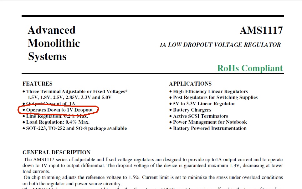

On a high power module a single 18650 doesnt give any overhead for the 3v3 regulator, the AMS1117 datasheet says "down to 1 volt dropout" so the input should be 4.3v minimum. On a receiver we get away with it because of the low current draw but the +PA transmitter module takes huge current pulses, which when already below dropout will be causing the 3v3 to momentarily collapse. Could you try it on 2S with the switched battery connections going first to the 3v3 reg input, and then on to the Nano Vin/Gnd?
