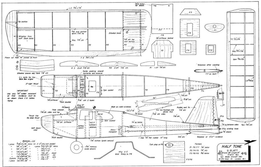

I printed off the plans from OZ - https://outerzone.co.uk/plan_details.asp?ID=5673 - then made templates by gluing the relevant parts to thin cardboard (in my case, a cereal box).
Given the material I was going to use, I had to make a few mods to the structure.
  • fuse sides and formers would be 5mm foam board
  • fuselage top & bottom would be 2 mm foam board that I had brought with me
  • the tailplane would be a single sheet of 5mm foam board with a bamboo skewer to reinforce the LE.
  • the wing would be a single sheet of 5mm foam board on the bottom with 2 mm foam board top sheeting.
  • The wing spar would be a bamboo skewer top & bottom with a shear web from 5mm foam board
