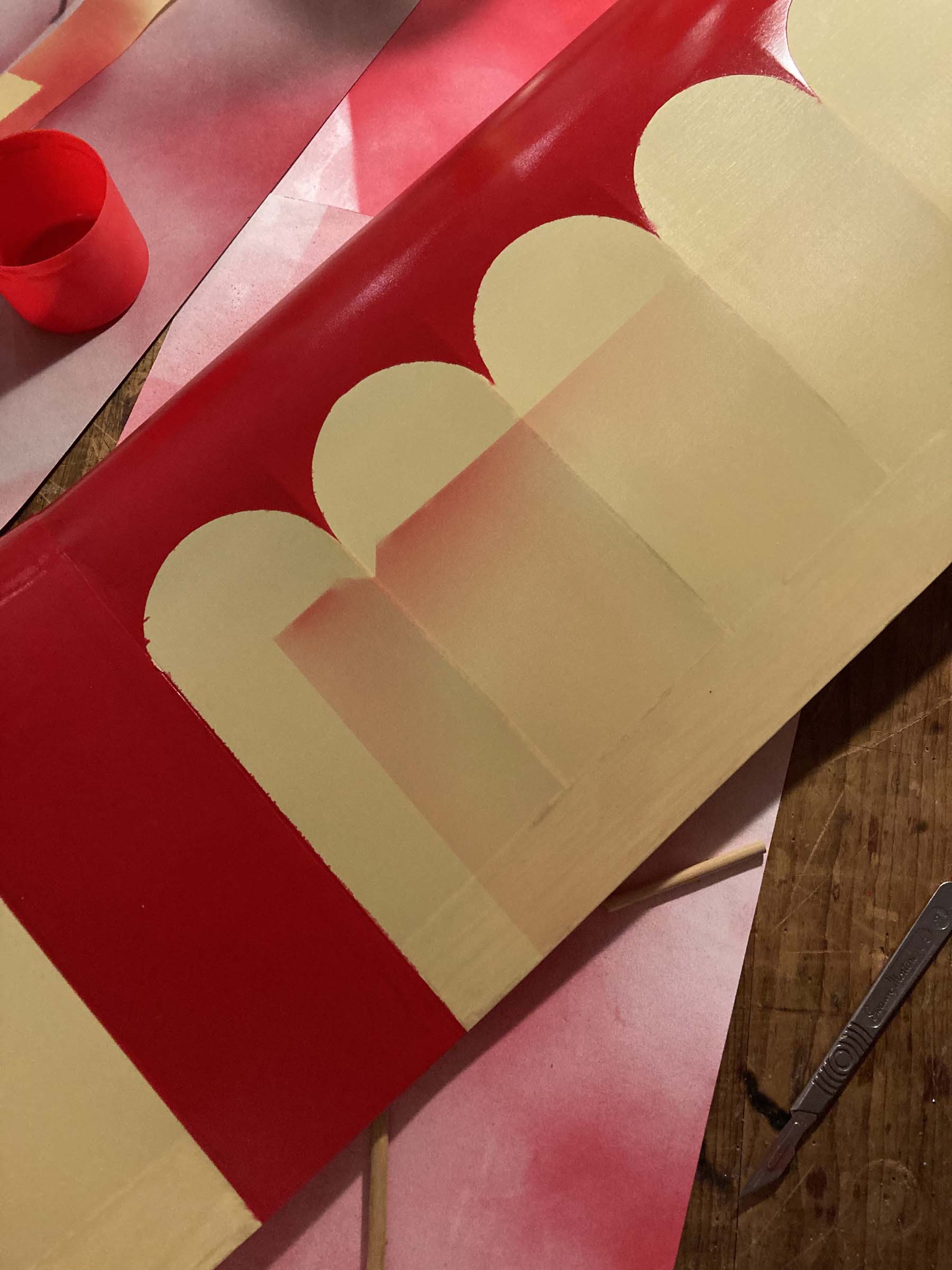

Despite using posh masking tape I’m still getting bleeding on the edges. So the next bit ( horizontal stab) I have been over the tape edges with the covering iron
Let’s see what happens when I take the tape off

Just a quick...bleedings are a pain but if you spray just a light coat of clear dope over the edges of the tape normally it helps.

I did have a similar thought and put a very light mist coat on first so it would dry - then slowly built the coats up so I didn’t have a ‘flooded’ wet edge against the tape. That along with ironing the tape has definitely helped.

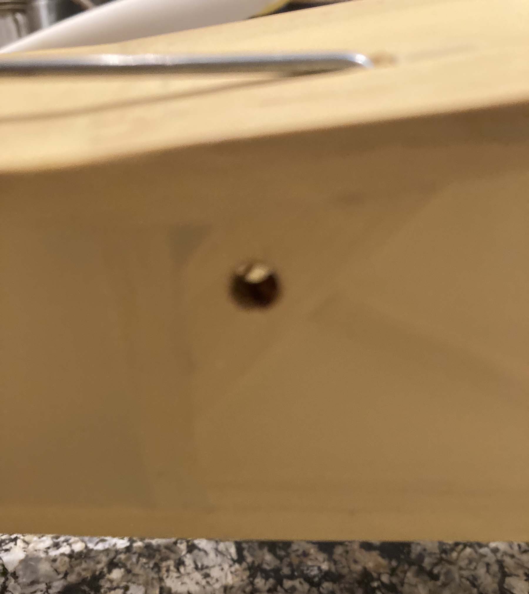

Made some little pegs from carbon fibre rod - checked alignment and araldite glued together. Ably assited by Star Wars and The Ark of the covenant !

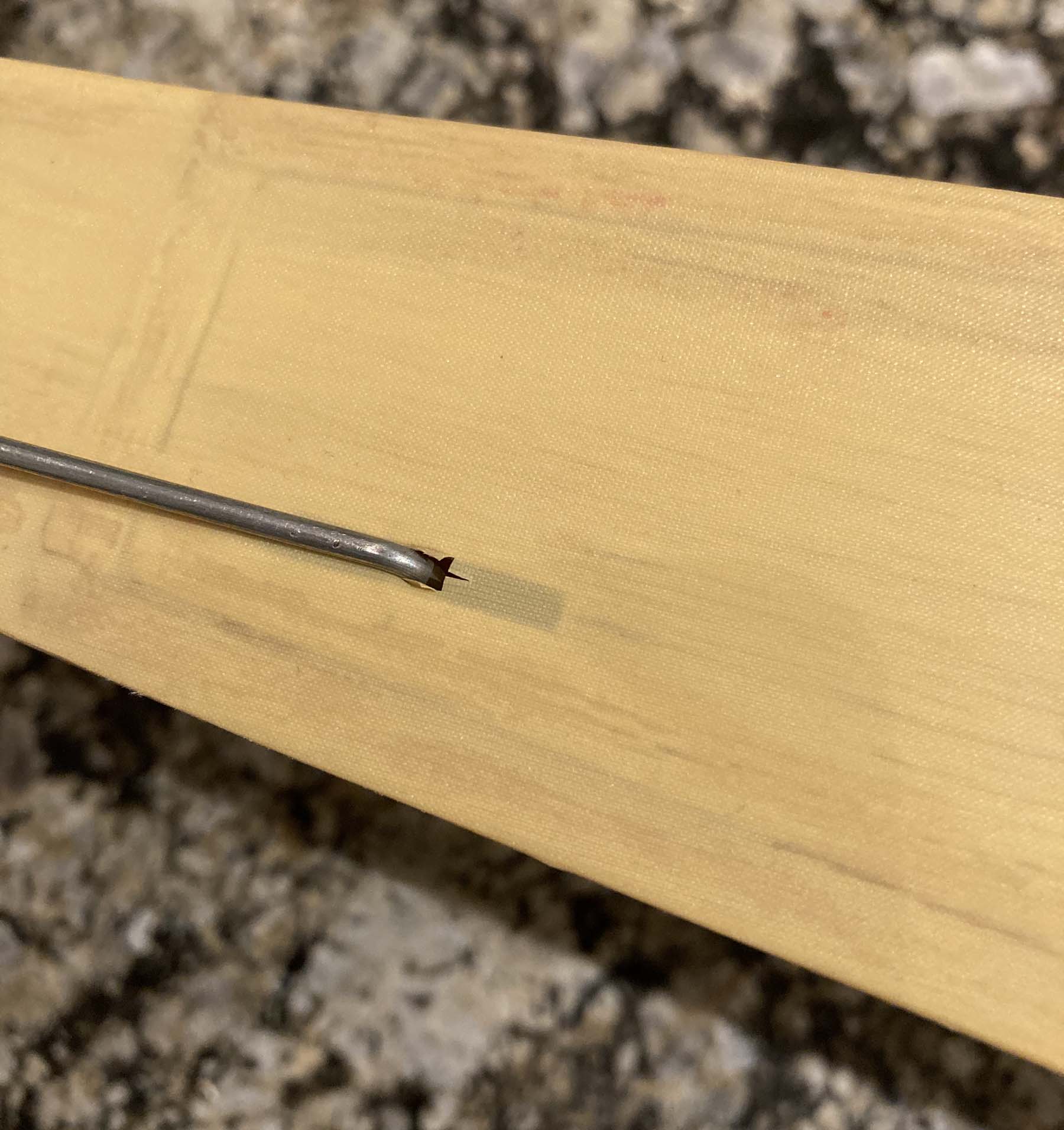

Just made the tail band clip out of an old picture frame wall hook
Made holes through the covering for the band dowels with a hot wire
Made a front peg to locate the tailplane so steaming ahead

Uh oh …. Despite carefully masking off some paint has crept in where it shouldn’t have .

Using a bit of E15 petrol to get the overspray off which is working mostly.

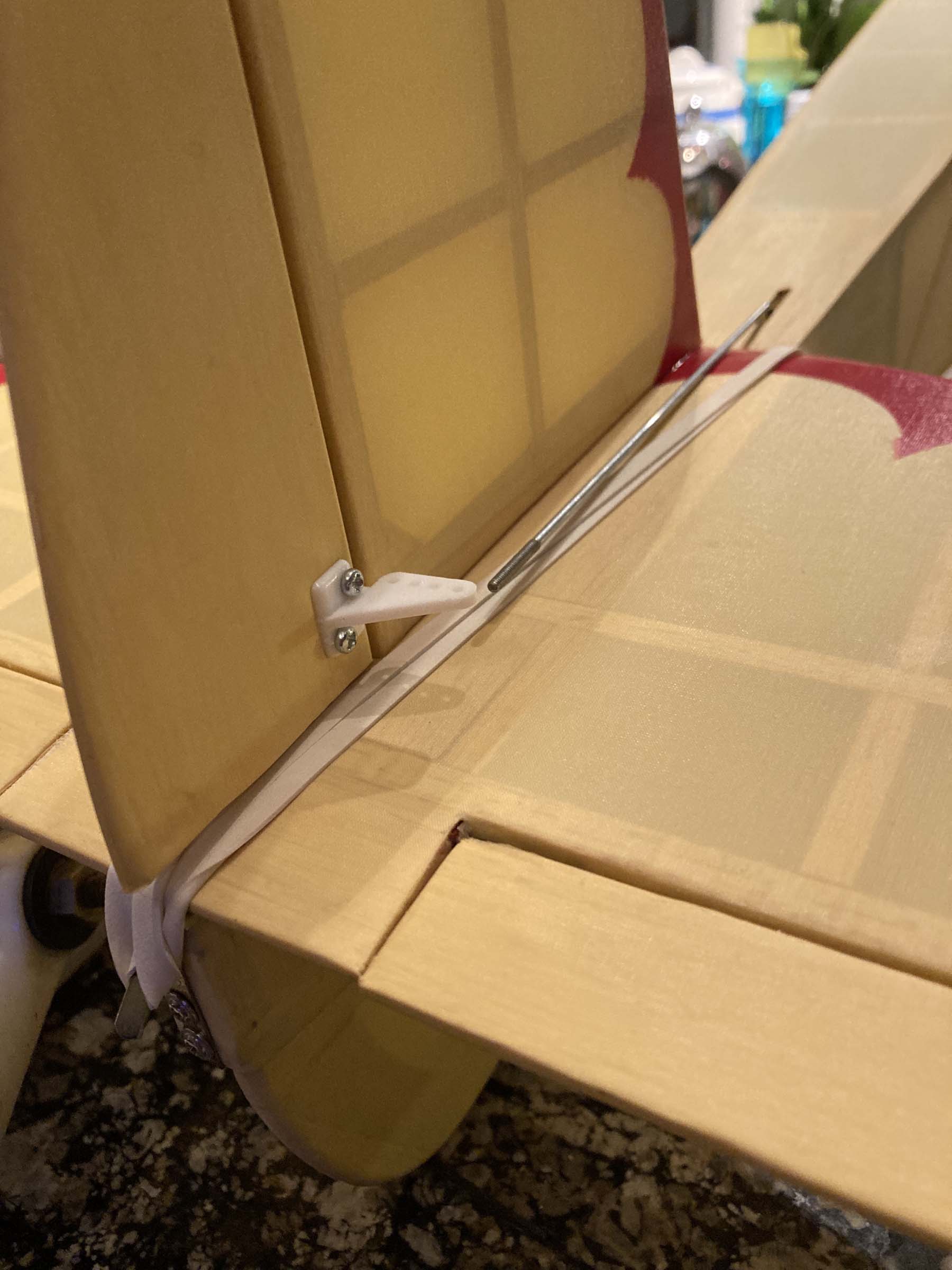

Well tonight’s episode is complete. Motors in ( probably too powerful but it’s what I had ) band pegs are in . Tailplane is mounted . Horns yet to do ,windows etc
