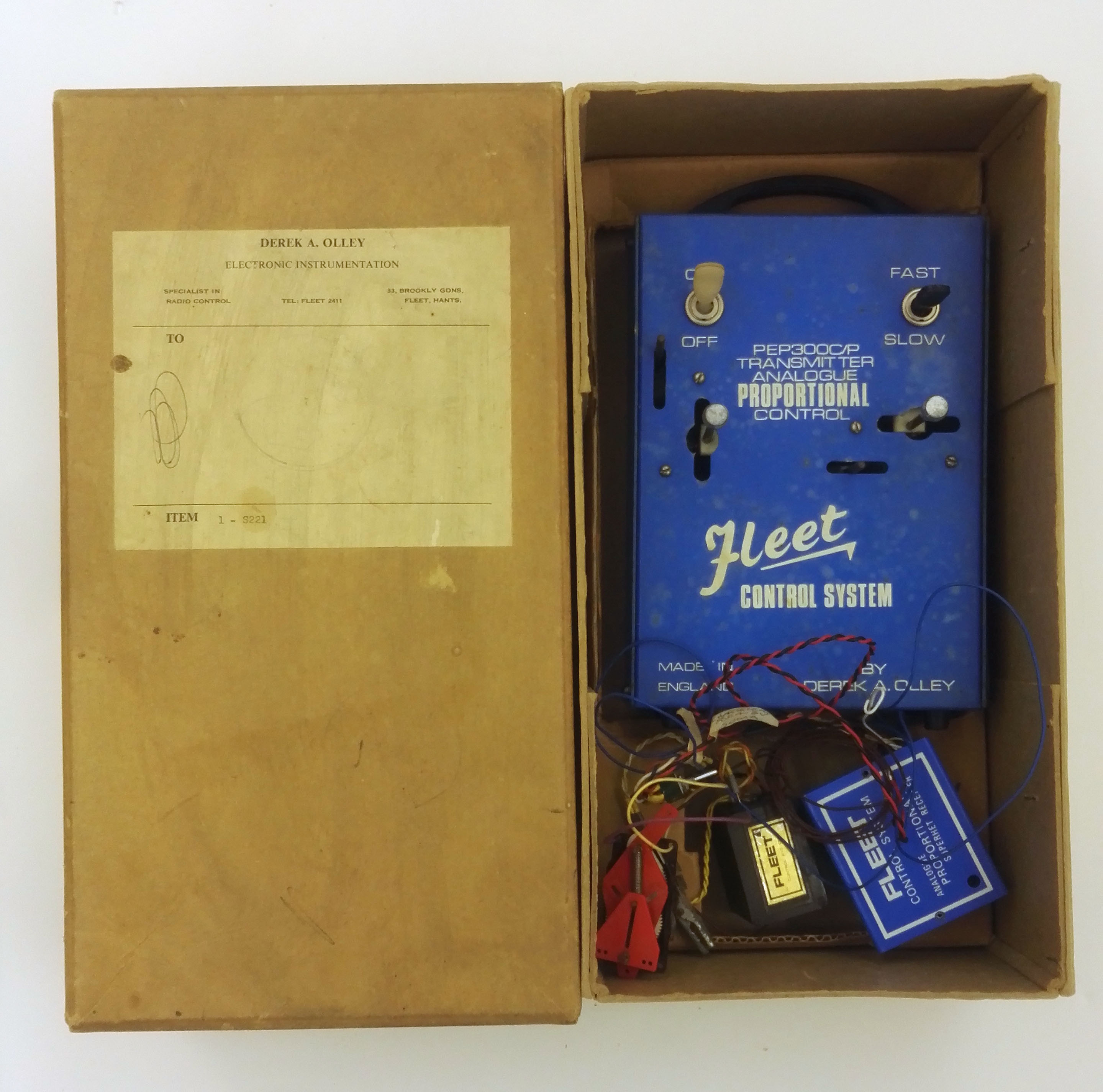

Unfortunately, that method won't work for a Fleet GG set as the Fleet transmitter uses white lettering/logo on a blue paint surface and normal laser and inkjet printers can't print in white. You then have a few options:
1. Use a commercial label service that offers white on clear vinyl labels
2. Use cut white vinyl labels (but the text may be too fine for that)
3. Buy an expensive "Ghost White" toner for a supported printer, they are into the thousands of pounds, so not economical for a one-off
4. Print the blue/white on a large white vinyl self-adhesive film label and cover the complete transmitter, I think an A4 sheet would just about cover the size
I can't take a photo or scan as my Fleet GG set is on loan at BMFA Buckminster, but here is a photo I took a while back that may do.
viewtopic.php?f=25&t=789
