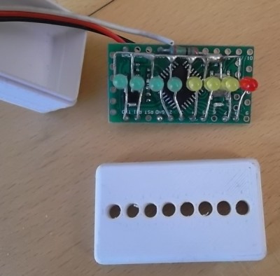

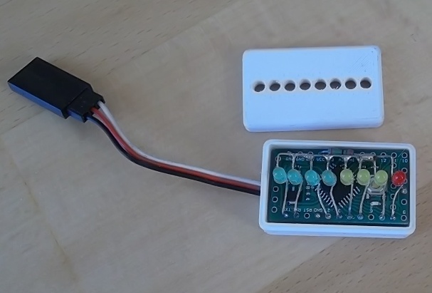

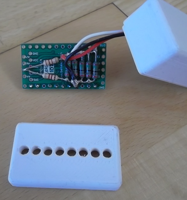

My checker is ready and working fine.
I ordered tha small board, but they did send me the longer ones instead. But no problem.
I rearranged the pins for the LEDs and made a larger case for it.
My boards came with the bootloader installed, so programming them was easy.
Re: Simple 8-LED battery checker using Arduino clone board
As usual, Frank, you've made a very neat build. :D
