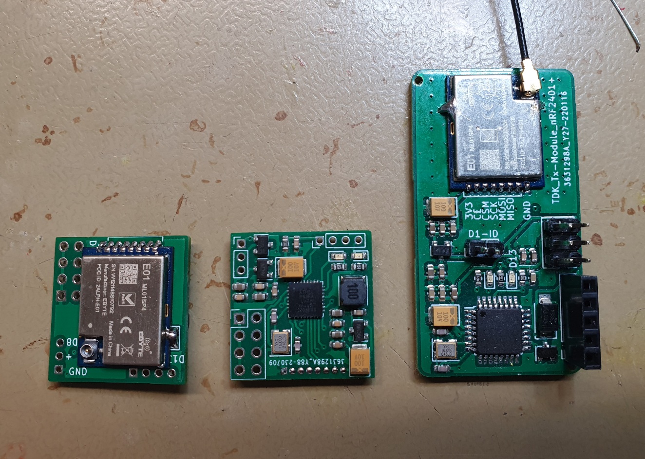

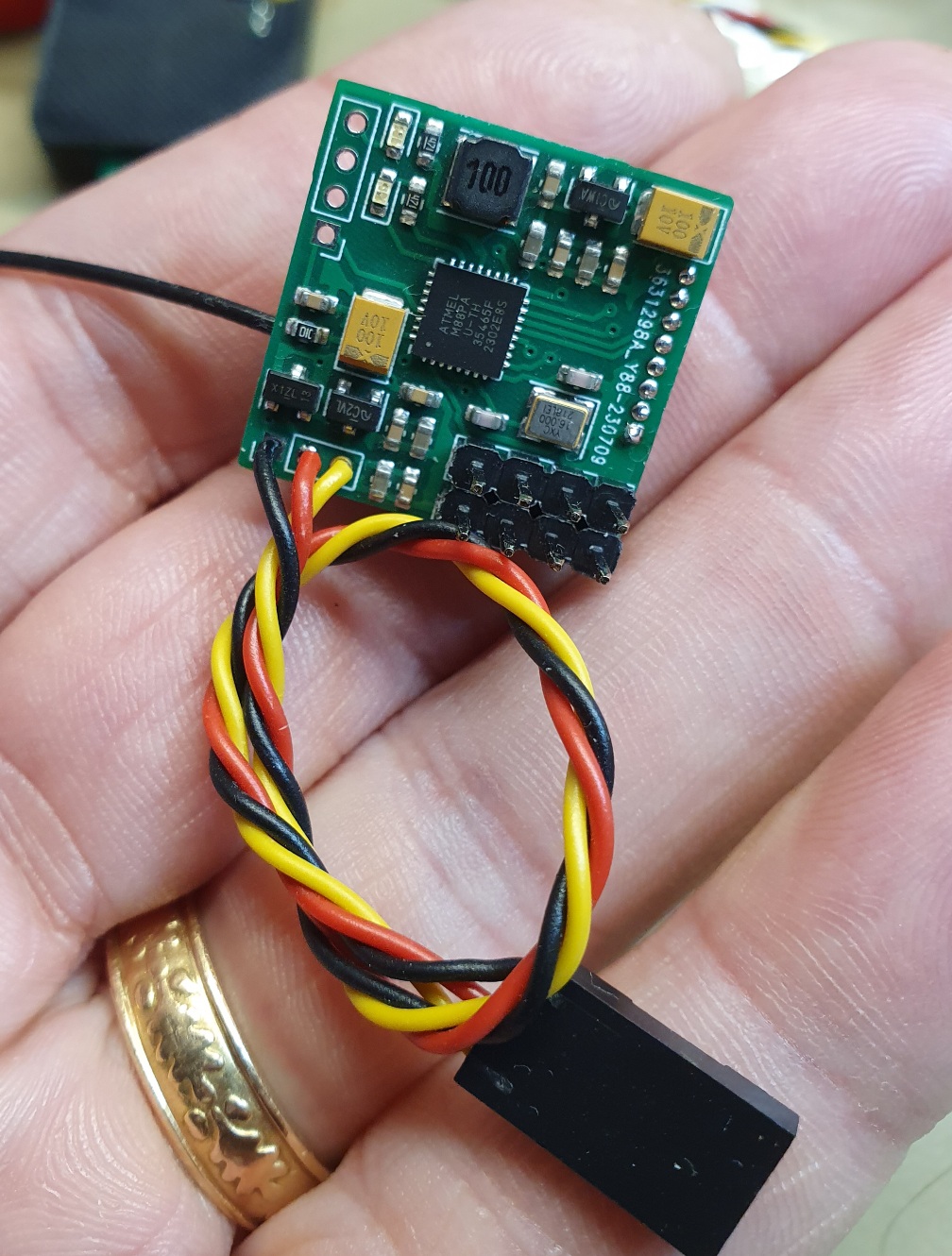

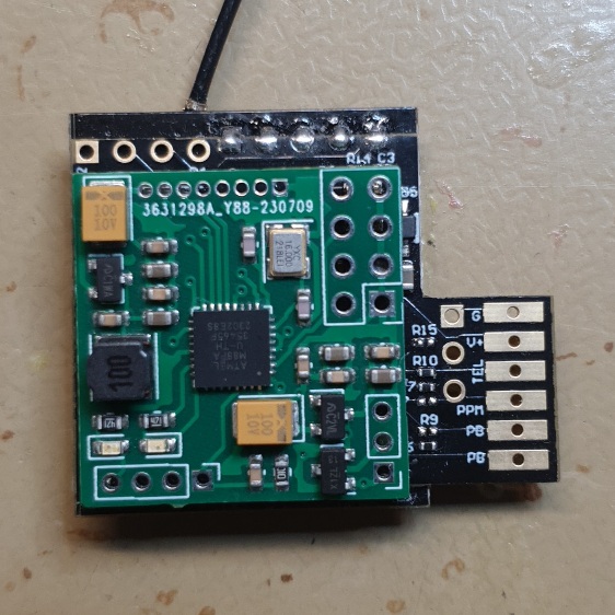

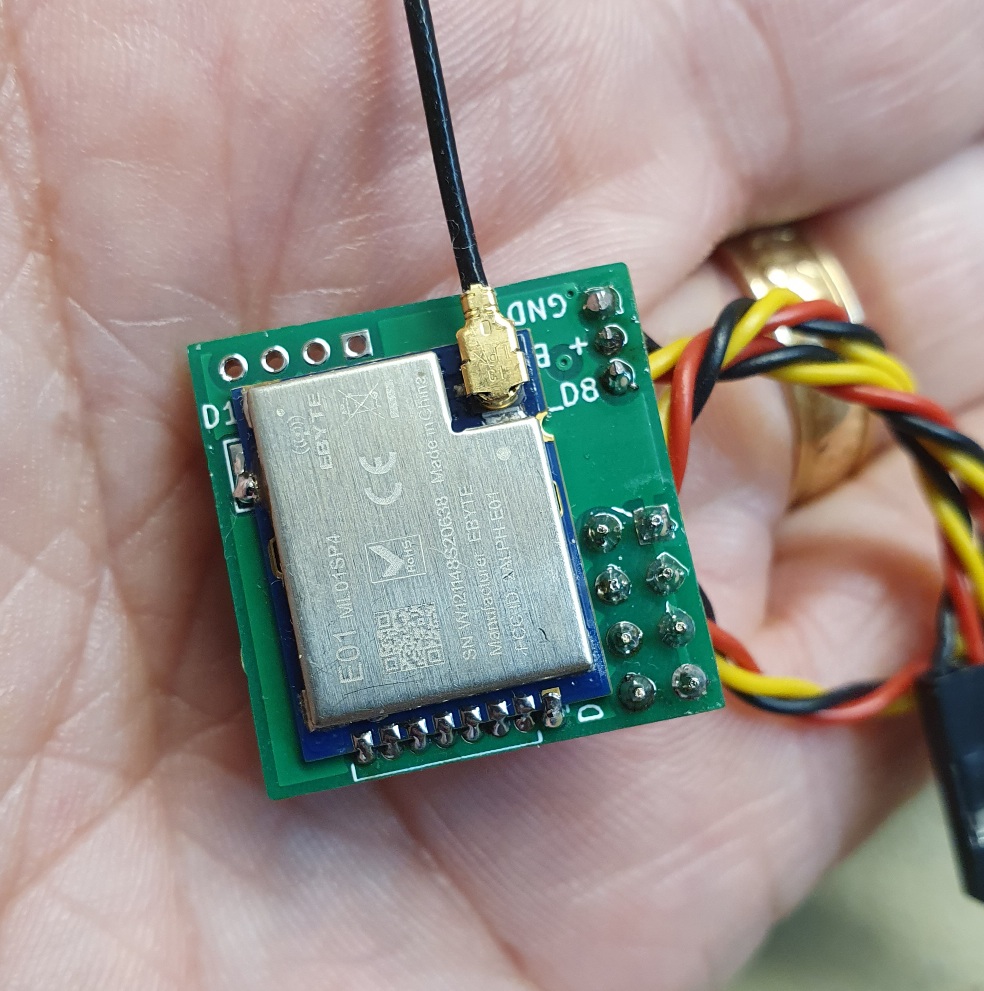

Mike_K has given a soul to one of my long desired projects: a nRF24 Tx module so basically any TX encoder could be used jointly with the nRF24 Rx that came out from Phil_g nRF24 project. It's still an ongoing project but has reached a point where it has been thoroughly tested and flown so it was time to share it with you all. The module opens many possibilities and options in the conversion of existing TX and in the development of fully DIY. At Ponte it was shown an early module installed in a fully DIY set including one of Mike's vintageTx encoders in one of my newest DIY Tx cases and sticks running one of my nRF24 Rx and a set of the newest ProPo servos.
