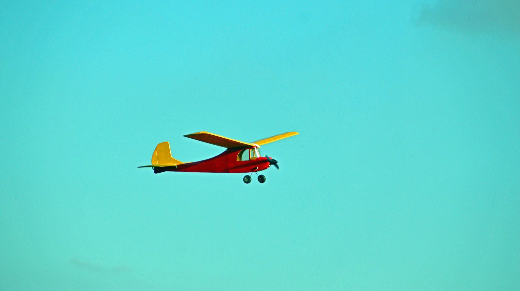

Hmm - well my experience is quite different - but then I like to fly my deacon in the traditional free flight style (short powered climb followed by long floaty glide) rather than powered cruising. My CG is at 3 3/4 inches back i.e. 47%. This required 3/8" packing under the trailng edge of the tailplane to get the glide right. It flies beautifully and has more than enough decalage to recover positively from spirals.
I did try 33% but had to add 4oz lead to the nose and more than 1/2" tail packing. This adversely affected the climb and gave a poor glide.
My tailplane is as per plan and works fine as is the fin.

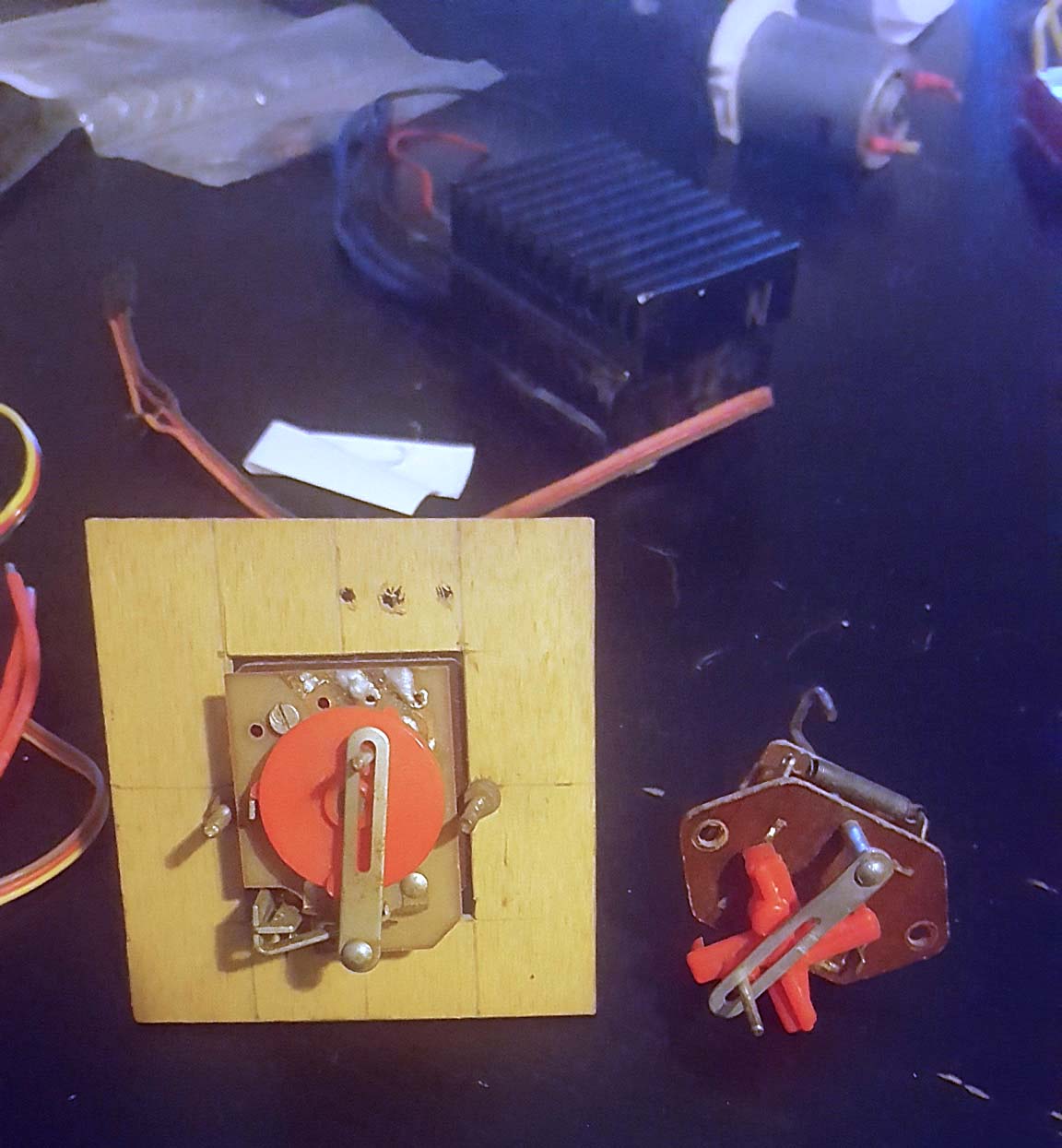

Hi,
I have an Elmic compact I could part with, or a sequential one if that's what you prefer. You understand that Phil's emulator jobbie is much more reliable and less fuss than original gear but if you really want authenticity then send me a pm.
