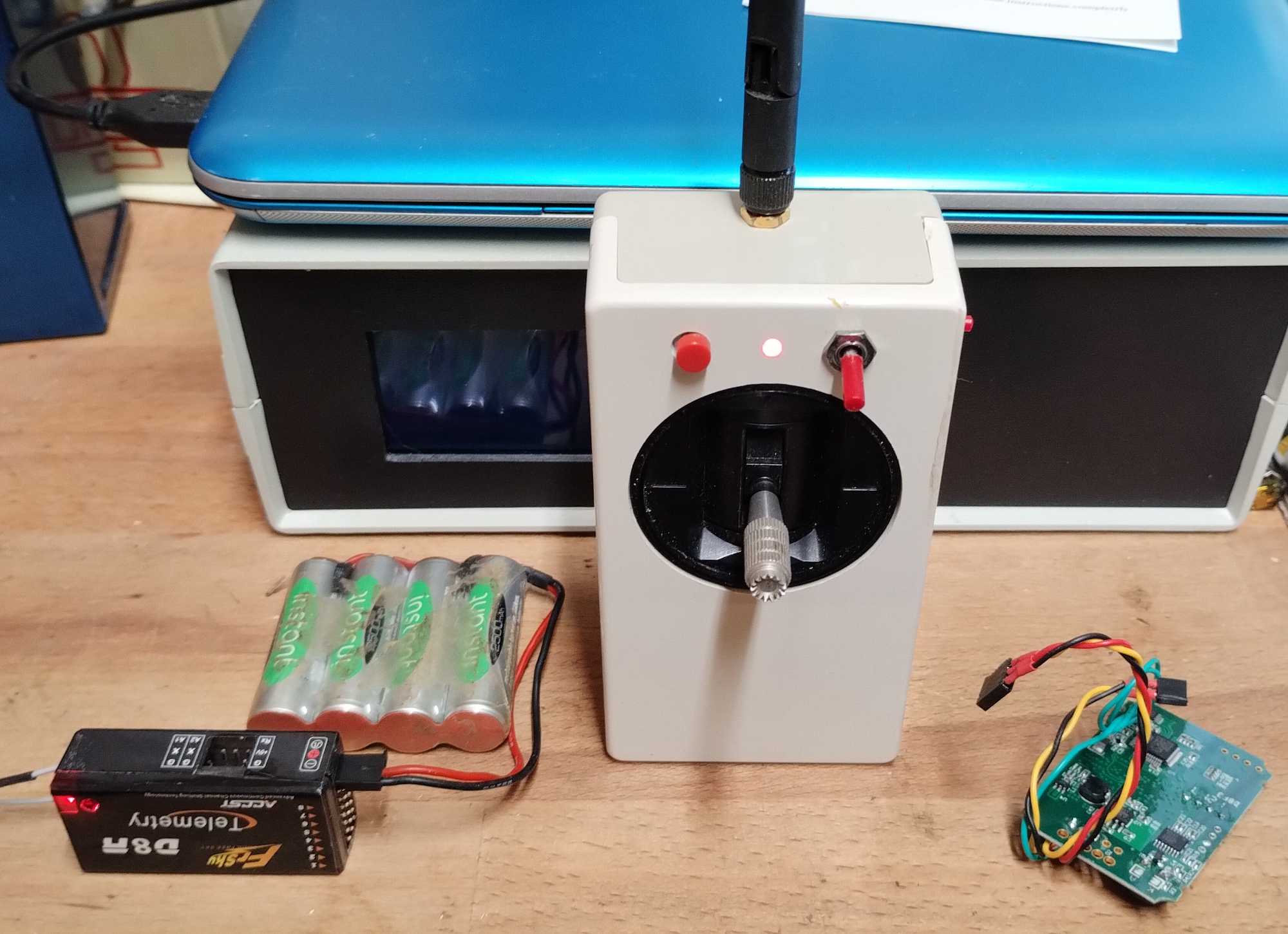

Back home now, confirmed on the bench that the DFT RF module had failed.Phil_G wrote: 17 Sep 2024, 22:07 ... but it turns out the cheap Banggood receiver in my Lidl twisty that lives in the van has no range and I dont have a replacement here with me. At least I think its the rx, its a cheap Frsky clone.
Edit: Turns out the cheap Banggood rx is fine, my Frsky DFT module has failed!
After singing Frsky's praises for 15 years this is my second RF module that has failed in storage, it was fine when last used.
Replaced with one of my spares and all is well again, red leds all round and range restored, the cheap Banggood rx is fine
Quite a tricky replacement as there's no room to spare inside the case, the stick takes up most of the space and everything has to lay exactly.
Glad its fixed though, I love this tranny, its so convenient and lives with my Lidl 'twisty'.
