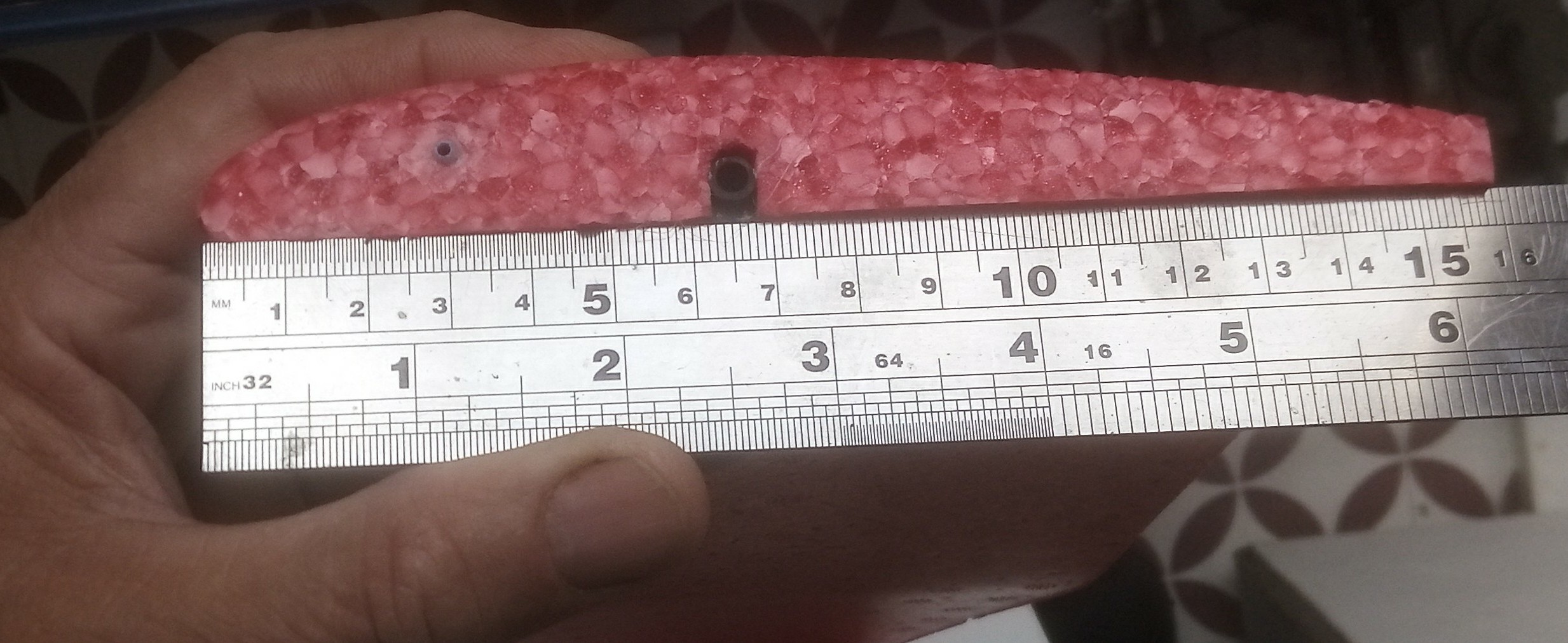

What amount of throw is required - (say in degrees)?
Richard
Re: Lidl gliders available again
Dunno but if you copy the geometry from the pics Rich, mine does twinkle rolls and its really very responsive which is how I like my gliders, needs very little stick movement in normal flight. Shaun has flown mine, he'll confirm its really snappy :D
30mm and 65mm for me: :D

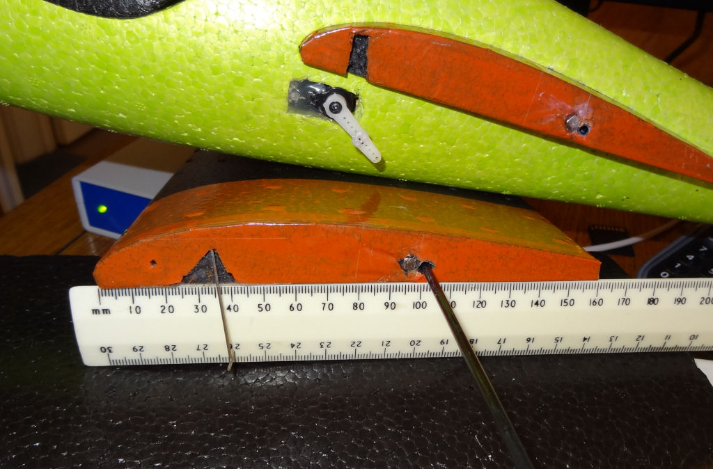

With hindsight, I put the 'spar' (pivot axle) too far back on my Lidl wingeron, and the place where the control rod to the servo entered the wing a little too far forward. I test flew it and it was controllable but even with the transmitter throws maxed out it was not very responsive. Rather than remake the wing pivots, I just fabricated some extra-long servo arms by cutting one long arm off a servo and fastening it on to the end of the other long arm. I now get slightly more wing travel than is shown in Phil's video.
Mine are nearer 35mm and 100mm :oops:
You can see the original position where the control rod went in near the wing leading edge, and the cutout in the wing stub to give clearance. With the longer servo arms, I also made some new links that fit into the wing further back, so those cutouts are no longer used - the clearance cutout is now in the wing panel rather than the wing stub.

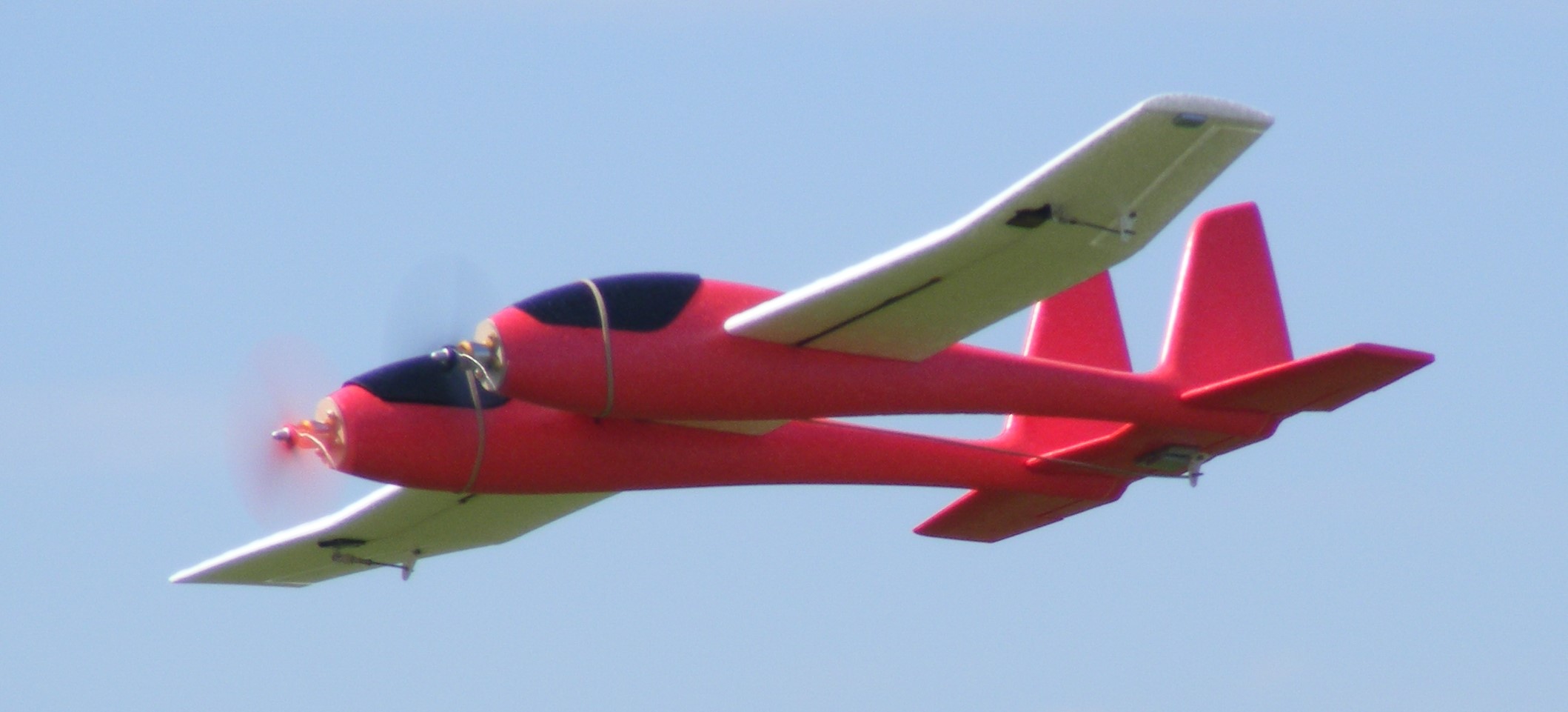

Spotted at our patch today. LIDL Twin. 2x 100W motors. Goes like stink ! Conventional Ailerons and Elevator. No rudder but differential throttle instead (subject to ongoing experimentation)
Spike S wrote: 24 Aug 2019, 16:07 Spotted at our patch today. LIDL Twin. 2x 100W motors. Goes like stink ! Conventional Ailerons and Elevator. No rudder but differential throttle instead (subject to ongoing experimentation)
A man after my own heart, BUT, Damn - he beat me to it :x :cry: :lol: :lol:
I'd envisaged my "variant" to have a T-tail, like the full size Bronco. Ah well, maybe one day :oops:
