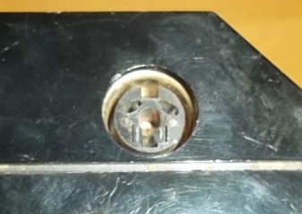

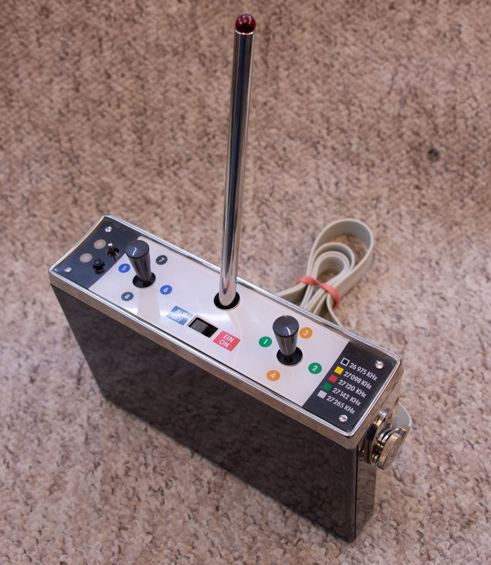

tiptipflyer wrote: 05 May 2018, 09:17 But it´s not a DIN charging plug as we know them now, it was a special Grundig version of it. The oulines are exactly as the modern DIN plugs, but the pins are a little different. Since the oulines are the same, you can easily replace them by a modern 5 or 7 pin DIN plug for ballance charging.
BTW its the same charging plug as the later Grundig TX14 and all the Varioprop propo sets had, so it was factory installed for sure.
This one?
tiptipflyer
Posts: 407
Joined: 16 Feb 2018, 22:49
Location: Germany
Re: Variophon conversion
Post by tiptipflyer »
No, it looks like this, it is a varioprop 12 transmitter, but the plug is the same.
But a lot people changed it to a standard DIN plug, because they don´t have the matching Grundig connector.

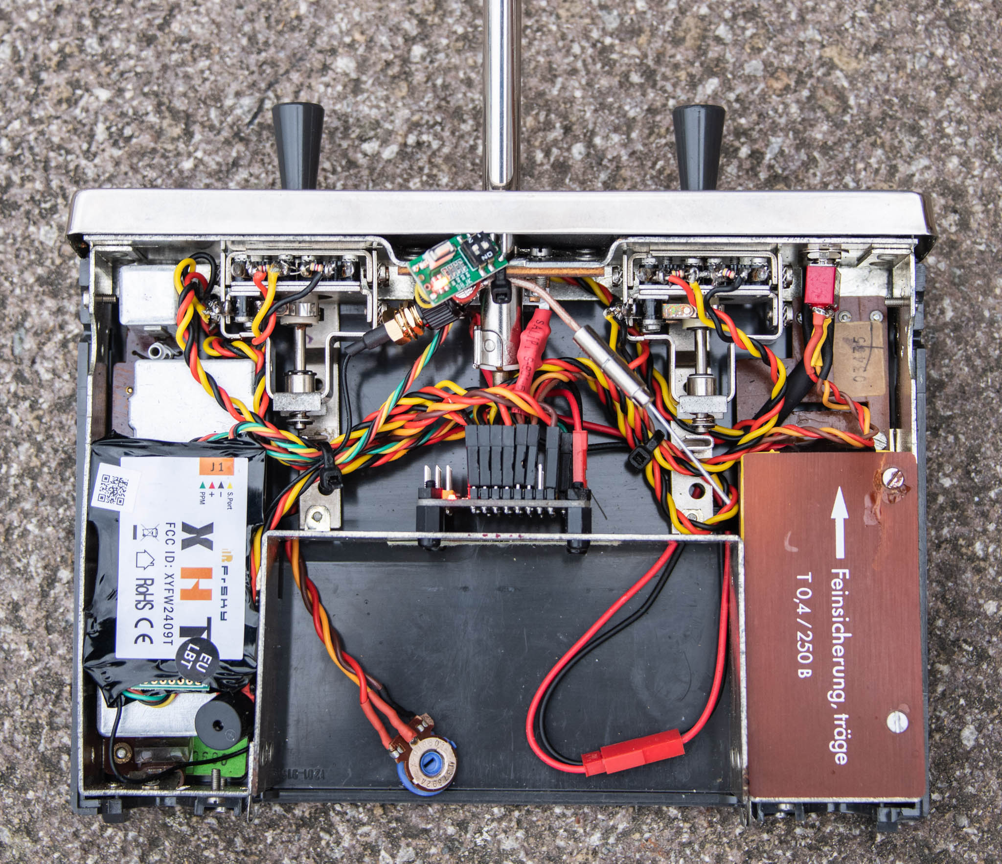

I finally got round to test flying my Variophon last Friday afternoon in my old Junior 60 and it all went well. I know it is a bit of a cop-out using a Junior 60 that I can fly itself if needed, the couple of times when I messed up on the joysticks, I let it go and it sorted itself out fairly quickly, who needs electronic stabilisation?!
I reverted back to using the joystick gates as I found it difficult to pulse rudder and elevator together on the same stick. But there are times when you want both rudder and elevator at the same time, so I cheated a bit and have mixed the aileron stick (used for rudder) and the rudder stick together on the transmitter, so I can use either. At times I found it easier to use the right hand stick for elevator and the left hand stick for rudder so I could use both simultaneously. This comes quite naturally as I regularly use the left stick for rudder (on 4 channel models) for things like taking off, landing, and my occasional dabble with helicopters.
One quick question, how have you wired up your trim switches? With a normal reeds set you physically can't move the trim switch up and down at the same time, but with separate trim push buttons you can press them together. This shorts out the 5V from the Arduino and stops everything! I'm seriously thinking of wiring them in parallel and putting them on the single trim input. Or I might feed the trim switches 5V through a 200R resistor, so you'd never get a dead short.

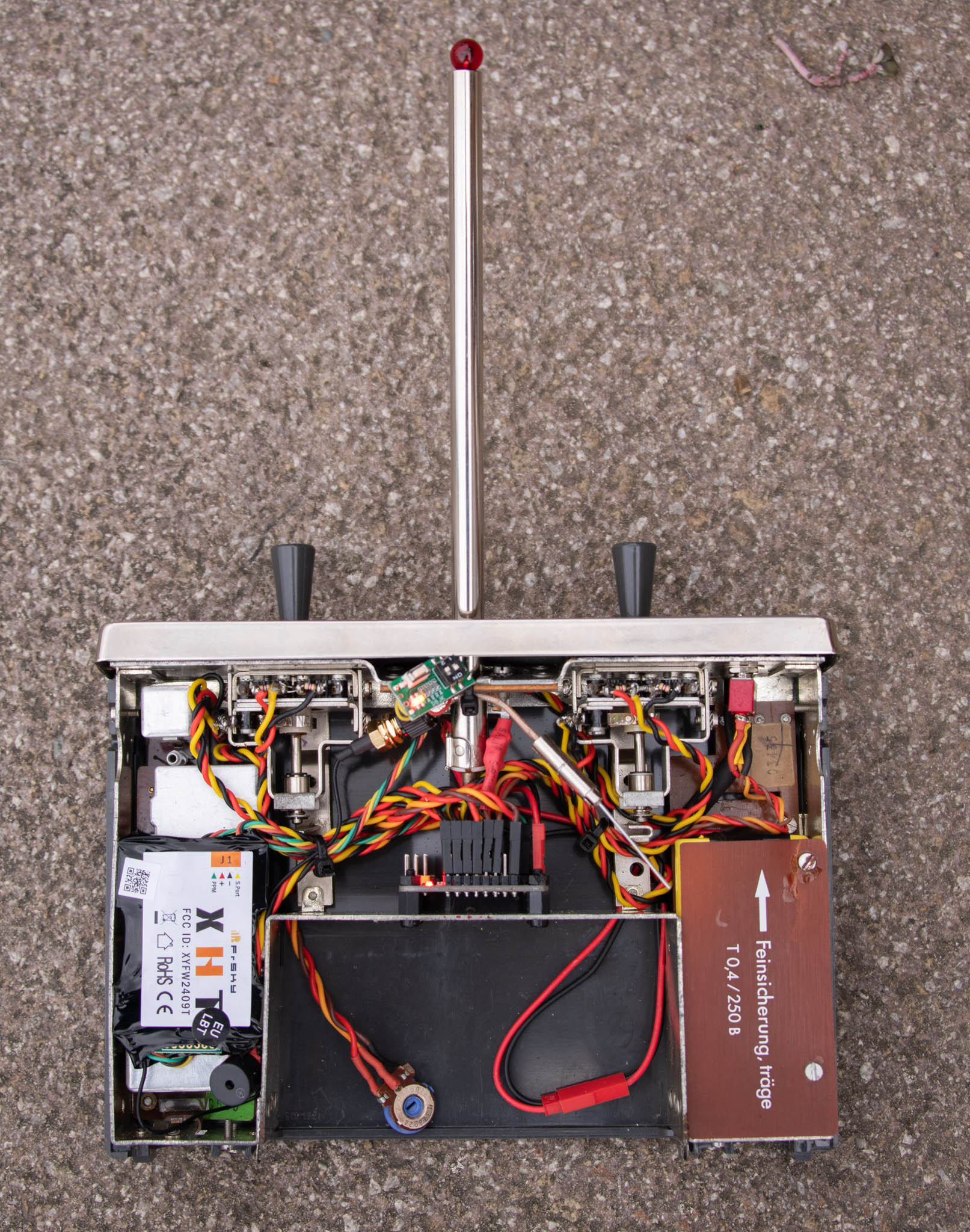

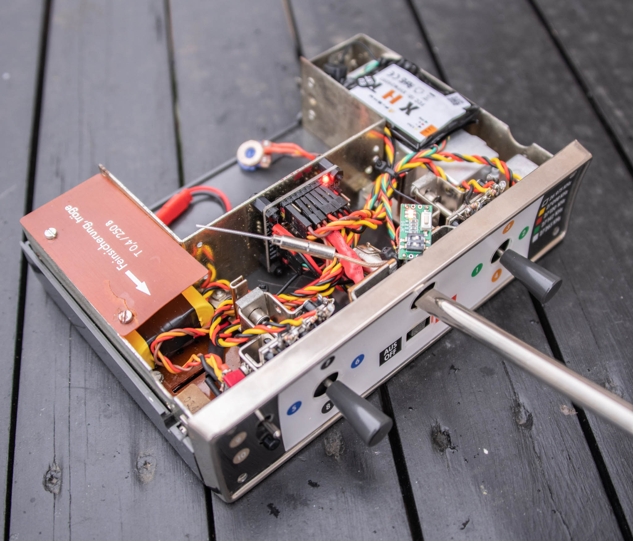

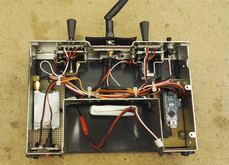

As for the conversion, I made life difficult for myself by using a standard Nano. As you found, the new Arduinos with headers won't fit in the Variophon frame. I'd already cut some strip board to mount my 2.4 module on and thought I'd just cut some more strip board and knock up my own. So as I was making my own, I put the 10K resistors, the travel volume (header pins), the sounder and the speed pot on the board and fitted headers for the joysticks, so I could test it before fitting.
I didn't want to drill the case for the bind switch and LED so I have hid mine under the xtal cover. And I've powered it using a small 500mAh 2S lipo that I've fixed to the frame with velcro.
See you at Ponty
Graupner Variophon converted to 2.4
The internal layout of the Variophon
The bind plug hidden under the Xtal cover

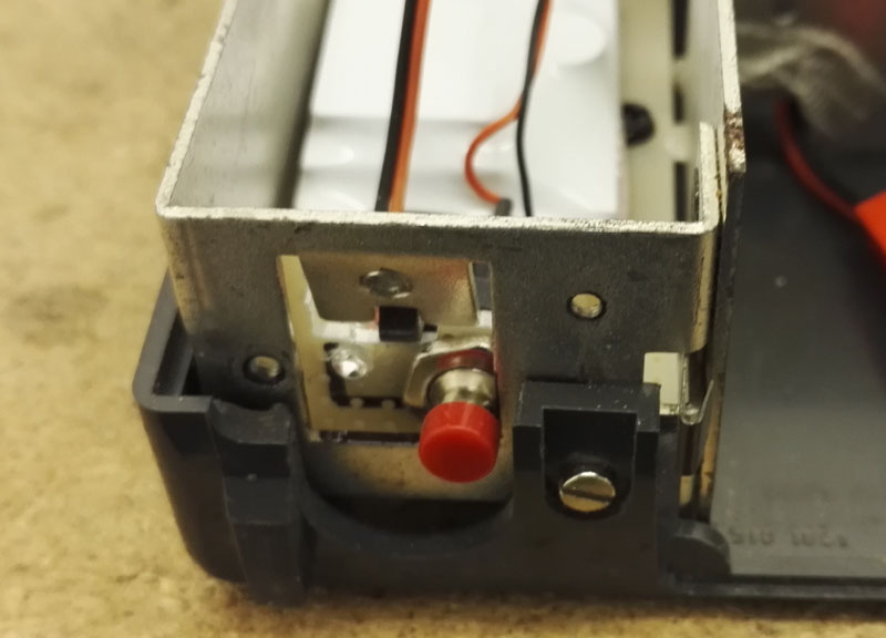

Good idea putting the bind button in the crystal slot! However, a bit awkward for routine range checks. I've put mine on the top, mirroring the trim buttons:
It was a tight squeeze, getting the standard FrSky bind board under the top plate, but it just fits!

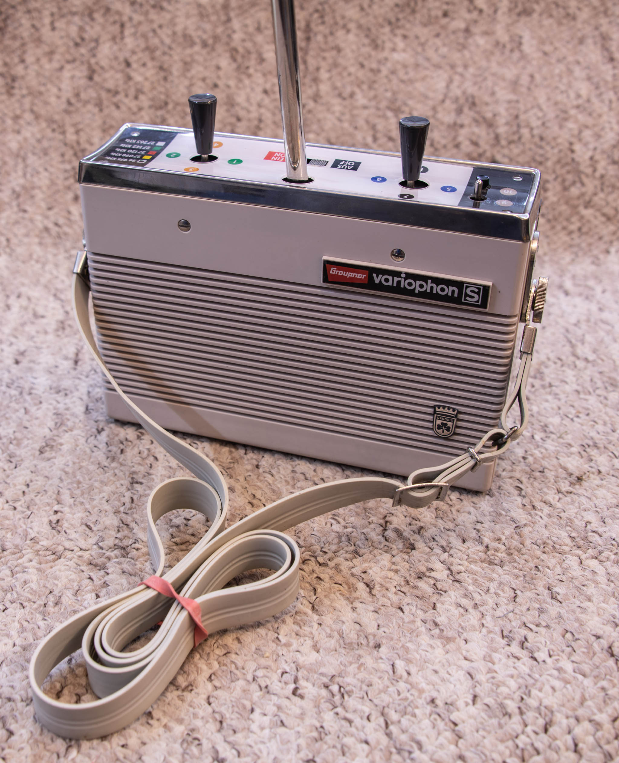

BTW, if you need a replacement neckstrap, a Ukulele strap makes a perfect substitute:
And thank you to my glamorous model for her assistance in the photo.......
