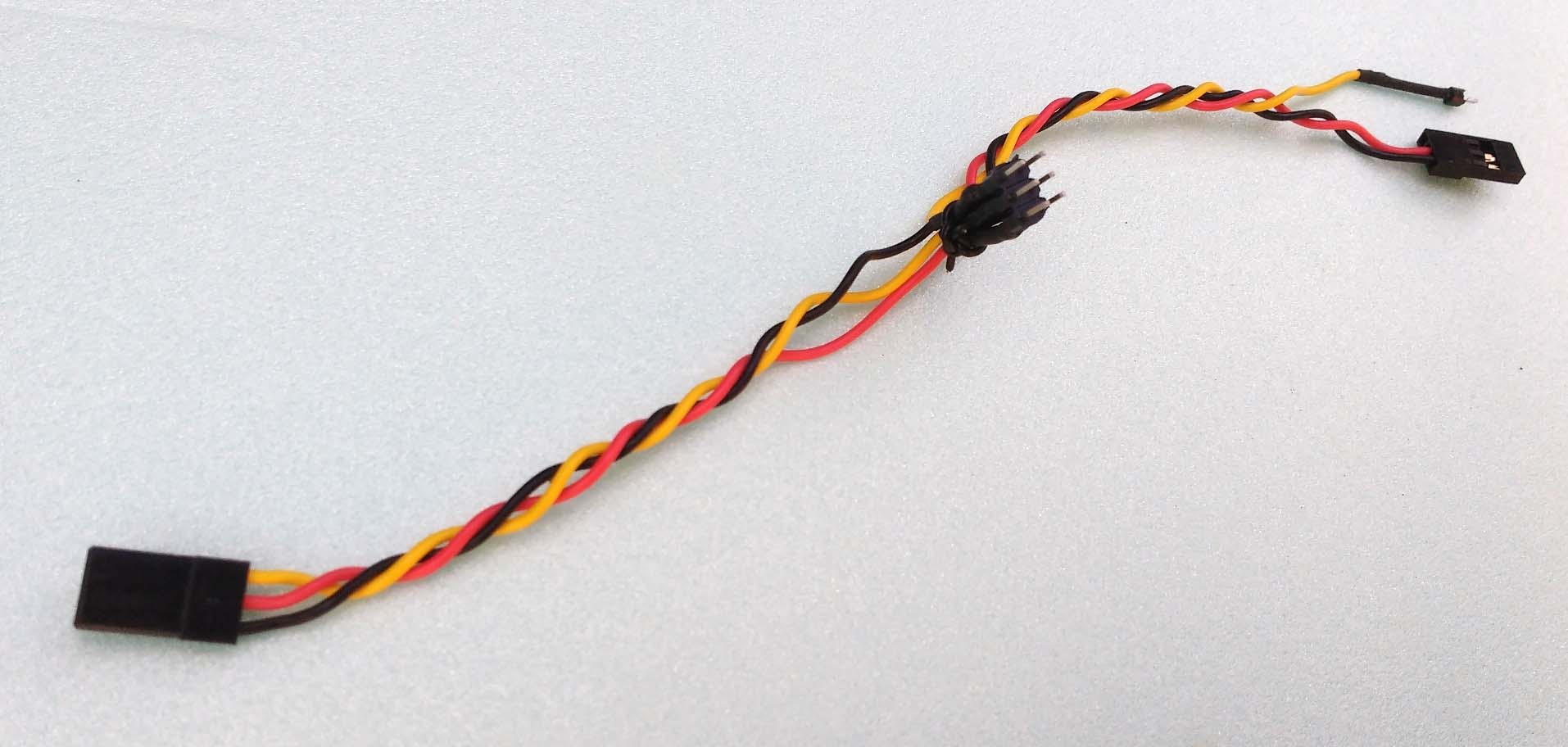

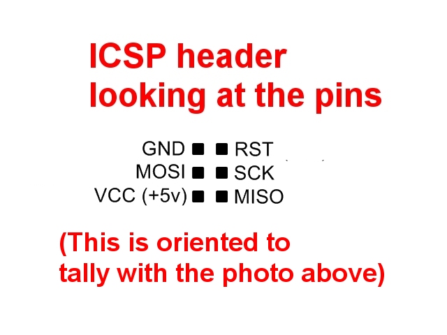

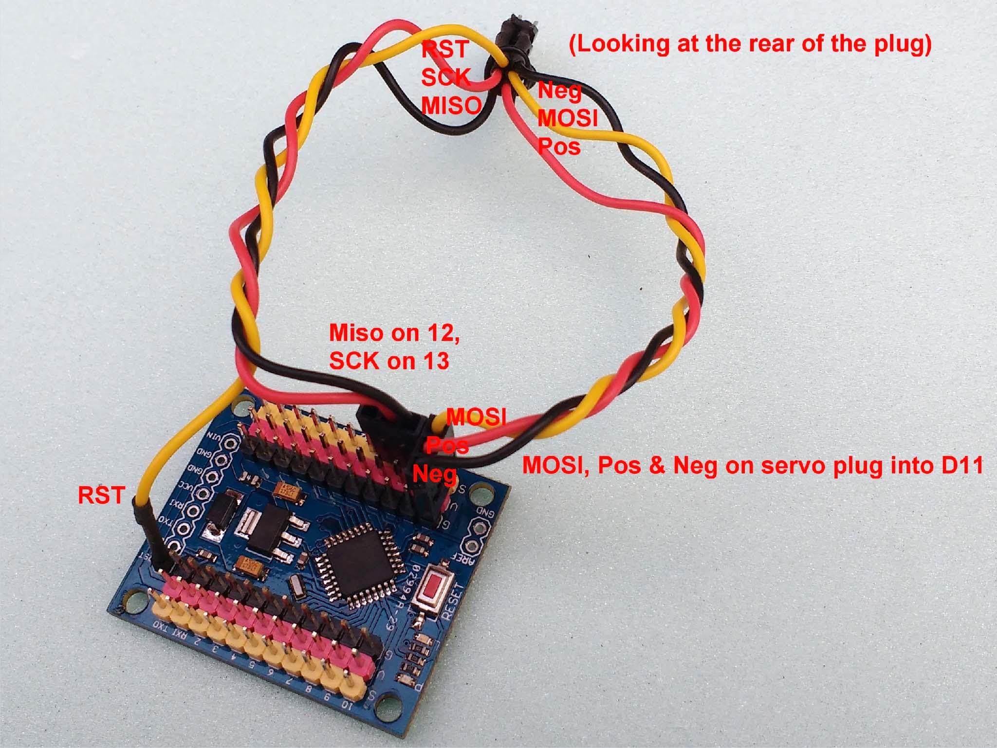

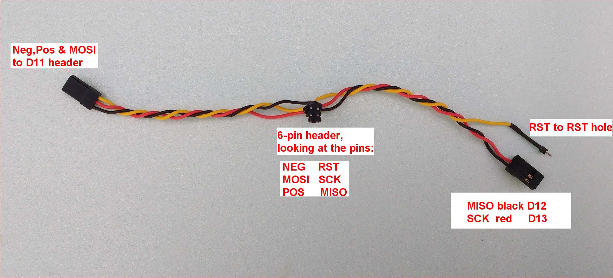

Jay, I've used this board for a few projects now:
Is this the one you're talking about? I've just made up a cable so I have two sets of 3-way connectors to plug into the pro mini from the programmer. The image shows what the pinout is.
In the Arduino interface I've been using "Arduino Nano" funnily enough. Doesn't seem to make any difference, but maybe someone will correct me on that. The Pro Mini boards I've been using are 16mhz.
Hope this helps.
Carl

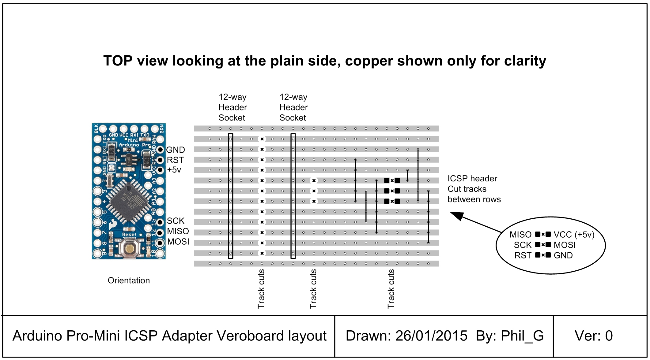

Re: Programmer question

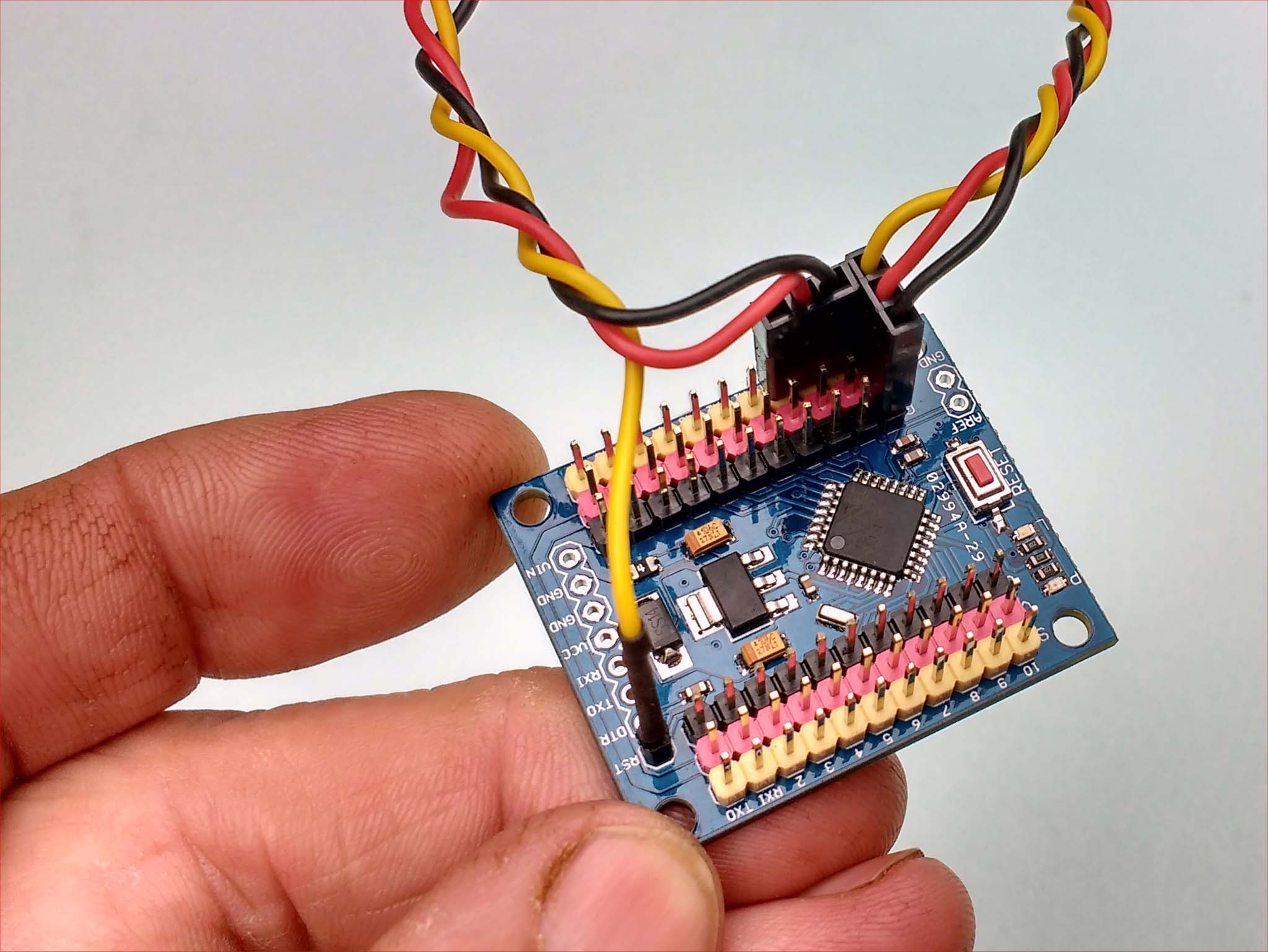

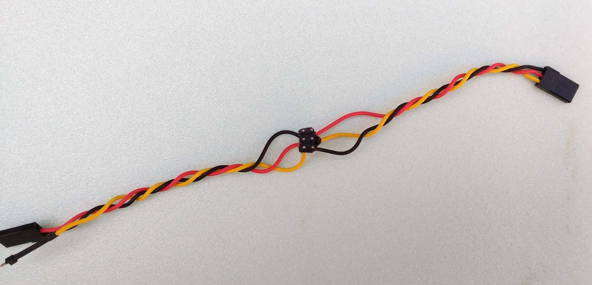

When I get a mo I'll repost all the old ICSP adapters, meanwhile heres the pro-mini one:

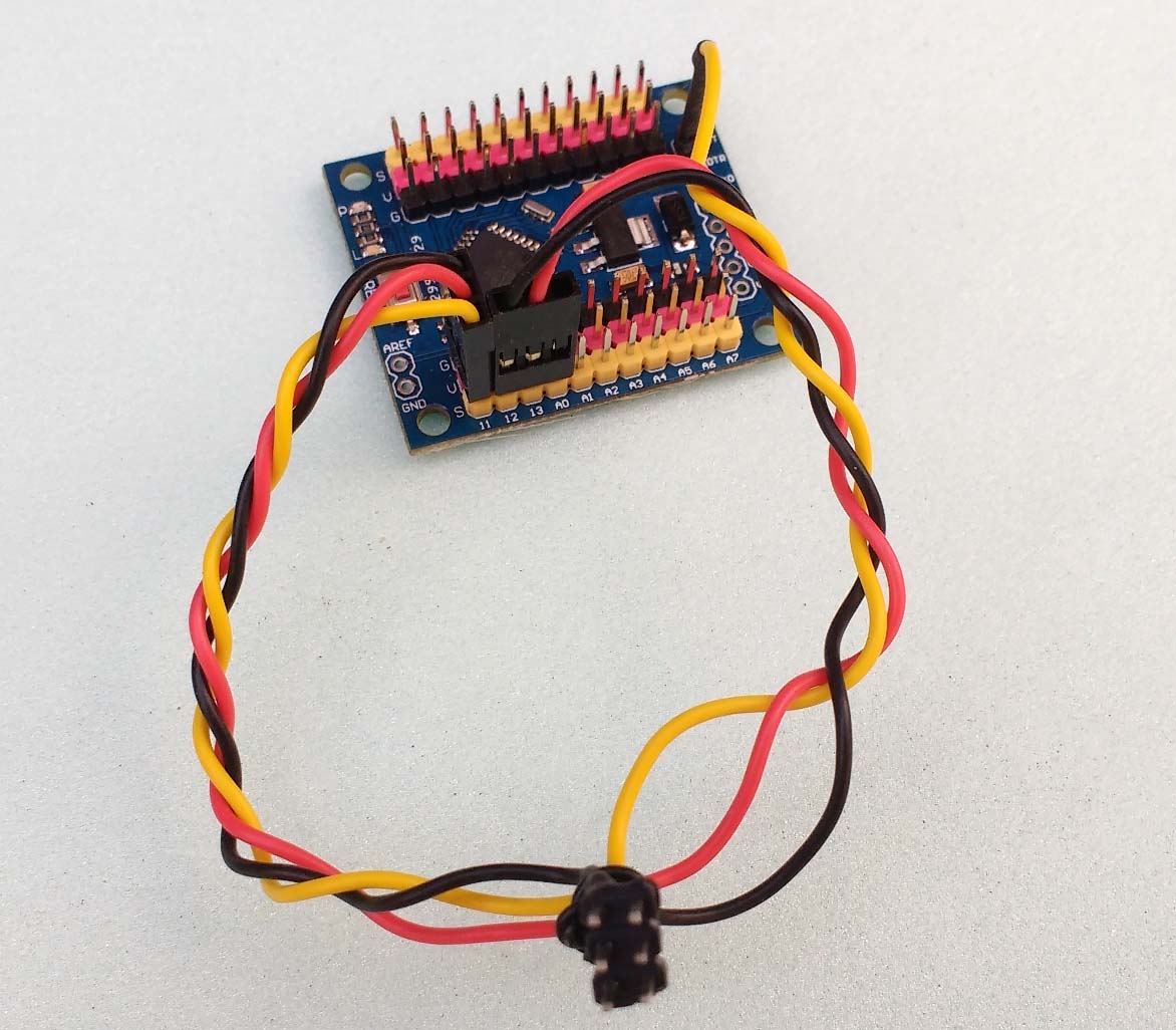

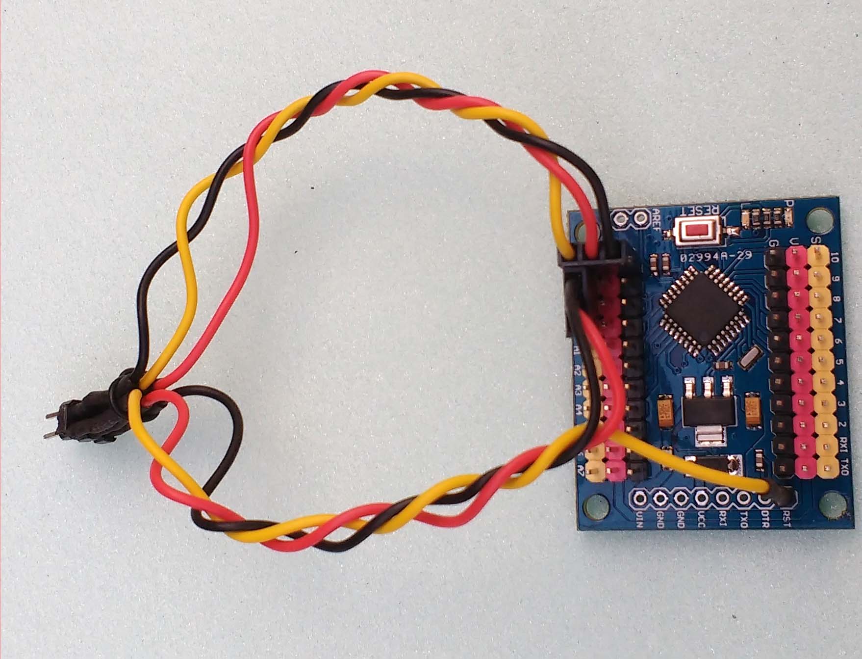

Just realised Jay I dont think you mean the Pro Mini, I think you mean the old DIY-More and Deek-Robot boards?
They need a couple of servo plugs (actually they're sockets in engineer-speak but we'll not get into that right now...) and a 6-pin header plug (as supplied with Nanos). In the IDE the board names are just a short-cut to a particular processor type, variant & clockspeed so choosing Nano, Promini, etc all works fine for these boards, its exactly like manually selecting 328P at 16mhz.

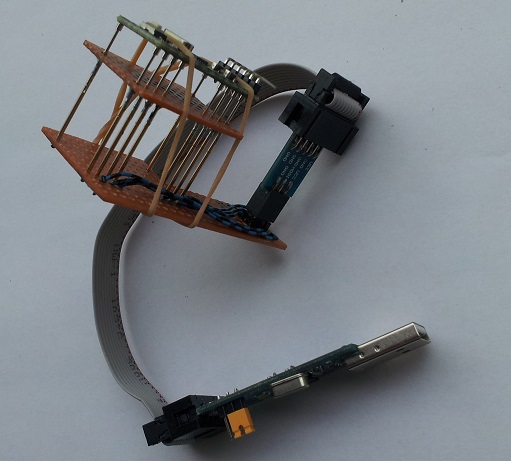

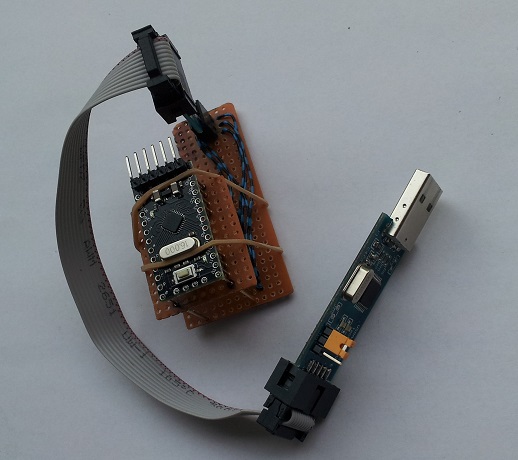

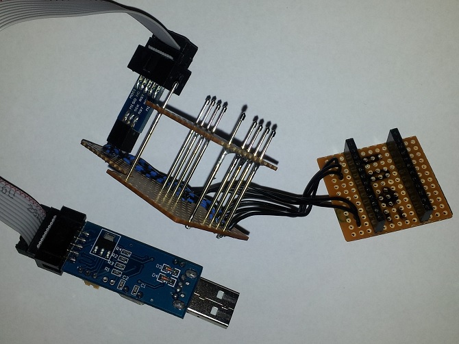

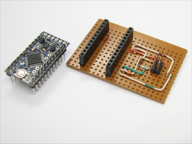

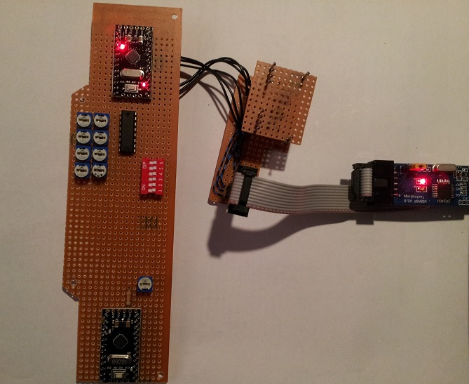

Some time ago, I took Phil's example and made a similar one for programming Pro Minis, but without their headers.
Sometimes one wants just the board with wires attached....
10 'Sparkfun 'Pogo pins' do the job. 6 for programming, 4 extra, just stabilizing the board.
A rubber band holds the board while programming.
Later on, deciding I'd like to do in circuit programming too, I added the connector after all. :mrgreen:
After soldering the Pro Mini in the pcb, I'd leave the headers full length and plug the connector from below....

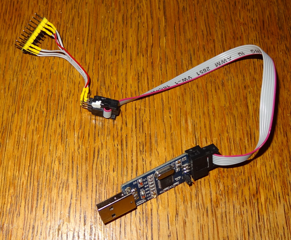

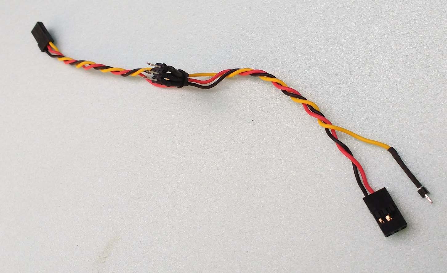

Here's a photo of the ridiculously basic programmer I use for my pro mini boards - it connects to the same 6 points on the board that Carl explained above.
I use this when the board hasn't even been fitted with pins or other connectors - I just shove the pins of the connector through the holes in the board and then apply a bit of finger pressure to angle the connector to one side so that the pins make a good electrical connection with the board's holes.
I use 'naked' boards like this on board planes to keep the weight and size as low as possible. I avoid the 6 'programming holes' for making connections to the receiver, servos or other items, so I can still use the programmer to modify the program after the Arduino has been wired up. Up till now I've also been able to avoid using the pins that fall between the two groups of three that the programmer connects to - but if I ever need to use those I can just pull the unused pins out of the programming connector.
Carl is right about not having to select the correct type of board when programming with a USBASP. Providing you select a board that uses a 328Mega (Uno, Nano, Pro Mini, ... the sketch will upload and run. It's best to select a board with the right crystal speed to match your actual board - otherwise all the timing signals done by delay(), millis(), micros() and so on will be wrong. The voltage itself doesn't matter - though the 3.3V ones tend to run at 8 MHz and the others at 16 MHz. The actual boards and the chips on them can all work at 5V - even if they are designated as 3.3V boards - but you have to be careful of any external devices that you've wired up to 3.3V boards as these might be damaged if you apply 5V.
