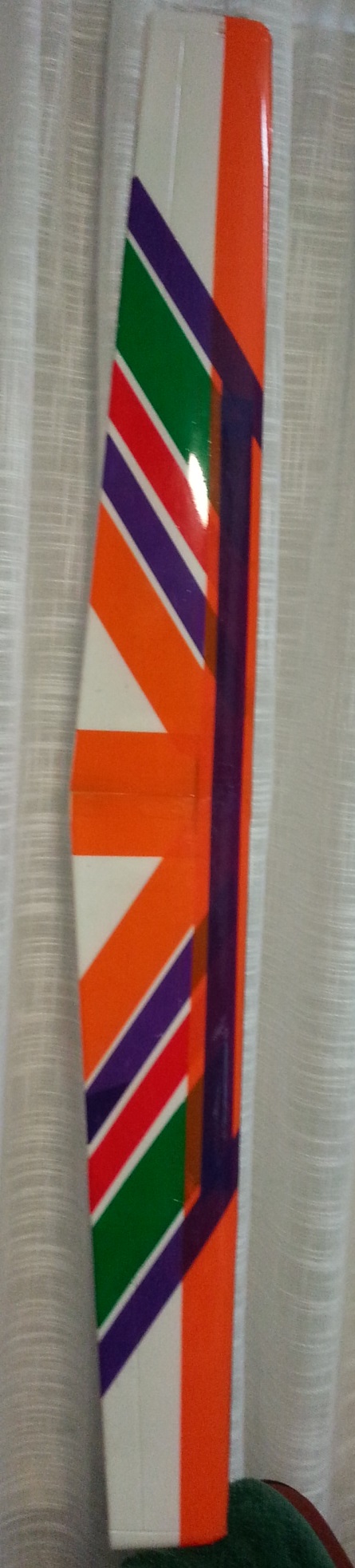

I've already got the wing, so its just the remaining bits (and the box of course ). It will more than likely be another 'foamy' (nice & quick )

Preliminaries:
wing - already in one piece - is a Union foam job, suitably reinforced. It is almost a direct replacement for the original, simple enough to convert to 2 pieces with a carbon rod joiner. The chosen motor - a 2212 6T (2200Kv) - should go well on only 2 cells, using a Graupner folding prop pinched off an old S400 combo. The nose will need to be enlarged "slightly" to accommodate.

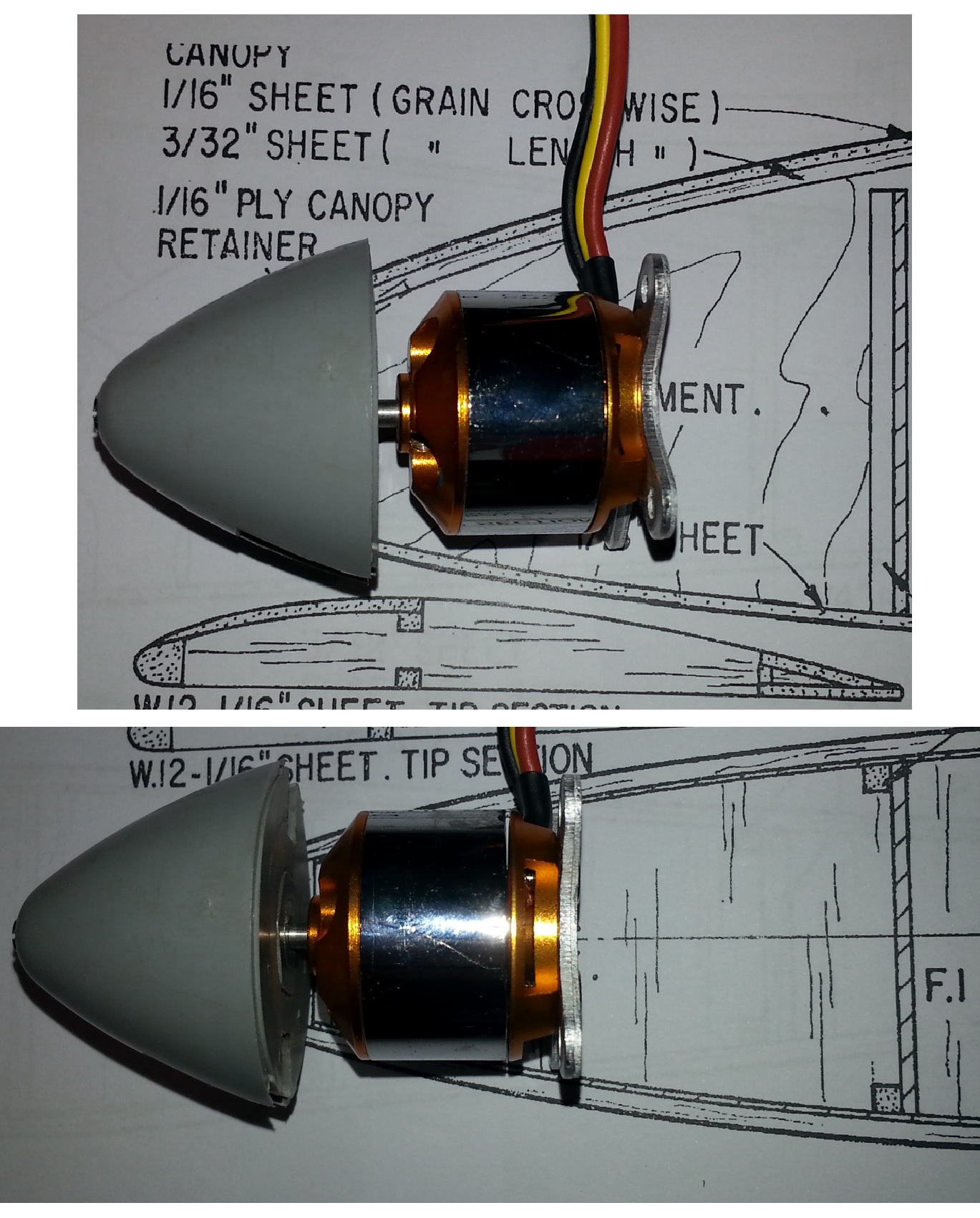

Managed to get a little time over the weekend to sort out the nose modifications:
All the bits have been printed out & glued onto cardboard for templates. The structure will be 2mm foam for the fuse (with strategic reinforcement) & the tailplane, while fin will be 4mm foam.
I bench ran the motor with a Graupner CAM 9" x 4.5" on 2 cells and there is plenty of thrust. I haven't done a current check yet but neither the 12A ESC or motor got even warm. Looking good so far!!
As you can see, the changes to the side profile are minimal/subtle, but the nose has had to be widened noticeably. I think it will still look like a Sigma in the air All the bits have been printed out & glued onto cardboard for templates. The structure will be 2mm foam for the fuse (with strategic reinforcement) & the tailplane, while fin will be 4mm foam.

Only limited progress to report:
1. Nose configuration & altered formers & fuselage drawing finalised
2. Templates made for all fuselage parts & tail surfaces
3. Sides & doublers cut out
4. Motor bench run with Graupner CAM 9" x 4.5" folding prop - 11 amps on a 2s pack. Should provide a 'brisk' climb
