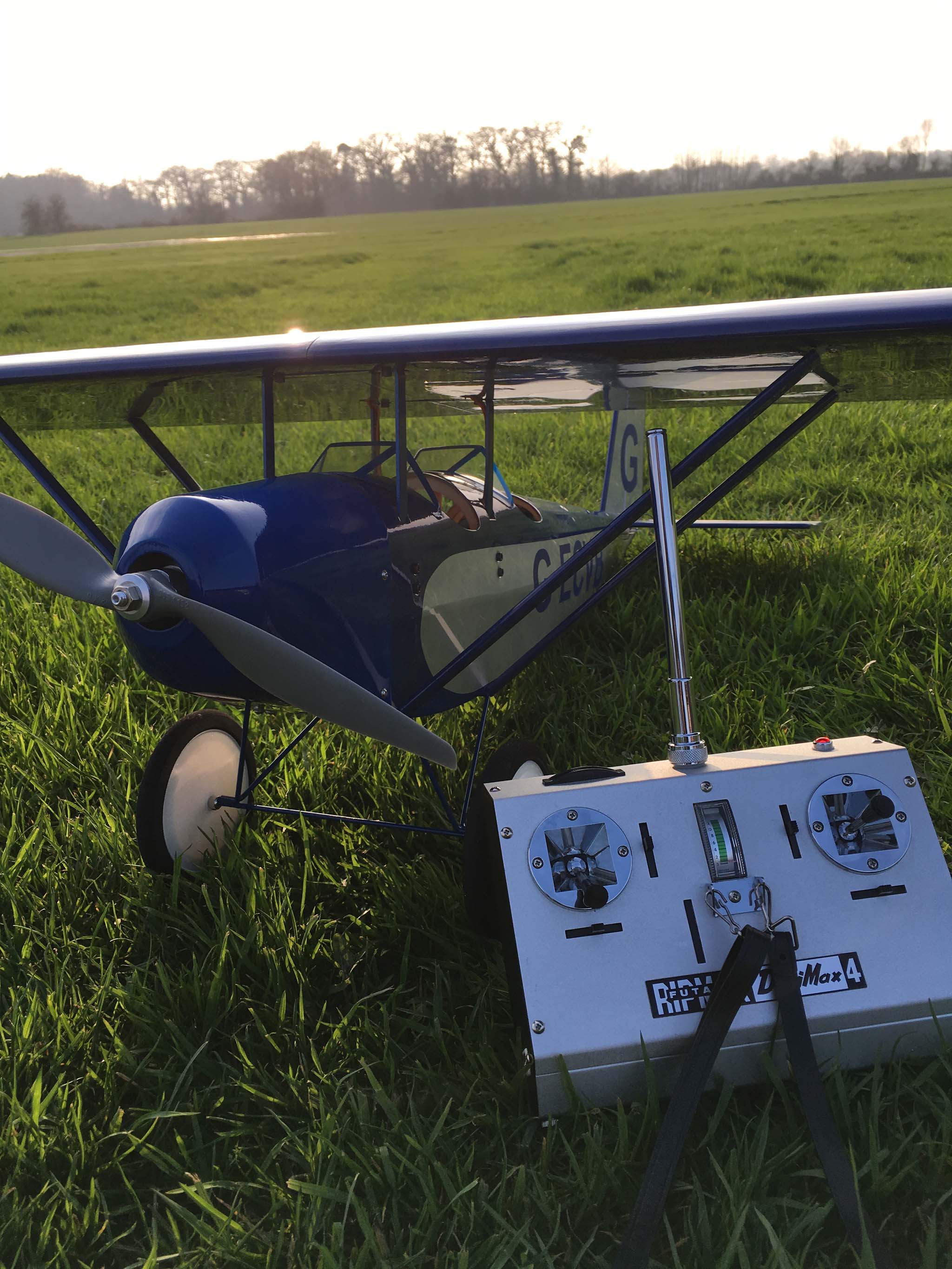

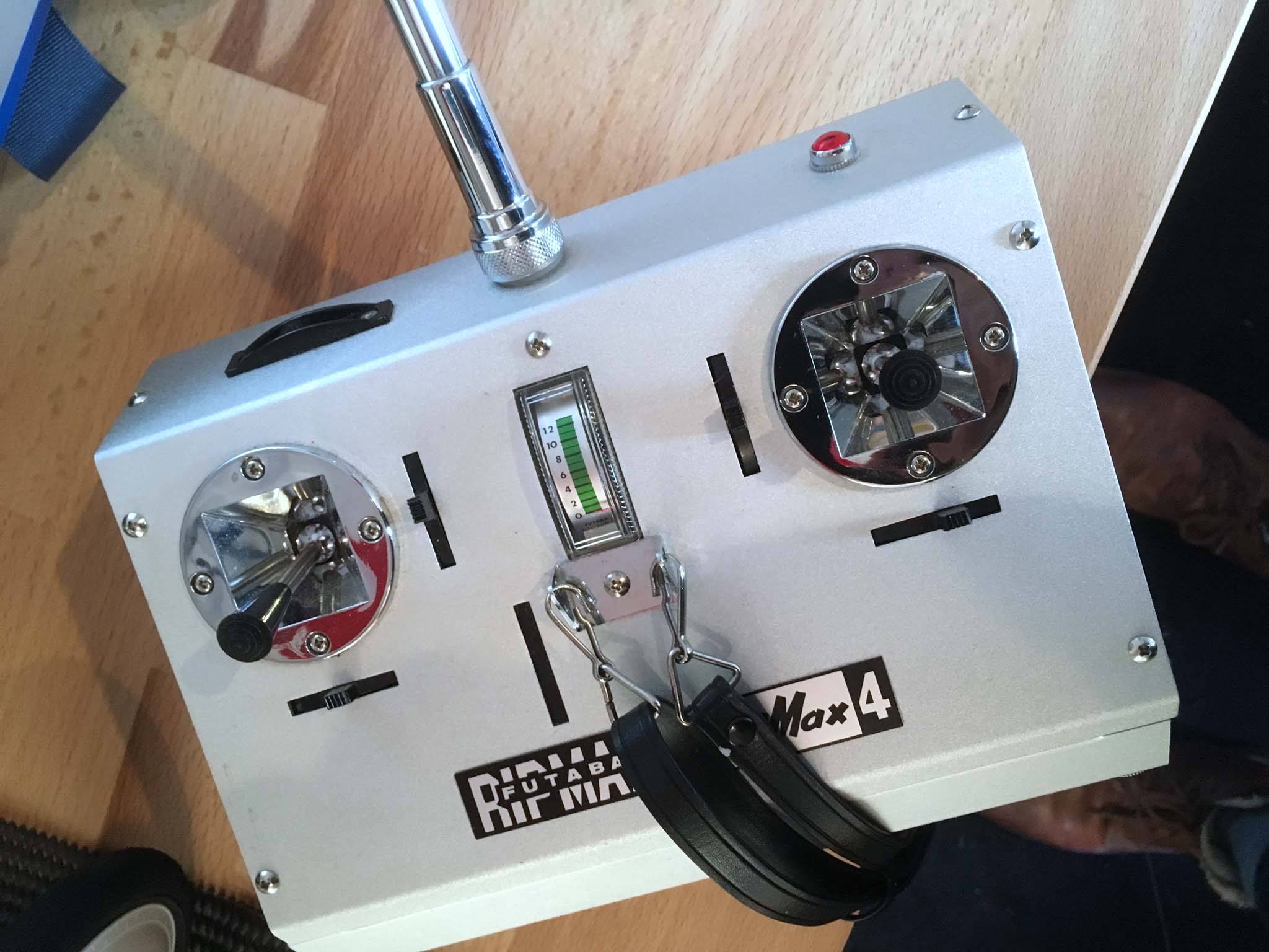

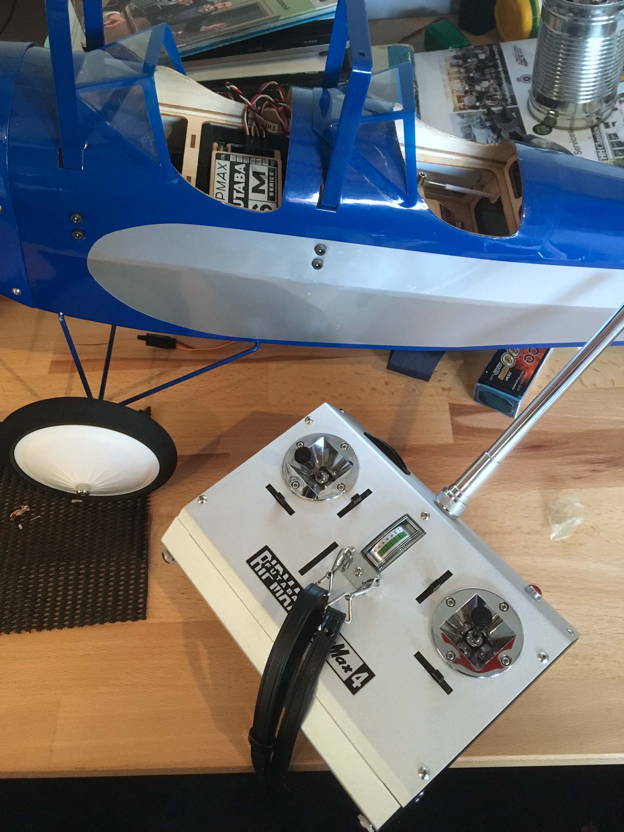

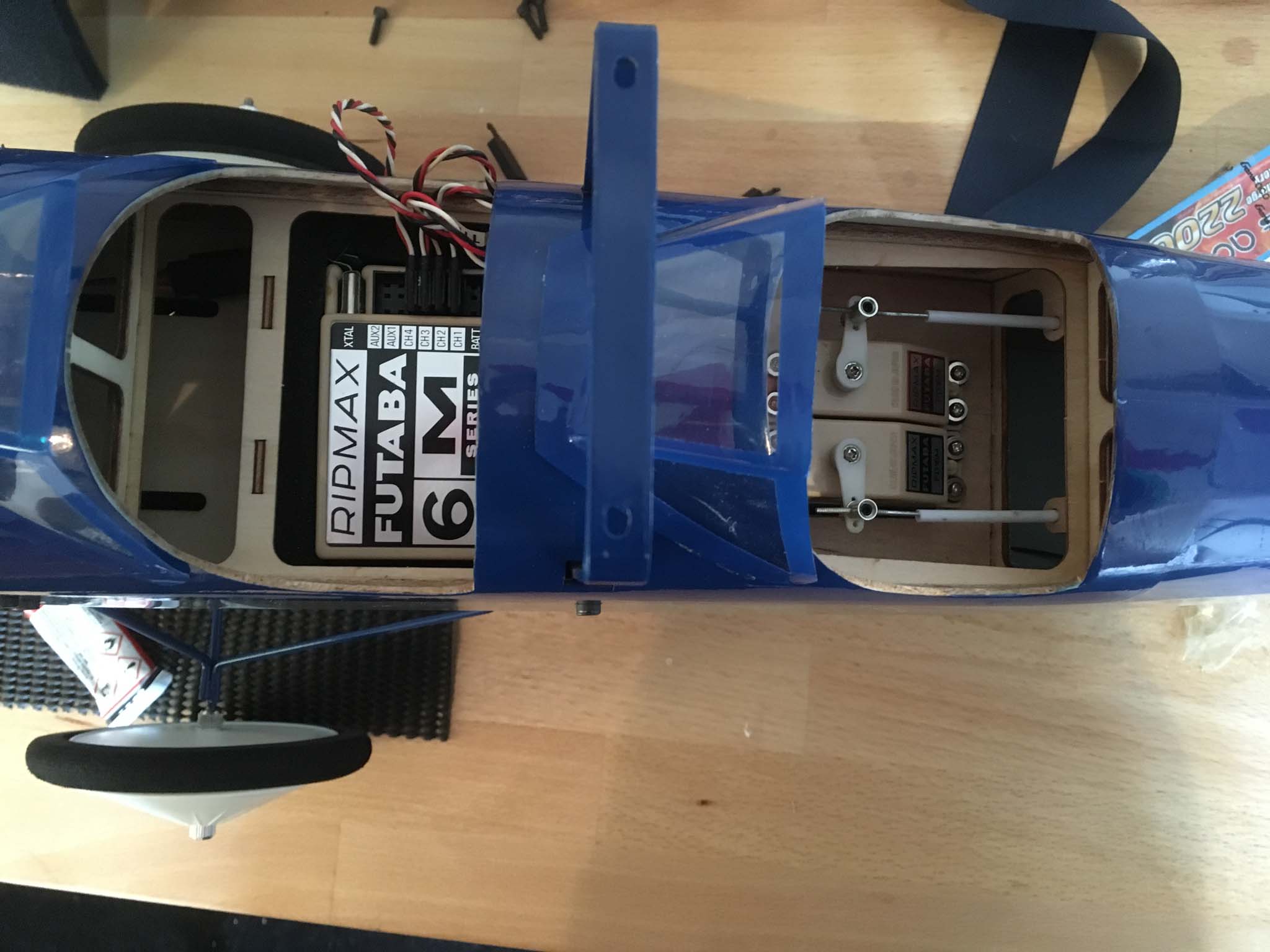

I was very lucky to win this outfit on eBay . It’s a beautiful set and another on as new condition. I’ve had to give it s light service and replace the old deac with new nicad cells. No black wire as it had deliberately been disconnected to avoid that. Final stages of fitting out a Pietenpol Aircamper with Futaba M series outfit airside. Will be flown 27mhz am as original

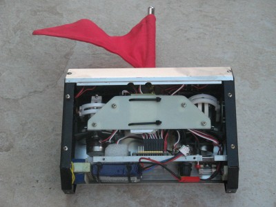

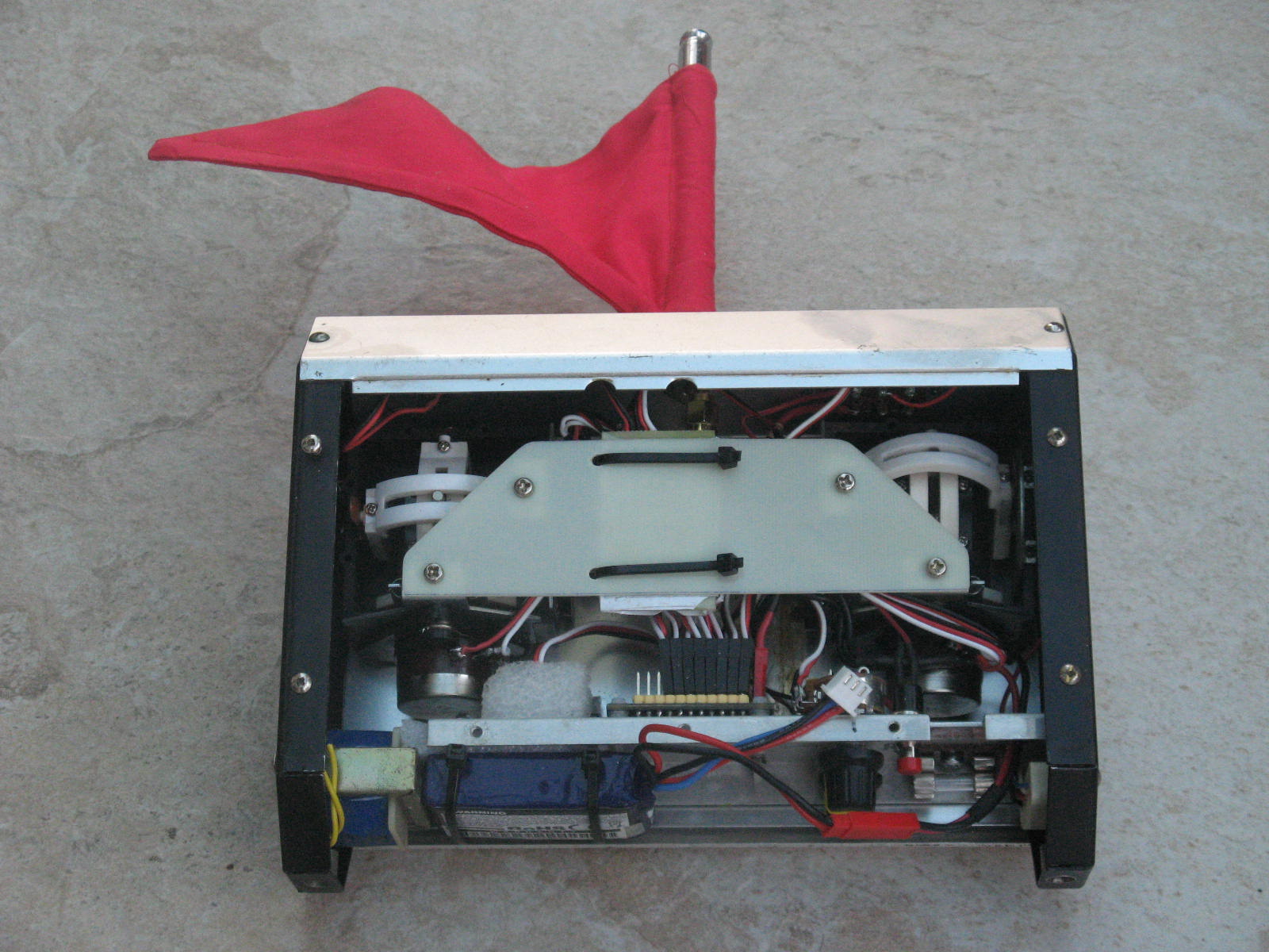

Yes, back in the day I always thought it was in a class of it's own but of course, could never have afforded one. It's a great subject for conversion, mine was a bit battered and I got it for (I think) £20 on ebay.. I did a "standard Phil Pro-mini" job on it but I wanted all the mod cons inside so it still looks like the original externally.
It was a bit of a squeeze but I put most of it on the old battery tray with the OrangeTx module mounted on a bridge between the two stick units. I left the original transformer in place to help with the balance when the pretend antenna is up!Paul

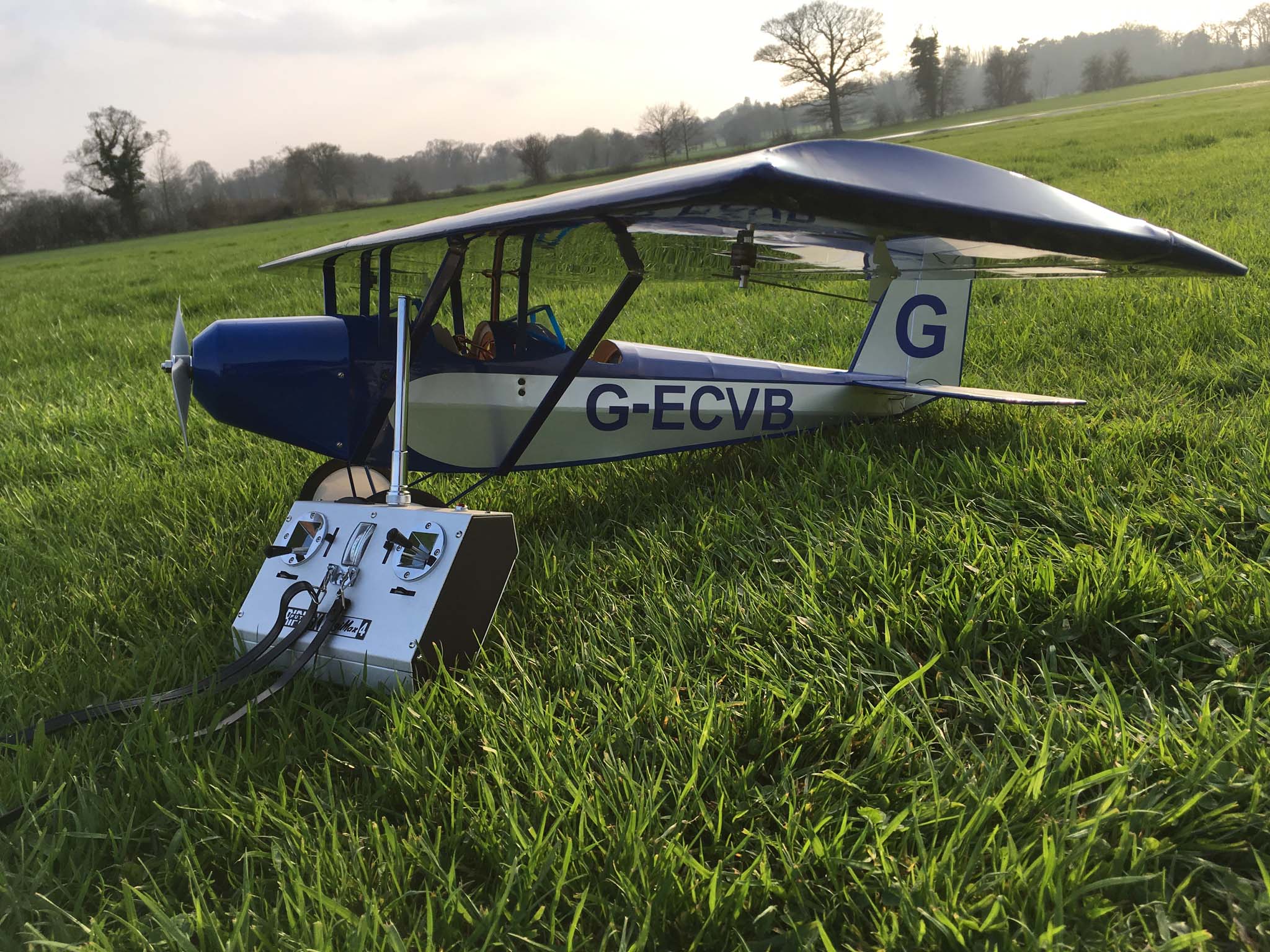

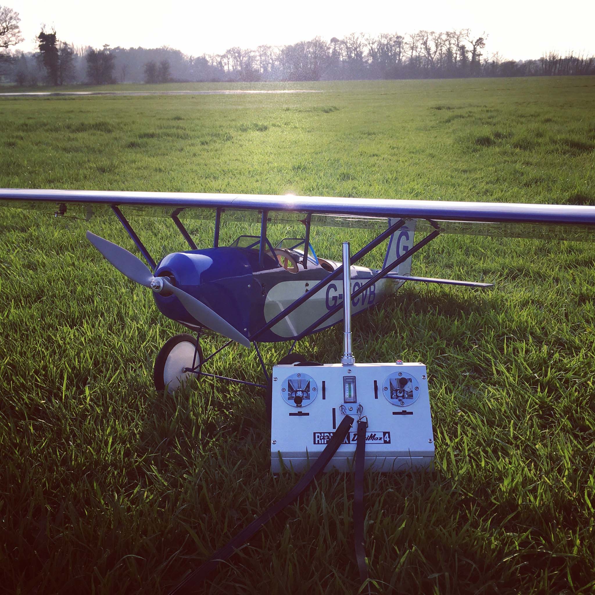

And she is up! A quiet moment between jobs and with not too much wind she took to the air for the first time. That massive wing got her off the ground within two feet and the engine is massively overpowered frankly. Definitely needs a lump of lead up front as if was a little precarious but I can see the underlying characteristics are stable and passive. Going to be a great stooger! The Digimax worked really well. Range tested initially then up in the air. One glitch when plane end on to the tx aerial. Apart from that perfect and a good very slow landing too . Still 27mhz AM on green
