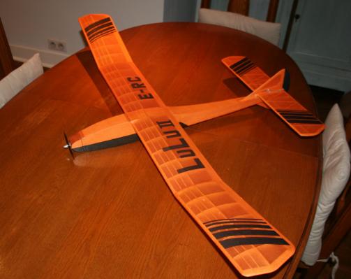

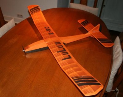

Very sad to read of John Barker's passing. He was a friend and club mate of mine in the BATS club throughout the eighties and nineties. We lost touch when I moved to France until I built an electric powered RET Lulu for one of the RCGroup build offs and he spotted it and posted a comment on the Hip Pocket forum. I still have the Lulu and it gets flown a lot as it is a super little fun soarer and a great example of the KISS principle that just because something is simple doesn't mean it isn't good. These days I enjoy launching and flying the Lulu from the comfort of a garden chair usually ending the flight either at my feet or by catching it, much to the amusement of my French friends, next time I am winding it away in a nice little thermal I will think of John with gratitude, RIP John.

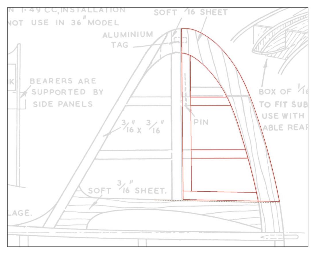

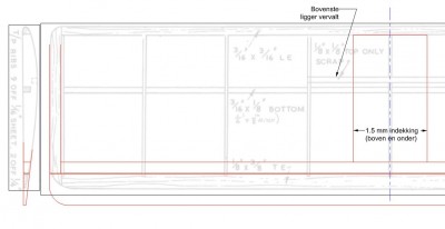

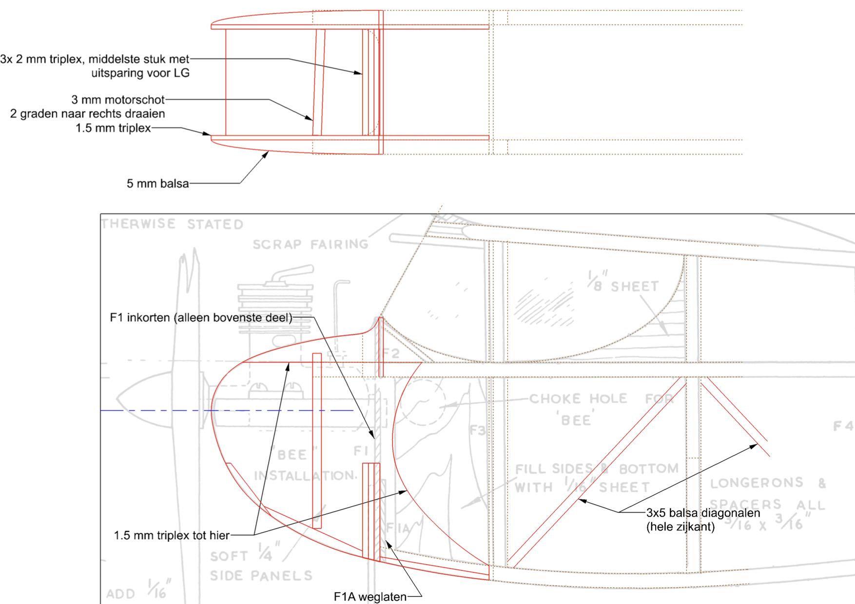

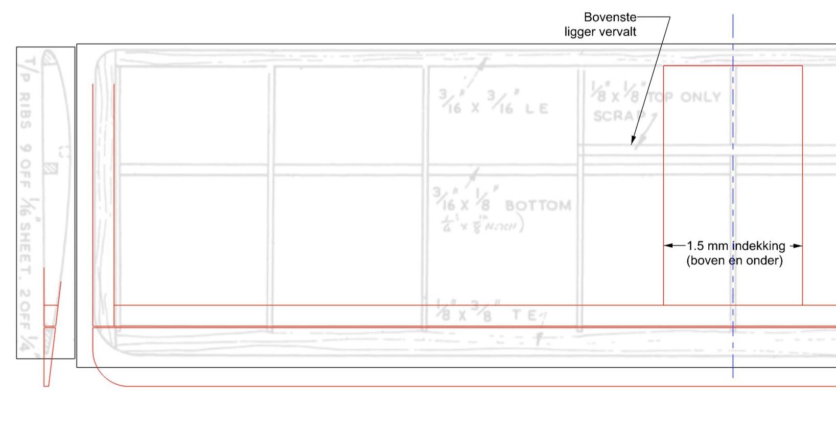

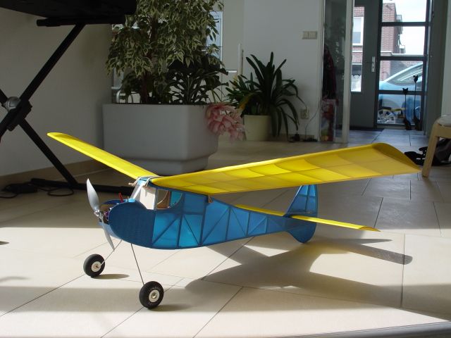

As this seems to be a general Tomboy topic, I'll post some pictures of mine, including the mods I made for the conversion of the original design to RC (rudder-elevator-throttle). You will note that the text in the pictures is in Dutch, but that should not be a big problem I guess. "Triplex" is plywood in English.
I have added the pdf versions here:
Tomboy_neus_mods.pdf
(904.07 KiB) Downloaded 185 times
Tomboy_staart_mods.pdf
(755.22 KiB) Downloaded 201 times
Tomboy_stabilo_mods.pdf
(926.6 KiB) Downloaded 197 times
The battery is standing upright (2s-0.95Ah), directly behind the firewall, just in front of the windscreen. The esc sits in the space below the windscreen, and can be pushed in there through the battery compartment since F1 is partly open.
I made a pocket for the landing gear with three layers of 2 mm plywood. The L/G itself is made from 2 mm piano wire, bent in an inverted U shape at the top, and sprung in place.
It is a brilliant little flyer.
Max.
(Edit: revised the landing gear wire and mounting ply to 2 mm thick)
