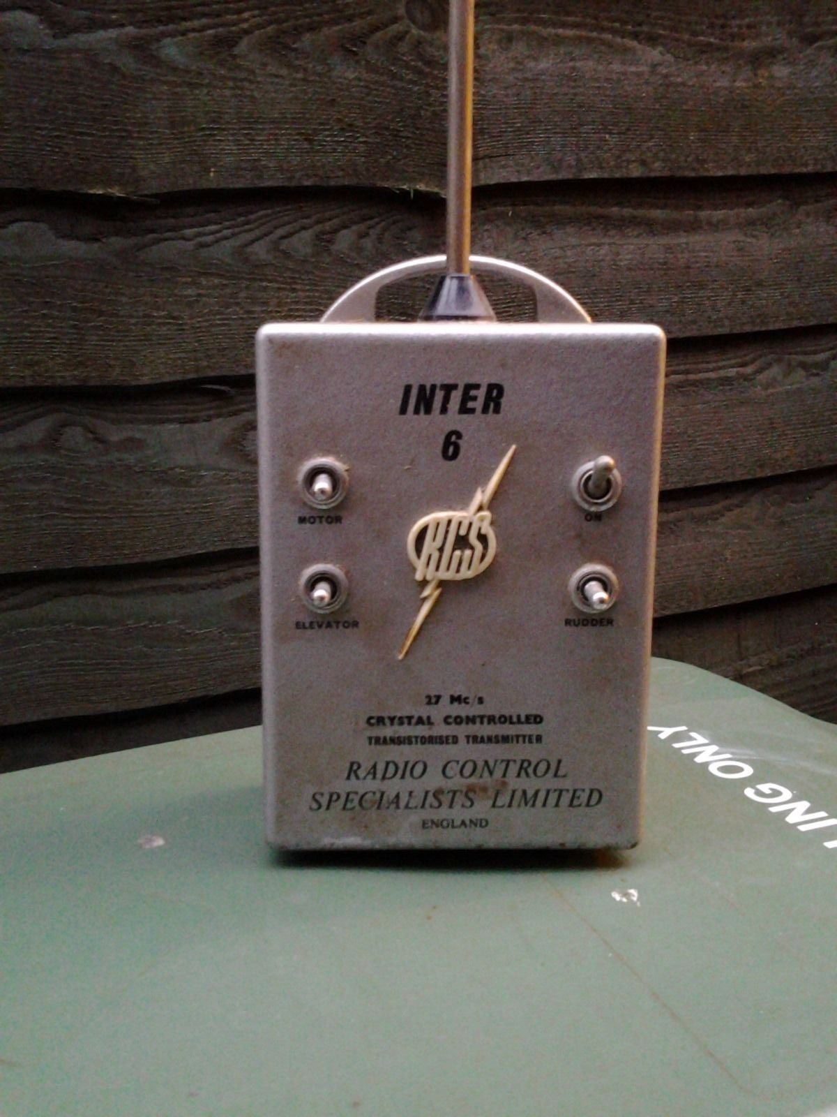

Shaun tipped me off to a nice RCS Inter-6 on ebay recently, I've been after a genuine period 6ch reeds transmitter for a while as the only Tiny-6 I have is my original prototype in its Maplin box. Heres the ebay photo of the RCS as it was auctioned:
It needed a good scrub up and there is some light corrosion, but at least the irreplaceable RCS logo was intact!

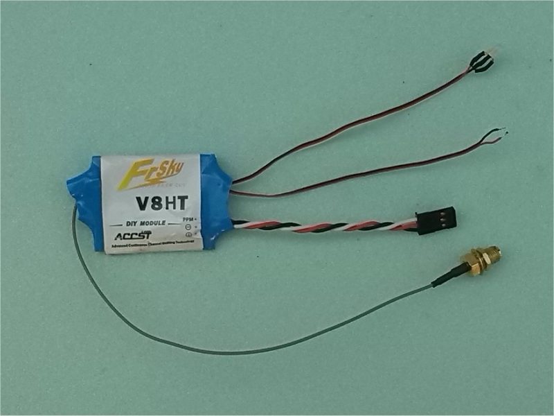

The module is a Frsky V8HT which was kindly donated by Alex who has mostly reverted to 35mhz - thanks Alex!

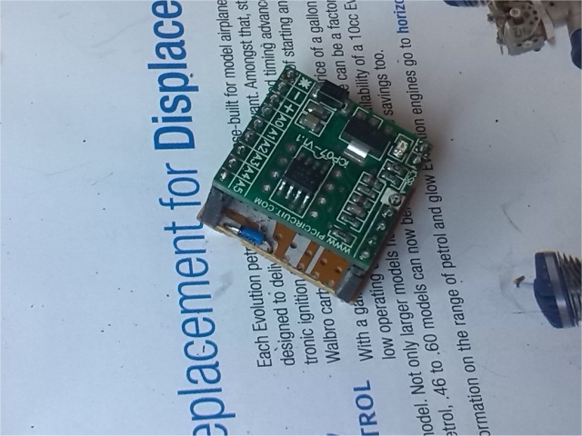

The encoder is a standard Tiny-6, in Futaba channel order (AETR). It gives 6 emulated tri-simul reeds channels (3 function), with trim on all channels, servo reversing, choice of two servo-slow speeds and a range check sweep mode:

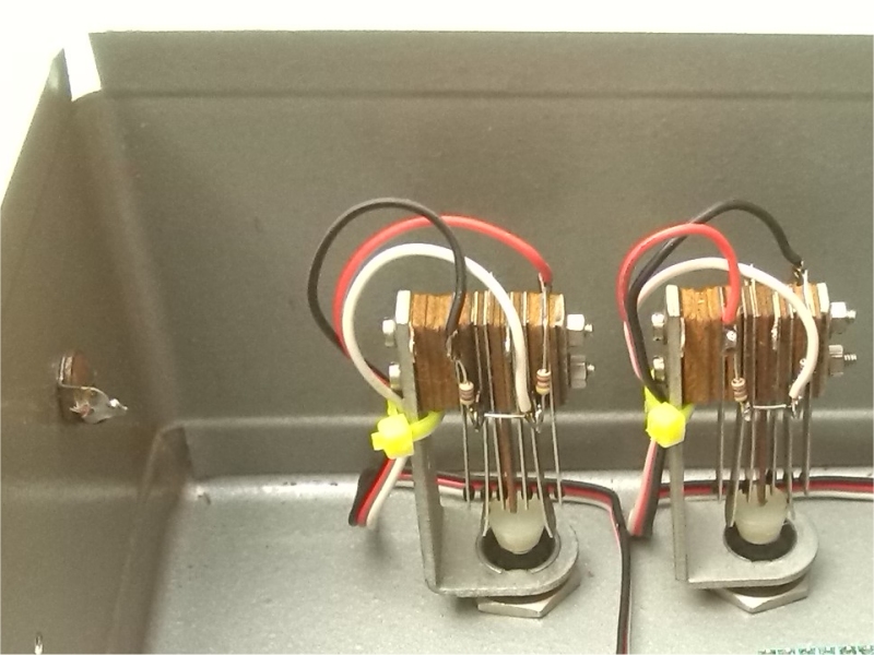

First job is to clean the old lever contacts, attach the biasing resistors, and wire up the toggles:

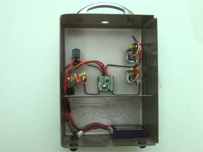

At this stage, before connecting the RF module, I add the battery and make sure everything works so far, that we get good ppm and the buzzer is working:
(this is where you realise why we call this the Tiny 6 encoder!

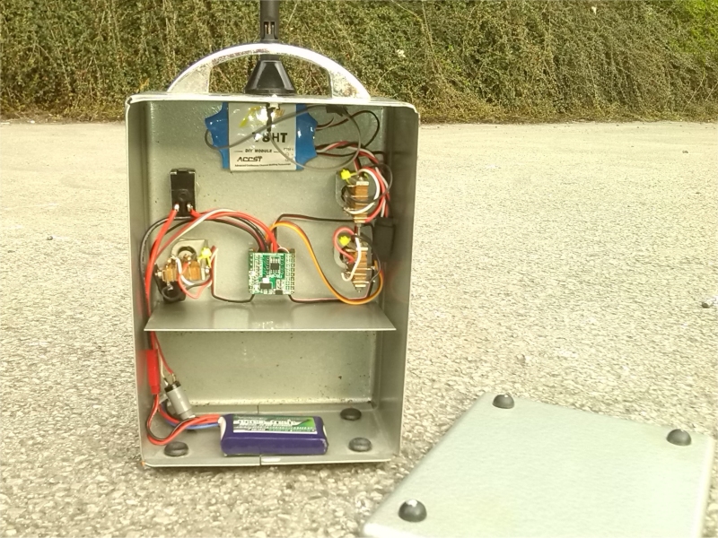

With everything working as expected, the Frsky V8HT module was mounted at the top of the front panel, with the LED discretely under the handle:
Not the tidiest of conversions, maybe I should have let Ron do it for me :D :D :D
I really, really wanted to make this a pristine installation, a showpiece I'd be happy to publish - unfortunately it seems I just don't have the presentation skills some of you lot have and despite my best efforts I'd hardly call it tidy. It works!
Eagle-eyes will notice that I've not mounted the trim button yet - its a temporary one, I've ordered a much smaller 4mm one which will be easier to hide.

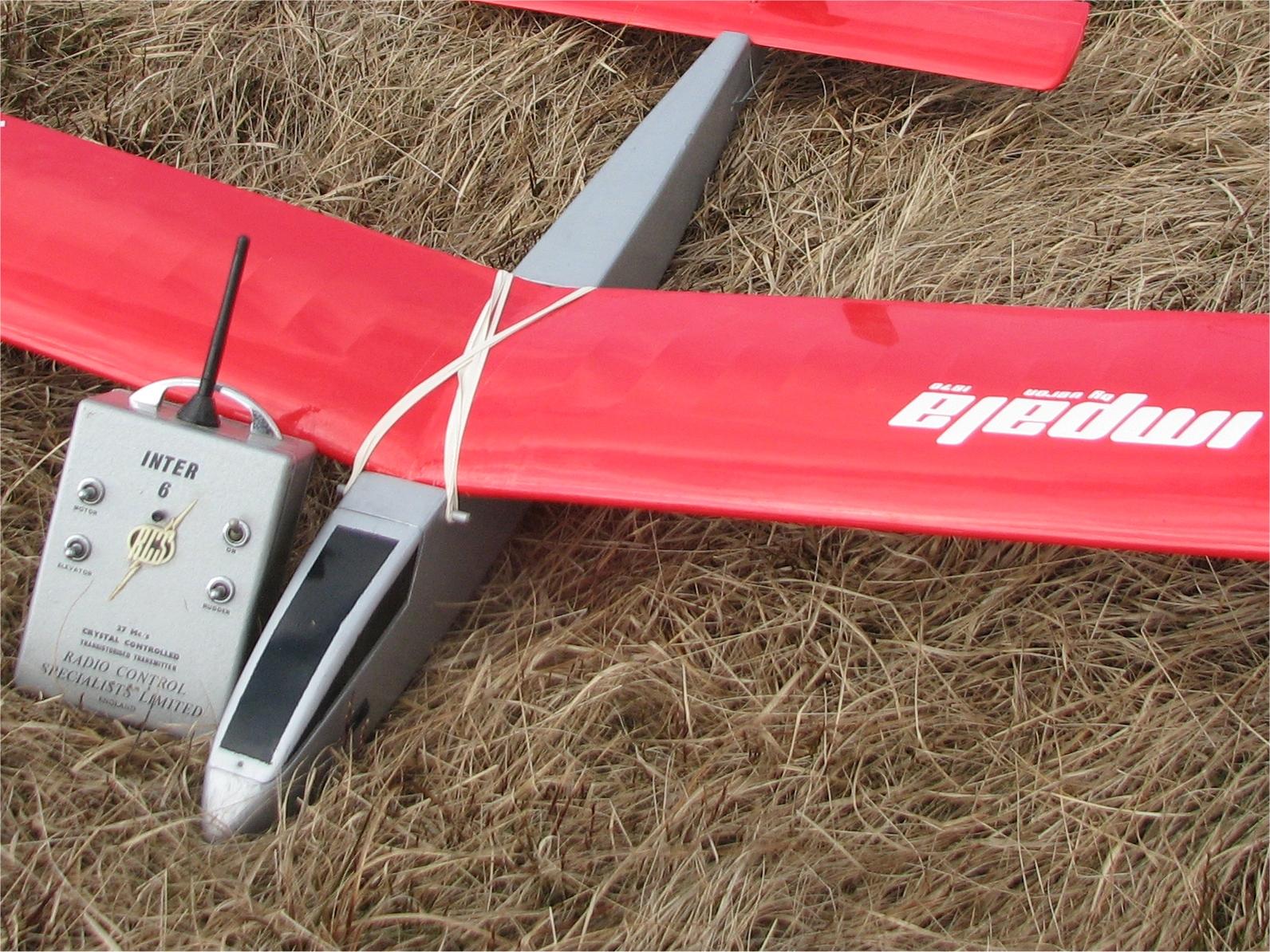

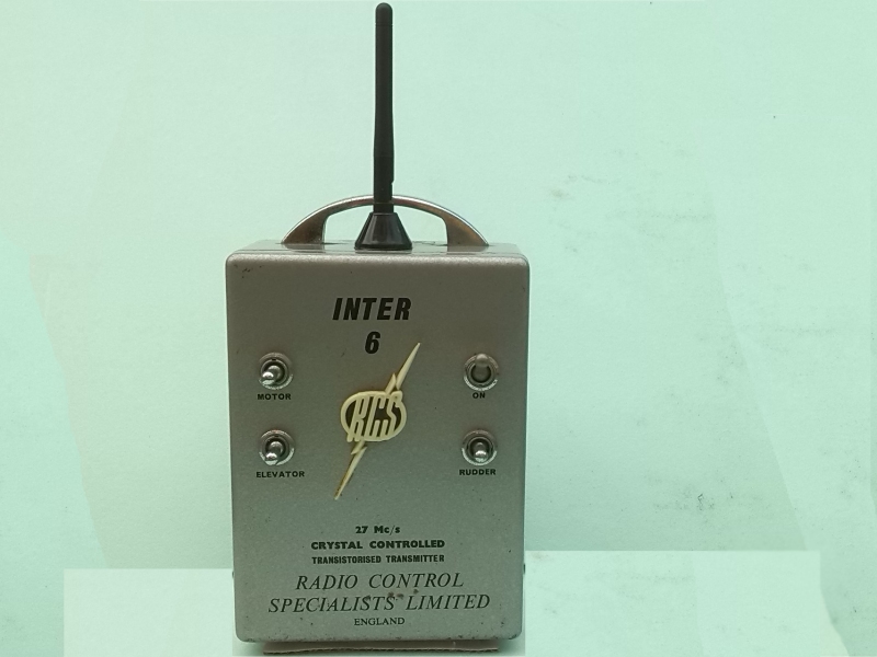

And here's the finished transmitter, working better than new and good to go when the wind stops blowing!
And heres the RCS with my trusty Impala at Callow. Just above the RCS logo you can see the discrete
'trim' button:
