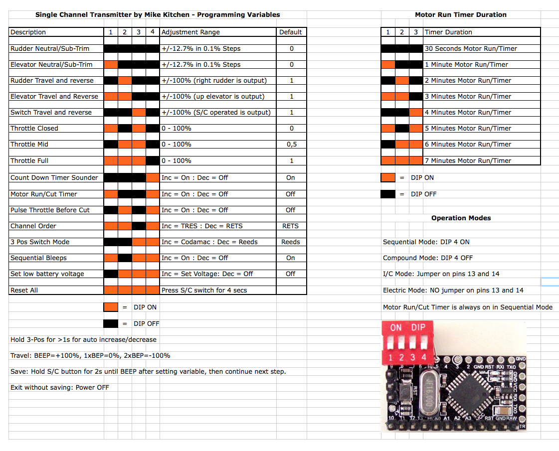

Thanks again Mike for your explanation. I had missed the fact that there is no throttle control in Sequential, other than by means of the timer.
The reason why I am having this kind of questions now is that I have installed the DIP switches in a way that is convenient to me, and I wanted to change your settings table so the columns matched the switch numbers (basically just mirror them, but maintaining the column number = Config variable number relation with the code).
In doing so, my excel sheet has been growing into a kind of shorthand manual, so these kind of questions come up now and then.
As you can see, I still missing the beeper, reason why it is difficult to completely test all features. I guess I could hook it up to Phil's pulse analyser that I built recently.....
Max.

Hi Max
Phil will be smiling as he suggested that I change the header order, just like you have it. OK Phil, you were right and I was wrong :lol:

Hi Mike,
Well I guess you can argue about that, but the basic cause is that we write binary numbers from right to left with the lowest bit on the right (and decimal numbers too for that matter), and common text from left to right, including series like 1,2,3. :shock: :D
And another thing you could argue about is your use of "1"'s and "0"'s in the table, while in fact placing a jumber connects that input to 0V, so in fact a "1" is a logic 0 :? ;) :P

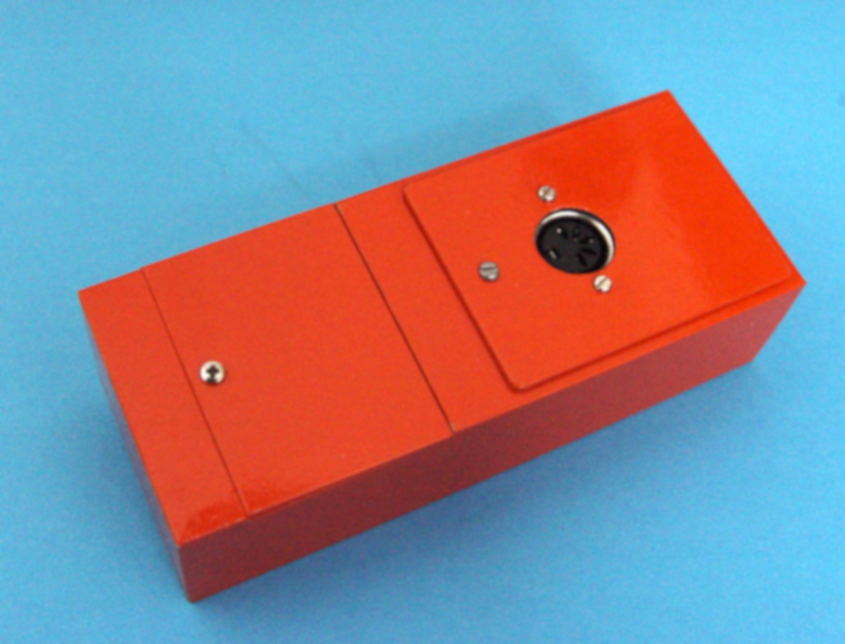

I made a socket for a teacher-student connection to my regular proportional set, as an interchangeable unit to replace the 2,4 gHz module, so I will have a backup when things go pear shaped during practise. :o
Max.
Re: Yet another Single Channel Encoder
Another brilliant idea Max,
How do you manage to make those holes so neat especially covering them with solorfilm?
