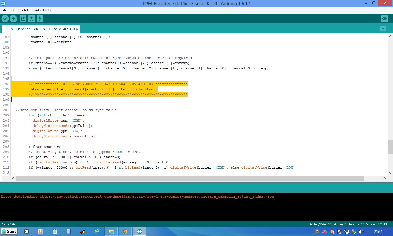

Re: Need help moving a channel on the 7ch encoder w/ S/C
Not tried it but this should do it Jay.
Remember the channel array starts at zero so channel[0] in the array is throttle (rx ch1),
channel[1] in the array is aileron (rx ch2), channel[2] in the array is elevator (rx ch3) etc etc
so channel[4] in the array is rx channel 5 (gear, ie the 'slow' toggle) and then channel[5] and
channel[6] in the array are the two 'aux' channels on rx ch6 & ch7.
Thanks Phil,
I like your idea for Spektrum, as most of us here in California and around the USA use it alot.
I assume I must cut and paste the yellow highlighted text in the sketch you posted above into your existing sketch, correct?
