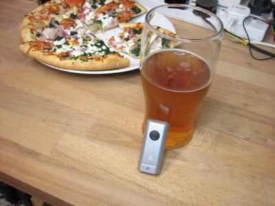

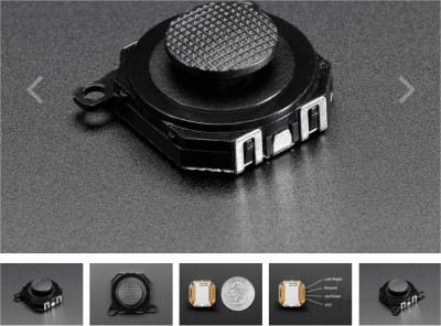

It has all the facilities too, reversing, minute-minder, inactivity alarm, mixers including the S/C mix, etc... but not wired! and its FHSS of course the 'stick' is a proportional 2-axis unit from a PSP or whatever,
it has poor centring so its programmed with a narrow 'dead band' at neutral. The on/off switch is one segment of a DIPswitch. You've probably guessed whats inside!

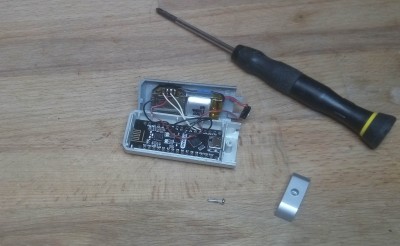

Brilliant Phil! ...... Can we see the insides? Where is the antenna?

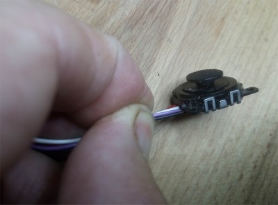

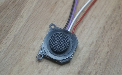

It uses a proportional micro-stick unit, used I think some pocket games. It doesnt centre that well so is programmed with a narrow 'deadband' which is not noticable in use but gives accurate centring:
Inside its quite cramped, most of the 'stick' is inside the case and next to it is a 100mAh lipo cell.
Mounted in the other case half is of course (you guessed!) a Keywish RF-Nano:

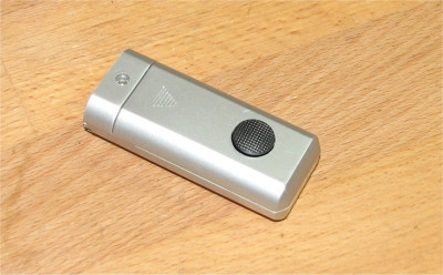

The case is made from half a Poundland LED pocket radio/torch, the two-AAA's battery-holder part:

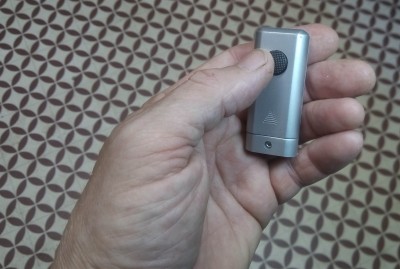

The stick does look more lieka button but it is actually proportional and runs the same FHSS code so is compatible with all the other stuff Not yet flown - but I will, with the ease of swapping in-flight it would be rude not to...
[Edit: Flown (briefly!) in the Lidl glider at Baildon!]
