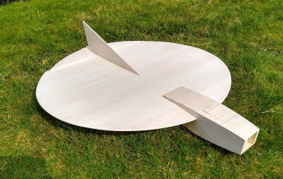

Here's my lockdown project. Completely Arduino
free.
Built yesterday after I decided to redesign an old s/c model by simplifying it, electrifying it and especially for Phil adding elevons
..The original had 1/8th inch ply fus doublers and a 1/8" ply fus floor at the front. It was more like a flying rounders bat. At under 2lbs and 400 watts it should be interesting.
Plan will be in mag soon.
Anybody know what it is?

A waste of good balsa?
- Posts: 1232
Re: Phil's lockdown project - a 4ch propo NRF24 set
It's for people who don't like building wings. At 26" diameter it would make a hell of a table tennis bat.
